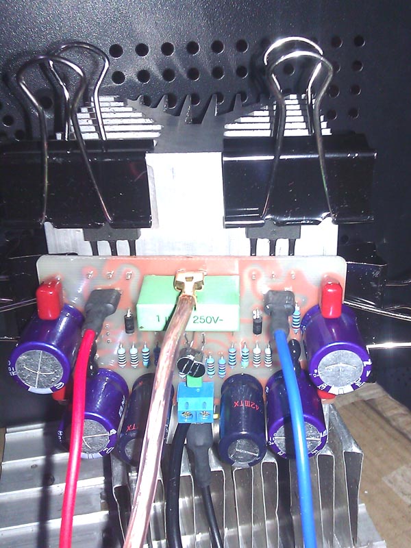

Hi PMI,
what about if you do like I do, put your parts as post #1(no caps at B-C VAS transistor & only 4 big elcos) & see what will happen on your scope 🙄
We need,
1. A digital multimeter.
2. 1R/1W x 2.
3. 22R/2W x 2.
For first time power-up solder two 22R/2W resistor to the PS rails, one end of each of them to each rail. Connect the PS to the open ends and turn on power. If nothing explodes/smokes then replace both of the 22R with 1R/1W and connect the PS again, but don't power it up instantly.
Take notes for the measurements from now on.
Set your digital meter to 'mV' and connect the probes to both ends of one of the 1R resistors. Turn on power. Check meter reading. That number shows total Quiscent current Iq.
Measure the front end plus VAS current I(f v) by probing the voltage at the ends of the 10R after the 4007 diodes.

Hi Shaan, thanks & I did it safely 🙂
here the result with +/-30v :
@ 22R = about 2volt & it is okay so
I change to 1R (the current quite low nothing warm)
@ 1R = 140mV (155mV) --->140mV on CH1 & 155mV on CH2
@ 10R (f v) = 99mV (89mV)
@ 10R (vas) = 63mV (56mV)
DC offset = 6mV (1mV)
When I test it input shorted to ground, not use caps at VAS transistors & no zobel at output only 8.2R resistor as load because without load I can't measure DC offset.

..................... at output only 8.2R resistor as load because without load I can't measure DC offset............../
This makes no sense.
DC offset at the output is measured with shorted input and open output.
You can specify a specific Rs, say 100r or 1000r, and state the output offset for this condition, but this is non standard and needs to be specified fully for us to understand.
What I mean is without any load at output DC offset not stable,
maybe oscillation that what I got there, that's why ask here.
At no load at output or open output my DMM can't read the DC offset...
With one 8R2 resistor at output my DMM reading 6mV and 1mV.

High or unstable offset without load isn't normal and indicates oscillation; most probably in the FETs. Replace 100R gate stoppers with 330R or 470R and see if it helps. All the best.
@John Bali:Thanks for the tip, but.... naaah, I'll skip that test 😀.
I tested my boards without zobel installed, with 44pF compensation caps, and with the six elcos as shown in the pics. Even with the 44 pF, I measured a maximum slew rate of around 100V/usec. Plenty for me, and I will try 22pF when I compare to the boards from the VSSA GB.
I got some clue 😉 have some 22-33-47 pF for compensation caps,
I will wait when that comparison is 😀
What does the meter show then? The number '1' on the left sidd of the screen? If so, then try setting the range to 'volts' instead of 'millivolts' and see if it shows some reading.
Yes, 1. after change to range volts it is can read some voltage & not stable.
So I will try to change gate stopper resistor
btw this is my first time using FET OPS 🙂
Now it is warm 🙂
Today I add zobel & let it warm...
Stable 1 mV when cold max 4 mV when warm (when I pause the music),
it more than an hours now

Hi Pete,
try without that caps & only with zobel ...
nice, Bli John...
mine only with zobel + output inductor and it stable, no comp. cap (offset in range of 0.1 - 0.4 mv difference)
I am very careless... shorted 10 ohm series with diode & sparks 😀
but I am lucky only changed that 10 ohm & everything just better...
Hmmm, interesting. So, the conclusion would be that all you need is the small cap in the Zobel for stability... (?)
I'm not sure, but because of the little accident I remove the zobel & put on the compensation caps
I use 33pF.
Also I put more parts
Now it is stable at 1mV without zobel...
@Naf try to install compensation caps & see if yours is more stable with it, no need zobel or inductor

Hi Shaan,
I'm re-read again and found my total current is around 200mA
(200mV on 1R resistor you suggest)
I Vas 16mA
Fet Current almost 180mA with that 470 ohm resistor
Rail is +/- 33VDC before 1R safety resistor
This is normal right, one more question do you put zobel on output?

Absolutely normal. Perfect bias. :up:
One more question, do you put zobel on output?
If yes is that 100nF + 10R?
My peeceebee has no Zobel and no Compensation. But 2K2/100R feedback node setup and medium gain BJTs for input and VAS. I think these together do the trick. It's a pair of stable, offset steady(with or without load), high bandwidth, transparent sounding(you may say 'ethereal' sounding) amplifiers. My holy grail. I can die now.
Okay ignore my fanboy words. Yes the standard values for a zobel is 100nF + 10R. However, certain applications might require different values, e.g. the LM1875 chipamp needs 220nF + 1R.
