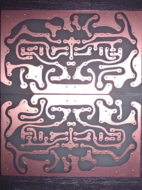

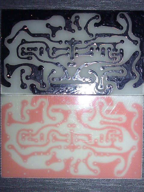

Hand Made PeeCeeBee

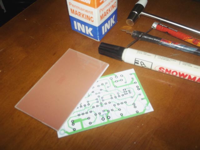

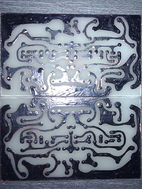

Finally I have a pair of PeeCeeBee 😎 even not finnish yet hehehe 😀
Beautyful job. Now just increase the thickness of the power and output traces and etch it ASAP! 🙂
Hi Shaan & everybodyBuild two 😉 , get blown away and be proud of your PeeCeeBee, like us.
Satisfaction, gurranteed! 😀

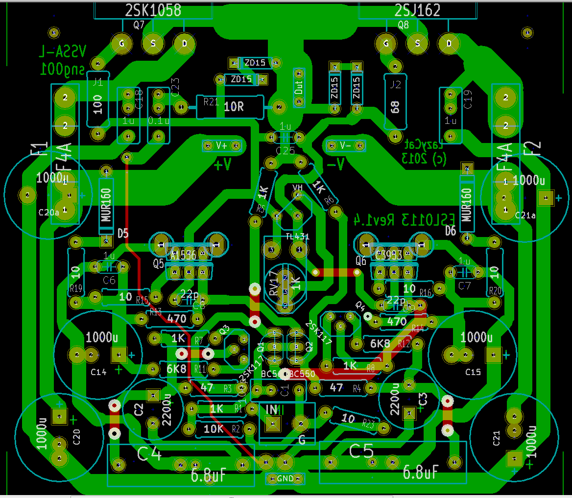

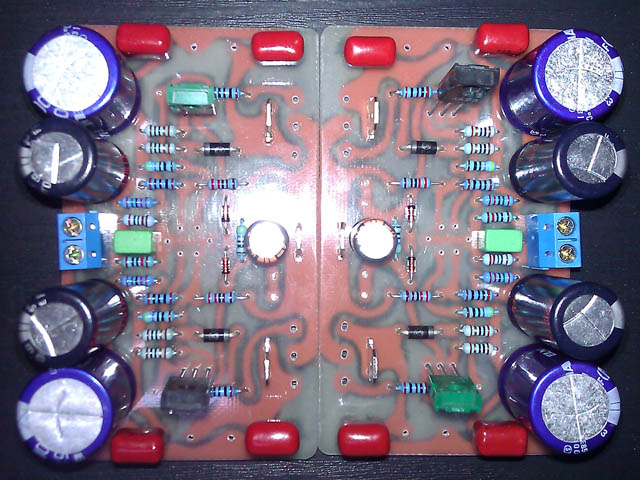

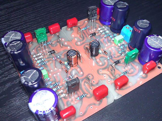

My take of the PeeCeeBee Rev 1.4
I want to retrofit an AV amp with a pair of VSSA PeeCeeBee and I made the following PCB with thru-hole components. It is based on LazyCat Rev 1.4 with shunt regulator and JFET current source. I have made one channel & it is singing 😀

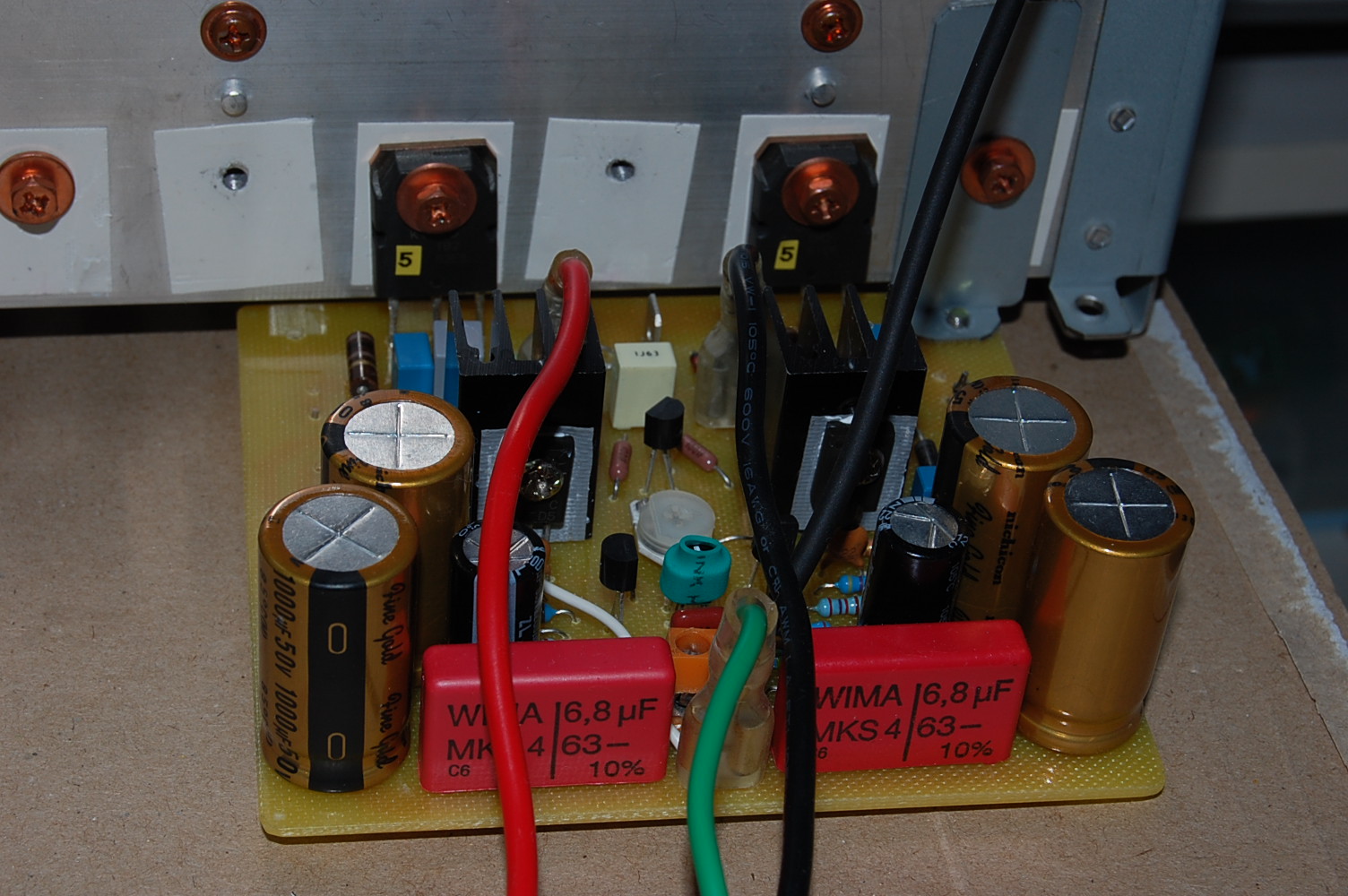

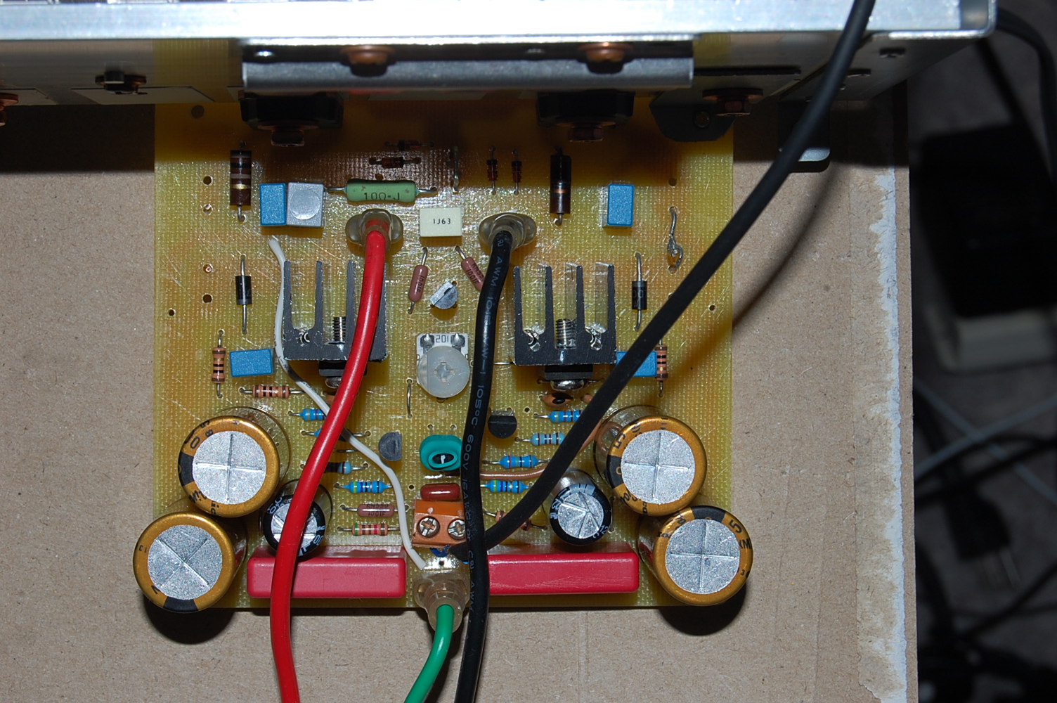

TeeOhThree PeeCeeBee Reference Post

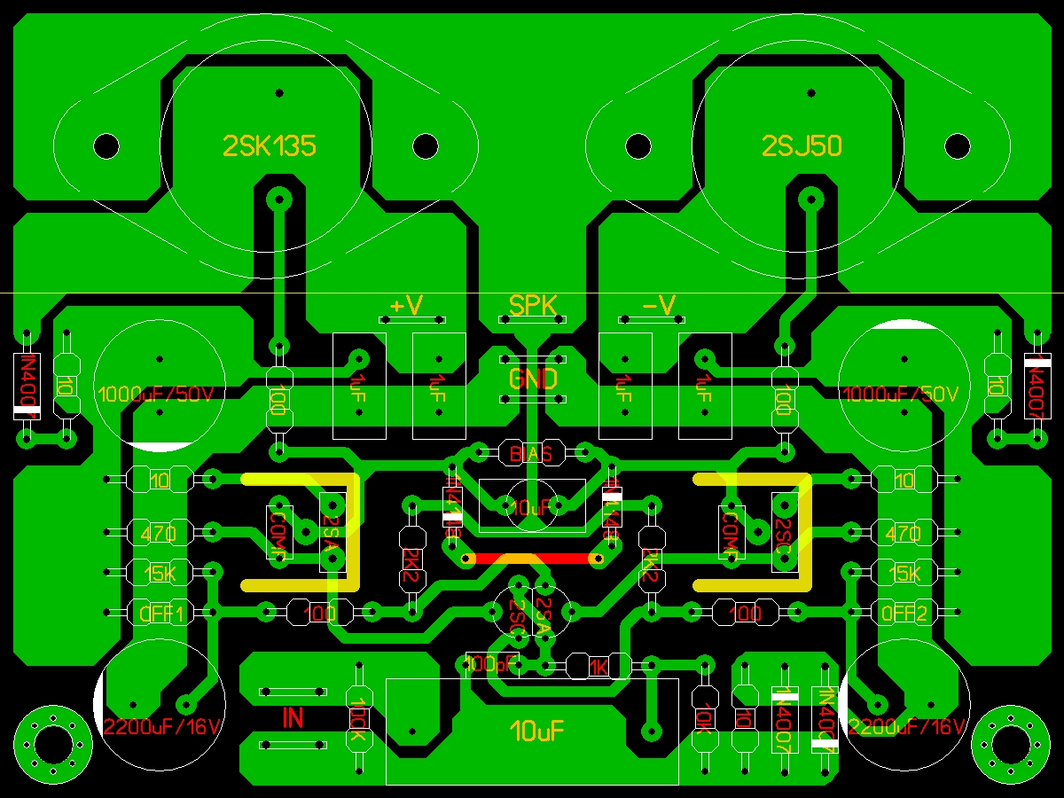

OK, here is my reference post regarding the PeeCeeBee for TO-3 output devices.
My board is 4" x 3" (101.6mm x 76.2mm). Offset and bias are adjusted if required with the installation of fixed resistors; I temporarily installed a potentiometer to get what I wanted and installed the closest standard value onto the board. There are two different layouts to accommodate either the Japanese ECB pinout or the BC5xxC CBE pinout, so please be aware of which files you use. There is provision for compensation of the VAS. If a Zobel is desired then install it at the speaker terminals inside the case or solder it beneath the board.
This is in keeping with Shaan's desire to maintain a comparatively simple VSSA variant that is easy for the DIY builder to produce at home using common through hole components, an easy to produce single sided PCB and without any features like CCSs and parallel bypassing. My hope is that this serves anyone who chooses to use it well, enjoy.

Hi Shaan,
I apologise for NOT reading all 400 messages before I posted my version of REJECTED PeeCeeBee. I read all the recent posts from page 31 onwards, plus the first five pages of this thread and I only found some casual reference to the omission of CCS on page 1.
Anyway I am not trying to pollute your thread but I just build a PCB with the parts that I already got to suit my requirements. 🙂
TO-92 JFET are a bit hard-to-find nowadays and they may need a bit of bread-boarding to get to the required CCS current. Our master LazyCat designed a simple and yet elegant way to use the TLVH431 for bias reference and the output bias had been very stable with this shunt regulator. This is my two cents.
Cheers, sng001
