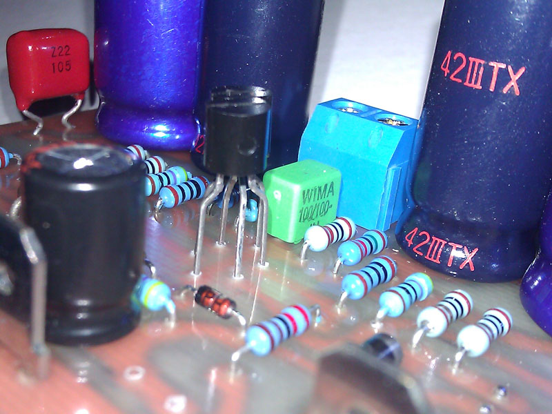

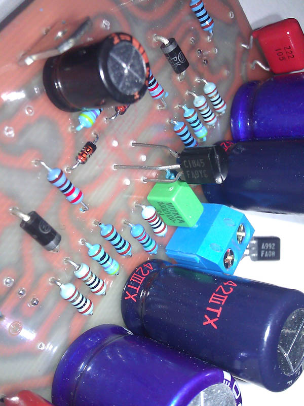

Dear Shaan,
if I changed some parts is that okay...
on the picture I replace BD139-140 with something different 😉
not soldered yet, if it is okay I will solder if not I will replace with 139-140 instead...
In my PeeCeeBee also we can add a pair more 1000uF at the rails if needed 😎
BTW what is the HFE of your input pair?

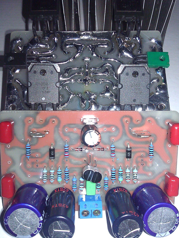

This how I put 2SA-SC transistor on BC PeeCeeBee
Hi Shaan,
Alfet now is beautifully singing. Based on your peeceebee design. I re-designed the output side in paint to accommodate the alfet. The vocal is crystal clear, very very detailed, the highs very smooth and the bass is there well balance🙂🙂🙂. I modified some components values to suit my taste. Running at low temperature in normal listening volume with small heat sink. I like this very much than previous one.🙂🙂🙂 Dc offset 0.0mV - 0.5mV. When using analog tester, the pointer stays at zero at 0.1 DCV setting.🙂🙂

Hi Shaan,
Boyet
Thats very good news boyet.
Just curious, do the Alfets have internal HV protection zeners? I guess not. If so, then it is a good idea to solder two of them between G and S pins of the FET(s), after the 100R gate stoppers. The (-) terminal of the zeners goes to Gate of the N-ch FET, and to Source for the P-ch FET. 15V rated ones, like 1N4744 will be perfect. 🙂
