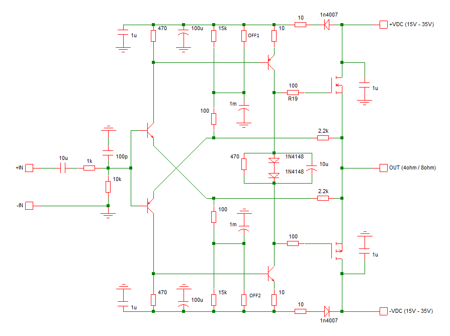

Please take 1 look at the schematic. It's in the first post. 😉

O yeaa... my second channel singing 🙂
Input tr sa970/sc2240
Input bias 13.9 mA
Dc offset 3.5mV
Final bias 100 mA
Congrats naf.
Remove that 470ohm parallel to the diodes and you'll get ~170mA. 🙂
I just finished shan's pcb too.
and i also get only 100ma at output,how should i increase current? 470r resistor is responsible for it?
Yes. Removing it will set the bias to that with the two diodes, i.e. about 170mA.

I parallel 10k and 47k to 1000uf capacitor in V+ side. It is ok shaan to put it there?
Yes it's okay.
Bias?
Connect the power supply with a 1ohm/1w resistor in series, in both + and - rails. Set the multimeter to mV and place the probes around one of the 1ohm resistors. Turn on the amplifier. The reading you see in the meter is the total bias. 🙂

Decided to try the Spark free layout software, and this is how far I got with my layout. I am basically using the circuit layout posted by Shaan as a guide.
The board is about 100x65 mm, which is intentional, so has plenty of room.
Added a couple pots since I have room for them (easily left off if not needed later). Some component sizes and capacitor pin spacing still need checking.
Not sure how much room to allow for heatsinks. Layout shows drivers mounted on a single wide and narrow heatsink.
Comments welcome.
Comments welcome.
Rough or not, that is an impressive piece of work!!Here's the pictures my vssa peeceebee.
Hi PMI.
Cool layout! And seems error free to me. Parts placement is good too. Just a little more thickness for the ground track will be good.
Thanks. I have room to make it wider. Maybe go to 4 mm. Nice job on the original layout, can appreciate it better now since I actually followed all of it, LOL.Hi PMI.
Any suggestions on the heatsink? Do you think thermal coupling the drivers will make any difference here?
