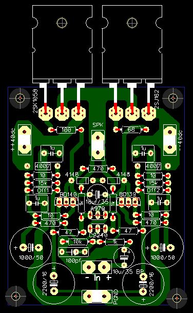

Hi naf, yeah, i fully satisfied the quality of sound of vssa. Can you share your 2sa/2sc peeceebee version? It hard to obtain here in our local electronic store bc550c/bc560c. Thank you in advance.
Boyet
Here my sa970/sc2240 version...
credit goes to LazyCat and Shaan for sharing enjoyment among us 😎
  • PeeCeeBee - myversion_based_onshaan_SA970-2240.pdf

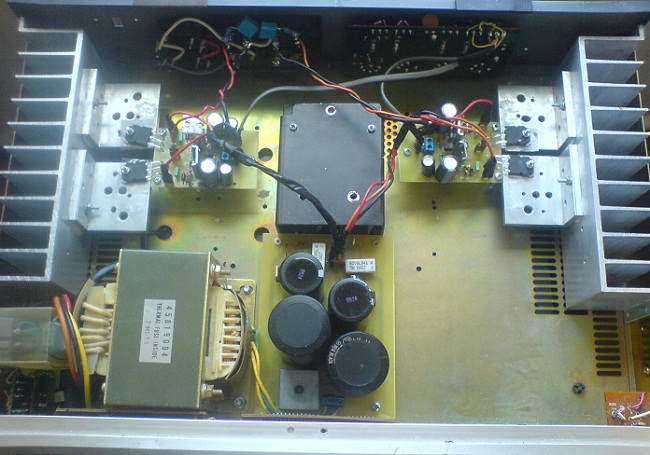

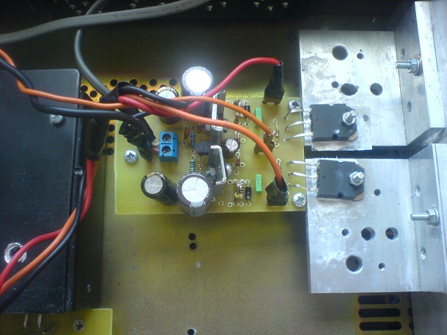

Here is another rude example of DIY. Regulated PSU.
I have 3x SSA stereo amps for my 3 way speaker active setup.Now i changed one for tweeter to VSSA.It's hard to judge as it's been only few hours of listening,but on tweeter i definately like VSSA more.And definately it is very very good (i'm sure someone would call it hi end) sounding amp.
Thank yo shaan for supporting underground movement
and Lazy Cat for sharing his knowledge with DIY comunity.

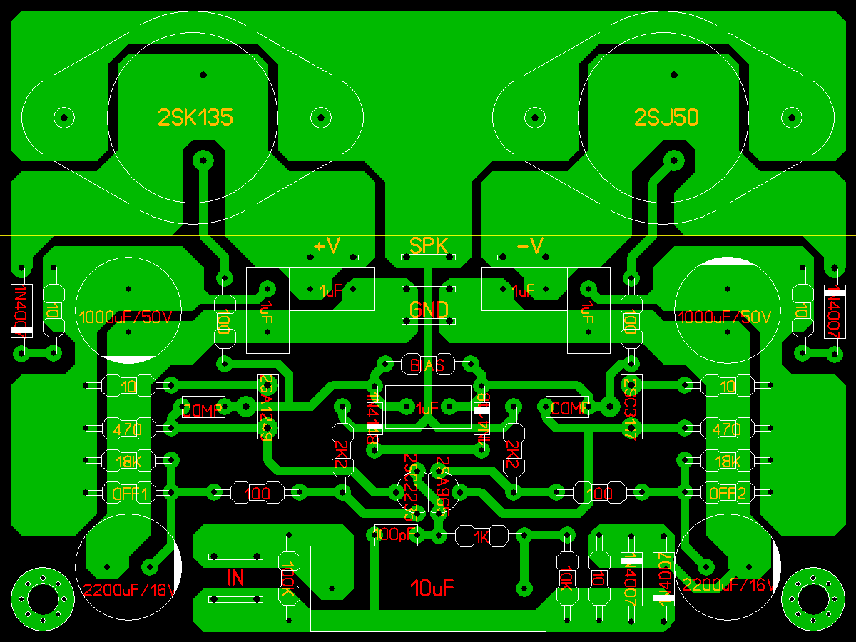

After much shuffling of components here's where my TO-3 version sits...
Looking good!
Some non-critical, non-expert suggestions:
1) Could the two 1uF caps on each side be aligned to be parallel? (i.e. rotate the one sitting 'east-west' so they both sit 'north-south')
2) Could the trace from the 2000 uF cap up to the 1000 uF cap be thinner?
3) Is there enough room between the edge of the TO3 heatsink and the v+, V- and speaker out connectors?
Steve.
