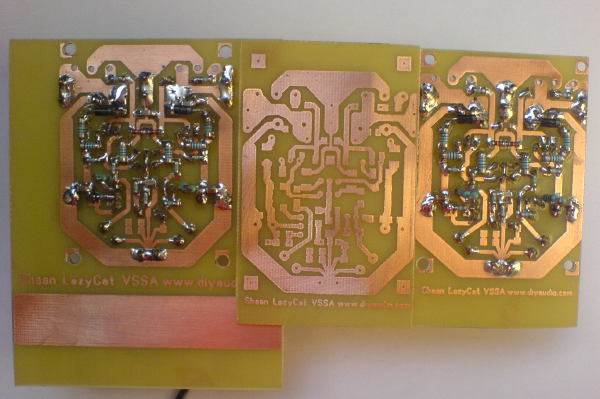

First of the TO3 PeeCeeBee's
Here's my first two TO3 PeeCeeBee's. Will begin to populate them with parts on hand very soon.

And partially stuffed...
Just a shot of a partially stuffed board. This is the proofing, and hopefully not poofing :hot:, unit that is essentially my junk box special. If it sings I'll get superior components for the project.

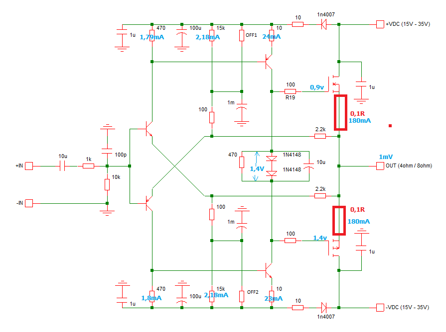

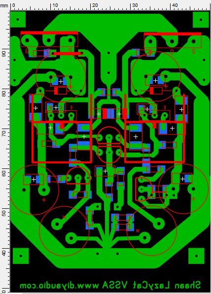

Hello
I have made 2 peeceebee boards and have small problem with one channel.
I am getting not symetrical gnd to mosfets gate voltages and offset is growing from 1mV (cold) to 13mV (hot).
Is the vas current ok in my board, leave it as it is?
The other board is fine (bias 110mA, symetrical from in to out all currents, vas is 25mA)
BIG thanks
Sorry forgotten - supply is +-37V

Thanks very much for advise!
Can you tell me can I leave vas bias as it is 25mA(after 30min stabilise) ?
In atatchment I have measurement. THX

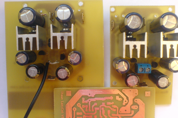

Hi,here is another PCB.I tried CCS circuit (jfet 2sk170 and two resistors) instead of one resistor.It can be easily inserted in pecebe as a module or P2P leg to leg,but i went another way,new SMD-melf based pcb.Ok it's messy as it's one sided.Had to use some laquie to be 99% sure it is safe.
Farnell forgot to include 22pf (compensation) capacitors in my order,so at first ,without them amp was oscillating - one amps both chanells had strange hum,another amp in the background had sound like CDP trying to play scratched CD 😱 but after i found some 10pf everything went fine.
Used j112 in CCS.
Also 1K feedback resistors instead of shaan's 2.2K-didnt measured active speakers setup yet,but the gain was changed i think this way...
The sound with shaans pcb and CCS was like heaven,now-i can't say so.All new capacitors needs time,so do i,i finished it only few hours ago..
You're welcome.
VAS bias should be 12-15 mA, just in a middle of hFE/Ic curve where VAS BJTs are in the most linear region. Also 25 mA gives senseless too much heat to dissipate. Adjust both 15k resistors to set correct VAS bias and 0 mV output DC offset. 😉
