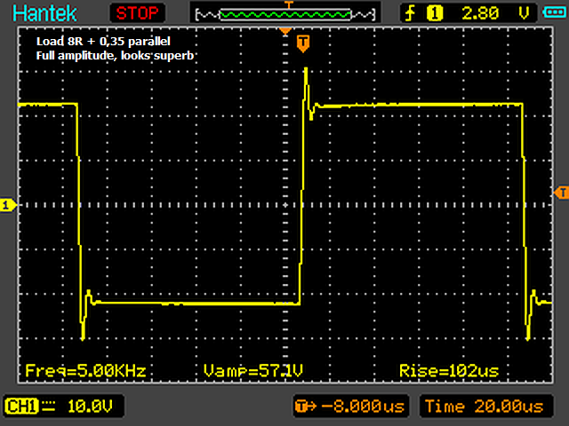

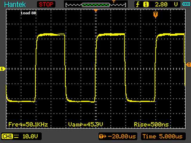

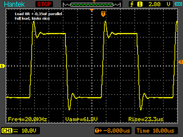

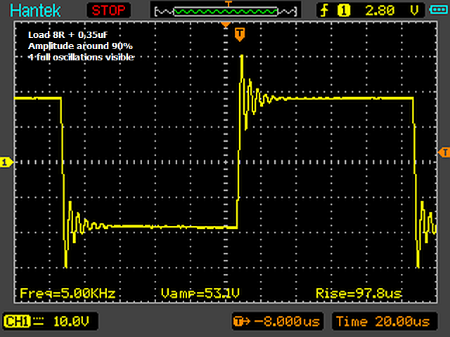

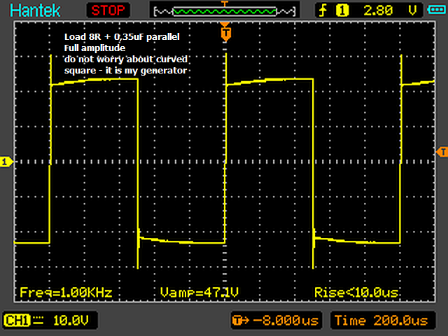

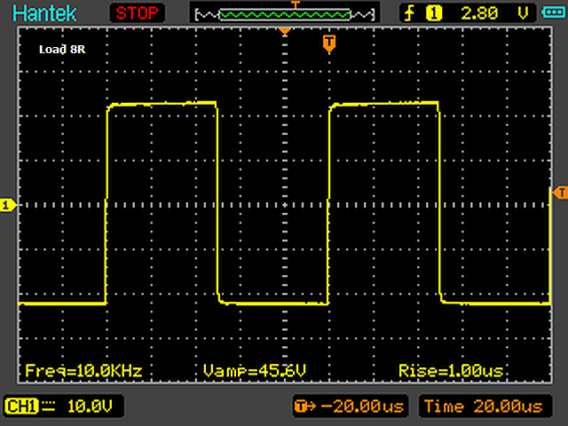

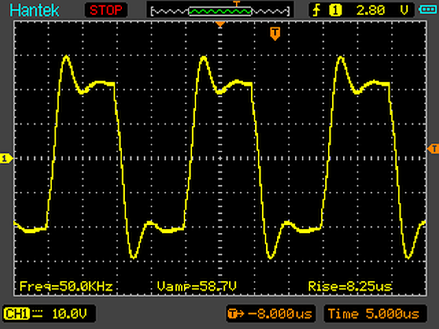

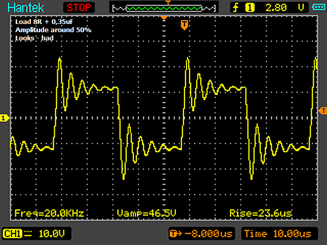

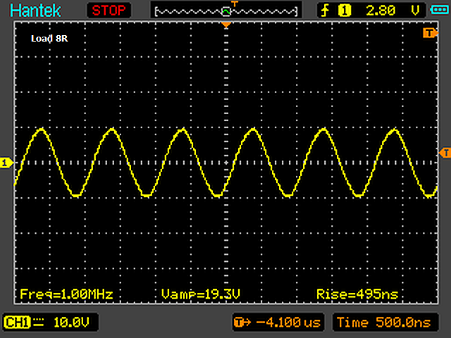

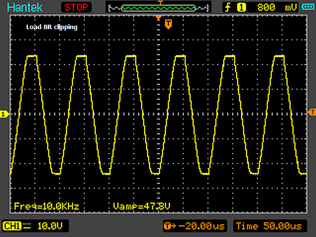

I have made some measurements today, and do not know why
on full amplitude everything looks very very good, but with lower amplitude pulse response is getting worse - is this normal ?
Load is 8R + 0,35uF. There was no input cap fitted on measurement.
My amp is mada according shan schematic (resistor values + no 22p caps in VAS stage) THX

Have you fitted a Zobel or a Pi network to see if that helps?
There is no zobel fitted, just bare two laterals and two 0,1R resistors
hahaha you would expect better without output filters (zobel + pi), without regulated bias spreader and without CCS, no way. For a sch you've built you've got superb results
Hi borys.
First, remove both 0.1r resistors, these things there can cause interesting and weird problems and the blame will be put on the amp as a whole, as usual.
If you are using 1k/47r in fb network then increase them to 2k2/100r and check the output. If still no good then install Cdom and zobel and check again.
If none of the above helps then install the CCS which will make the amp a superfast rocket. Then give it a ride and see if the journey is smooth enough.
If still too shaky then the problem is either in the PS or the signal source/input cable.
Thanks for help.
I have 2,2k/100r at the moment.
I will try some modyfications at the weekend.
So basicly everythink is working fine - thanks for replay.
LC
I do not expect anything more (it is very very good rigt now), just want to make sure that I have assebled the amp properly.
Only what I am not sure is 3 last pictures, If there is a way to improve not full amplitude response to make it look like full amplitude (full is excellent).

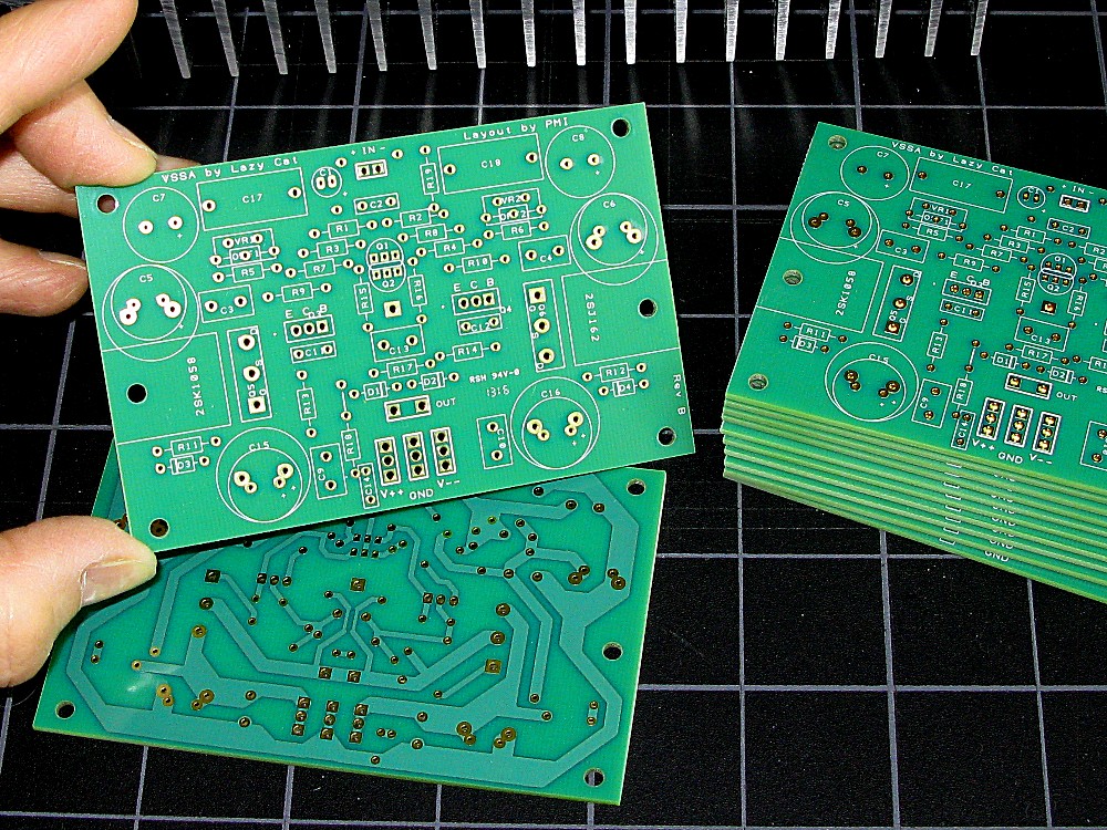

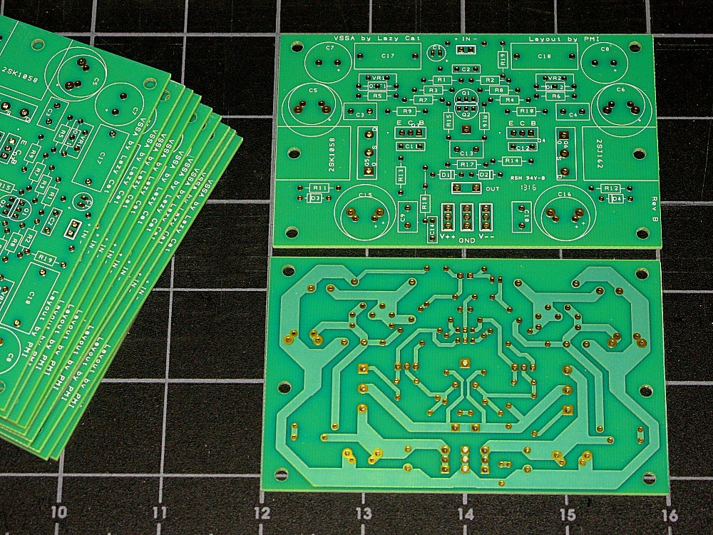

Progress (Finally)
I finally got my boards and most of the parts to assemble and test... and, many thanks to those who helped to get this far,
In case the pics are confusing, the layout IS single layer, all circuit traces on the bottom of the board, silk screen on the top, all through-hole parts, most components on top, 2SK1058/J162 on the bottom. However, the boards were fabricated as if 2-layer, with plated holes and solder mask on both sides.

This is an excellent way to design a PCB................the layout IS single layer, all circuit traces on the bottom of the board, silk screen on the top, all through-hole parts, ........ However, the boards were fabricated as if 2-layer, with plated holes and solder mask on both sides.
Now that PTH and double layer PCBs are affordable, I wish more would do it this way.
@AndrewT: I was happy with the way it turned out, given that I wanted to get more than a couple pieces at a low cost. The plated-through holes help (in my case, at least), b/c pads don't detach if I have to de-solder a component. Also, there is some flexibility in soldering on top or bottom for ease of access.
@Jkueteman: I used "Rush PCB" in San Jose, California, first time for me, but recommended by someone else. (RushPCB.com) If you plan to do this a few times, there is no substitute for a friendly local source, but my usual contact was not available to do a small run. Circuit boards are a funny business. You have to be willing to make a few phone calls, and not take it personally when someone quotes high. Usually you can find a company that will bundle your prototypes with a larger order from someone else, but you may have to live with a 2-week delivery time. Also, taking the time to learn how to use a Gerber file viewer to check the layout one layer at a time against the board outline and against the silkscreen helps avoid mistakes you won't see otherwise. Seems like a waste of time in the beginning, but you get to appreciate it if you find a mistake.
