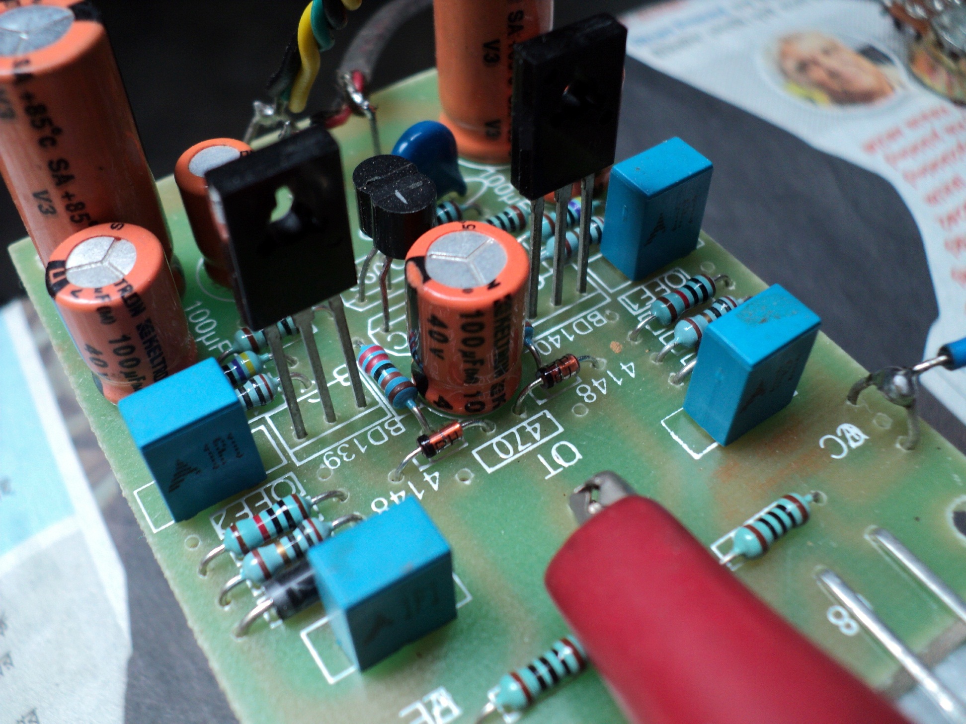

My amp is rock solid. I have changed 15k resistors with 18k and vas bias is 10ma to 14ma, output offset is 0,8mV, output bias is 100mA stable.
Amp is playing day and night to get bed in (amp is at work so can play whole night no problem 😛)
Regards
Ps
O scope on output I have no oscillations at all.

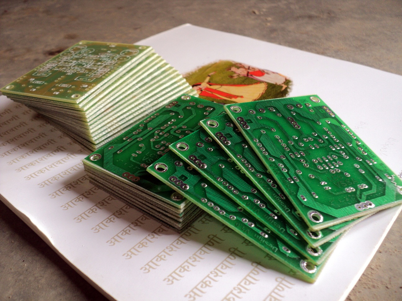

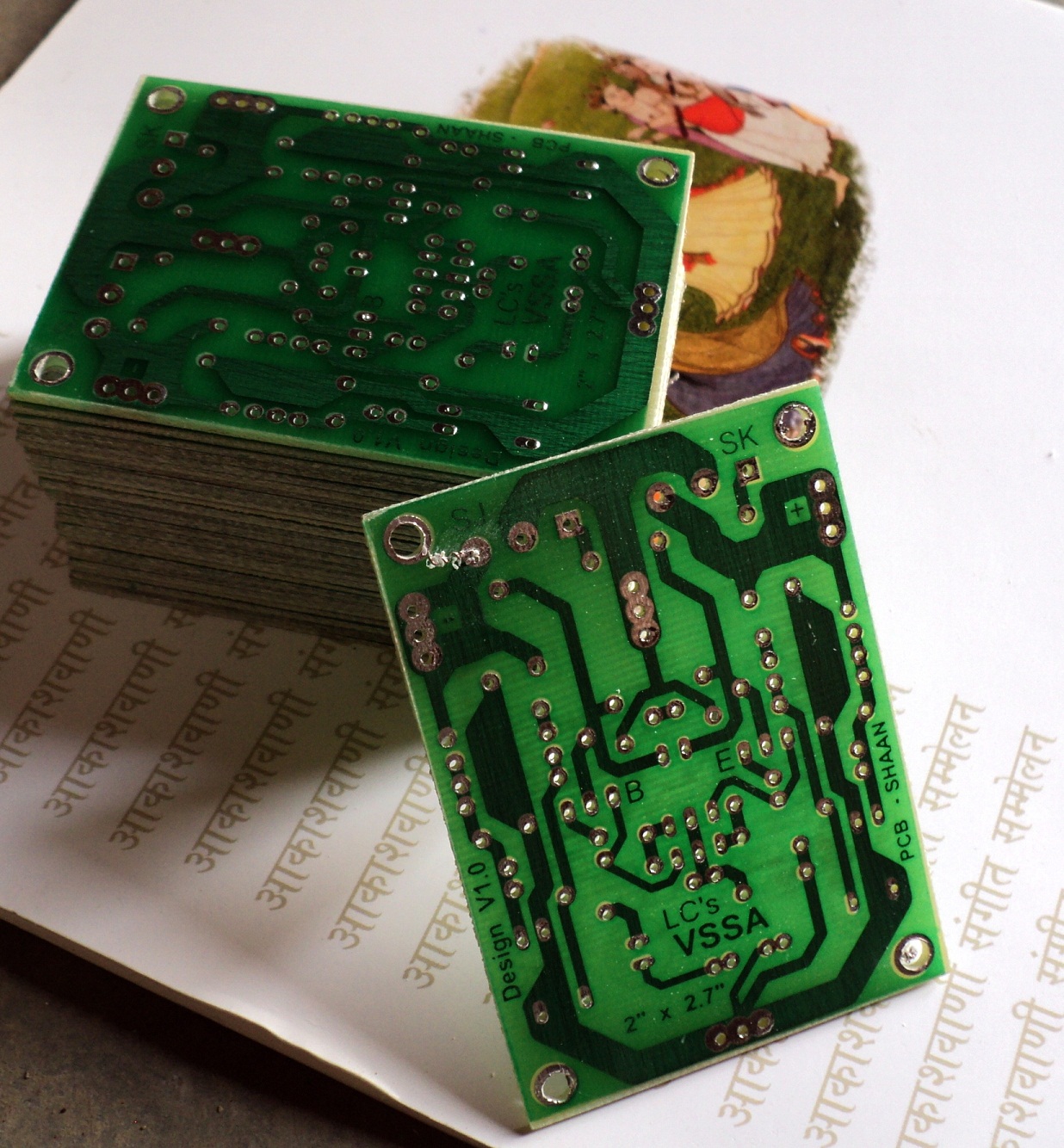

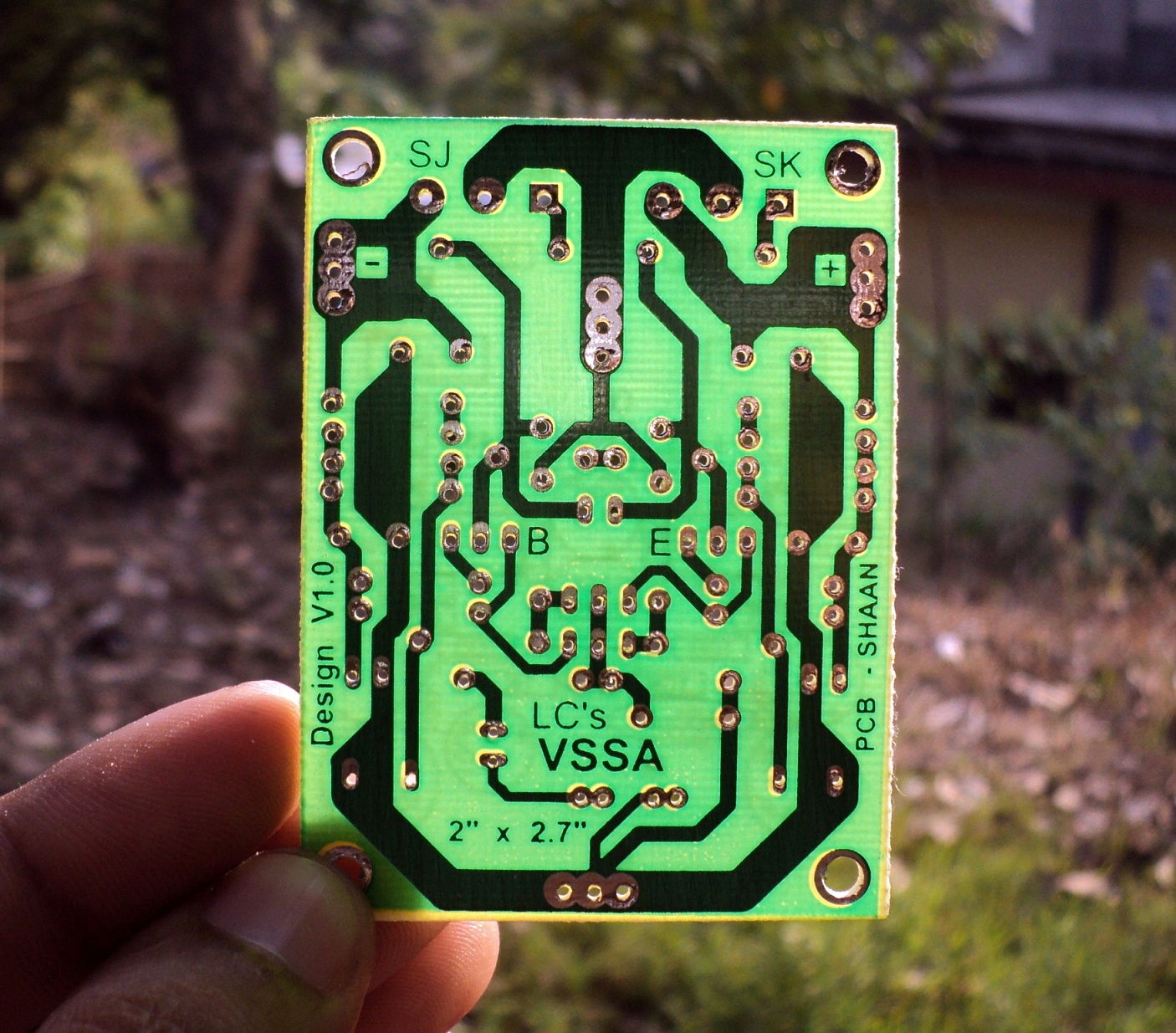

You guys are very very kind. But these boards are for my own and local friends' amp jobs only and will(should) not be made available for group buys. Cause explained below.

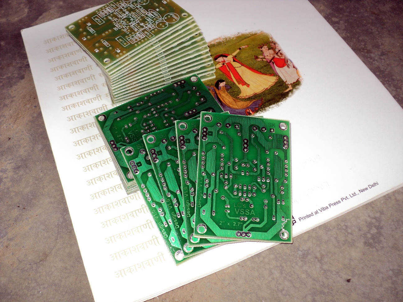

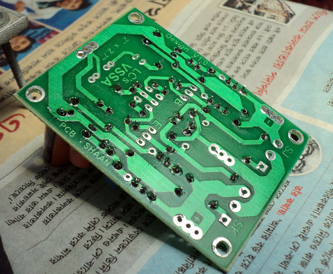

And here they are(although very late).
As you can see the boards look pretty cool(well, to me at least). But there are some printing faults by the etching guys(it was a cheap job anyway).
Problems: there are some jumbled prints on the silkscreen side of the larger fonts and the solder mask isn't perfectly aligned with the outline of the board(however, the pads are well surrounded and are error free b.t.w., also the parts fit exactly as planned 😎 ).
I have populated two of the boards and the first had 5mV offset and the second now has 11mV, without manual setting, stable. And as usual with an SSA, the boards are singing all day long, still naked.

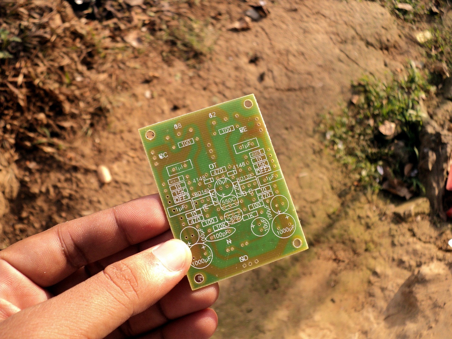

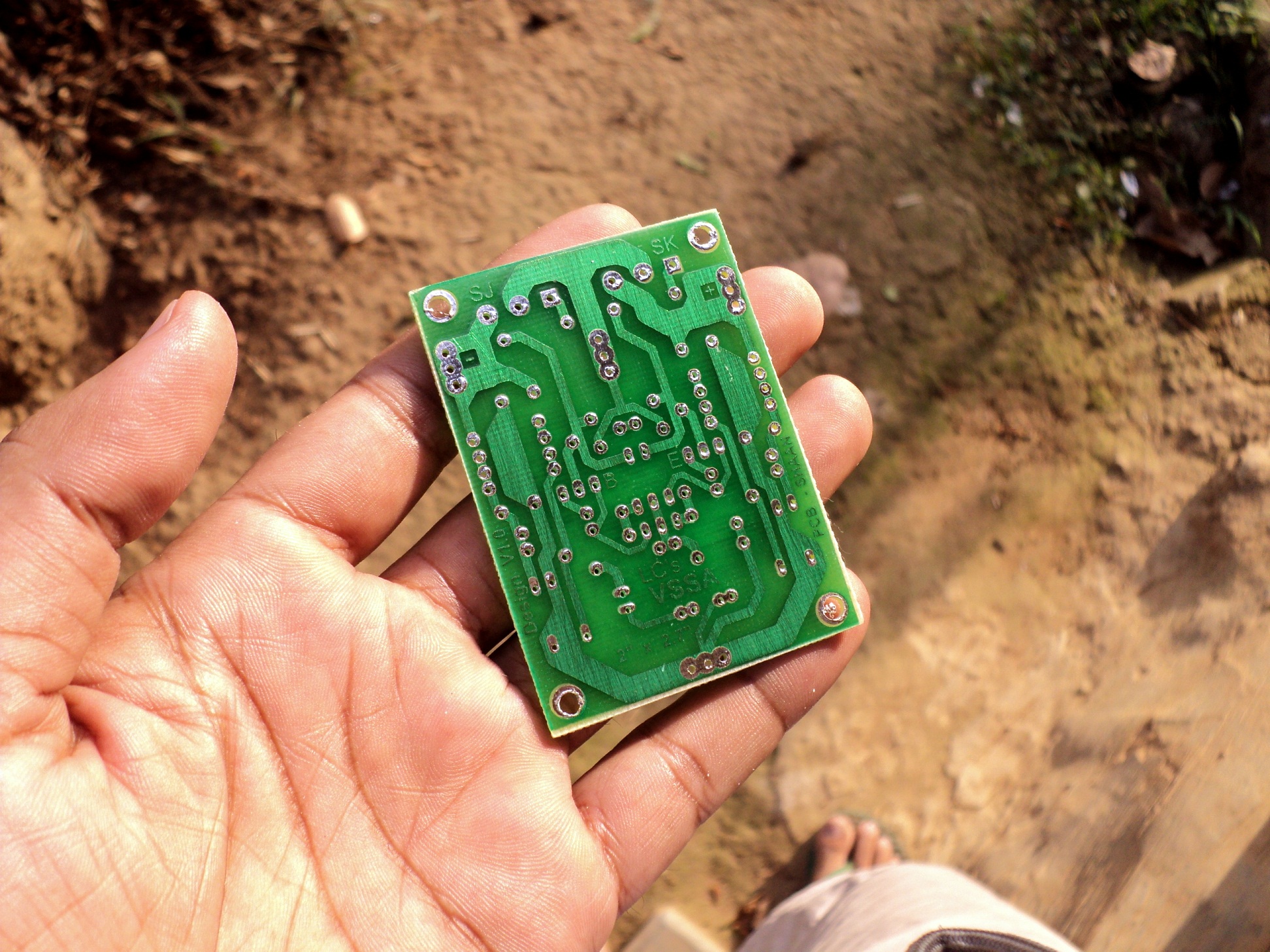

Here's my first two TO3 PeeCeeBee's. Will begin to populate them with parts on hand very soon.

Pix will be uploaded soon.

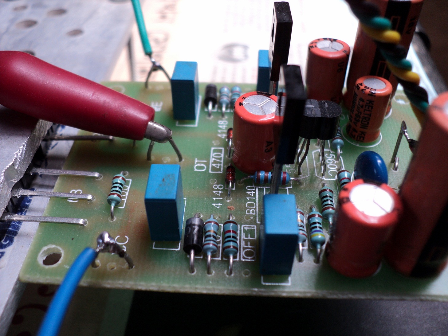

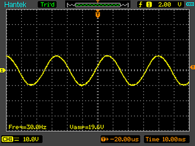

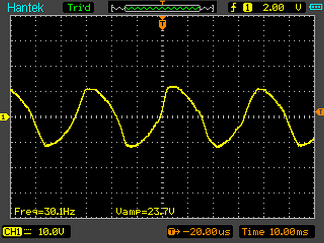

I found small problem with my amp, distortion in low freq.
Supply is 80W transformer 68V (both rails together on iddle), load is 8R.
Supply is dropping to 66V and 65V (both rails)
Take a look at around 30-35W 30Hz sin output.

Few possible reasons:
- too small value of FB coupling elcos, they should be 2200 uF/6,3 V
- not enough drive current, VAS bias should be 12-15 mA
- bad output mosfets, too low transconductance

Does not seem right... if 80W means 80VA total power, and 68V == dual 34V secondary winding, this would not be enough power for two channels at 8R nominal load, especially for a test at low frequency.Supply is 80W transformer 68V (both rails together on iddle), load is 8R.
Do the two pics show a distorted signal on the left, and an un-distorted signal at lower amplitude on the right?
A continuous signal at low frequency is pretty much a worst case test for system limited by power supply capacity. So as the amplitude of the test signal increases, the demand on the power supply exceeds the capacity of the transformer, the magnetic field starts to collapse, ...etc.

Are mosfets originals? High price of lateral mosfets = high motivation for some people to fake them.

80VA transformer is for one channel for test.
I think fault is with my laptop crap sound card. I repeted measurement of input to amp and it looks exacly the same - I have to buffer or preamp the input to amp. THX
It's nothing wrong with your sound card, just needs bigger coupling capacitor on its outputs. Look inside PC, track down output capacitors on both channels of the sound card and replace them with 10 times higher values as they're now. 😉
