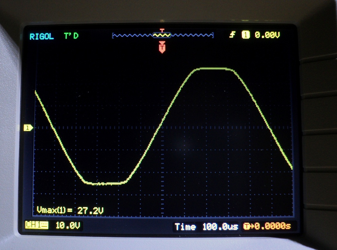

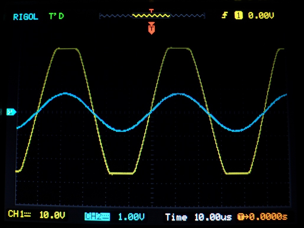

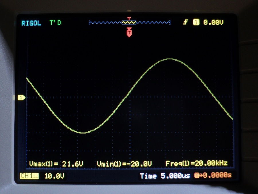

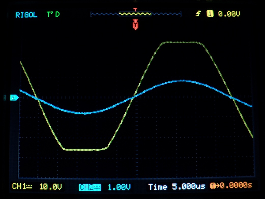

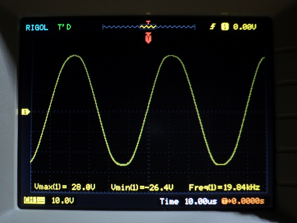

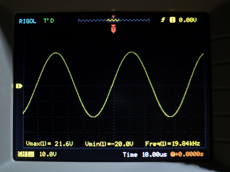

Try to repeat this test with 20kHz signal ...Here are a couple shots of the prototype of the upcoming PeeCeeBee clipping into 8R resistive load. Also a link to a very short video that I just uploaded showing it in real time. 😀
Video link Here.
20K Clipping shots of V4.
2x gain NE5532 preamp used between signal source and amp. No capacitor between amplifier and preamplifier. Load resistance 8 ohm. Zobel disconnected.
Pic 1 - Unclipped output
Pic 2 - Zoomed
Pic 3 - Clipped output
Pic 4 - Zoomed
How soft is that? 😉

Could you increase the input signal a little bit to show heavy clipping? And also the input wave form on channel 2.
Is your power supply stabilized?
Thx, Toni

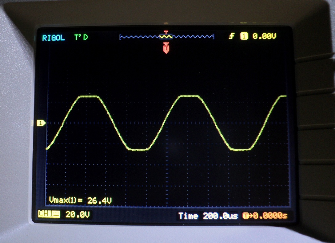

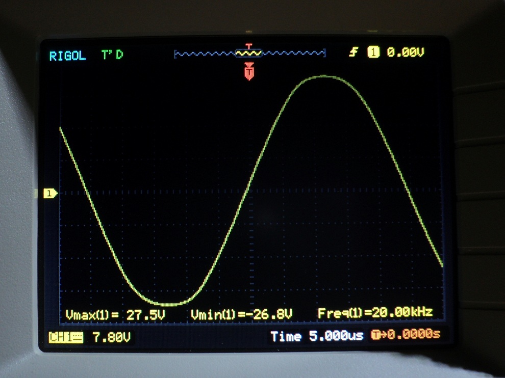

A couple photos.
A couple photos.
Looks very good so far - very good overload behavior. Zoom further in and check top and bottom edges for oscillations during recovery from overload.
May be difficult to tune your scope to get those readings. 😉
BR, Toni
Hi Toni.
Thanks for the tip.
I did notice that and thought there was something fishy going on. So I zoomed and checked both edges (with averaging on and off) and there is no oscillation, but forgot to take some photos. Will upload close-shots of the edges later.
Thanks for the tip.

Normal VSSA-CFA clipping, welcome to the party. 😉

All comes with some price. This design looks like to have a good clipping behavior.
Any amplifier which is driven to clipping leaves the audiophile zone regardless of the clipping figure. With a lower power amplifier it is very likely that you drive it earlier to this limit especially with lower efficiency speakers. A good overload characteristic doesn't better your hearing experience - only saves your treble speakers.
