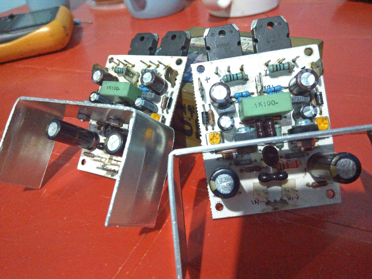

that is nice compact layout![]()
final update :
- C3503 & A1831
- Pan FC
- mix Takman & Dale resistors
noticable better instruments position

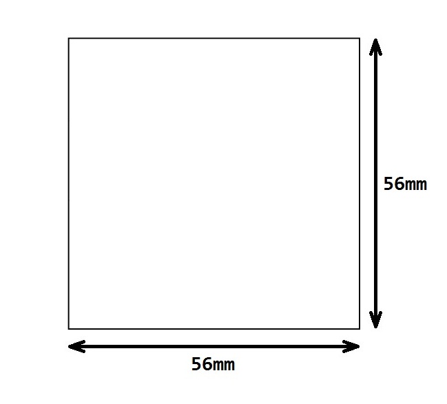

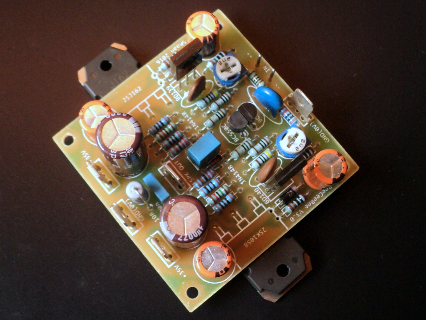

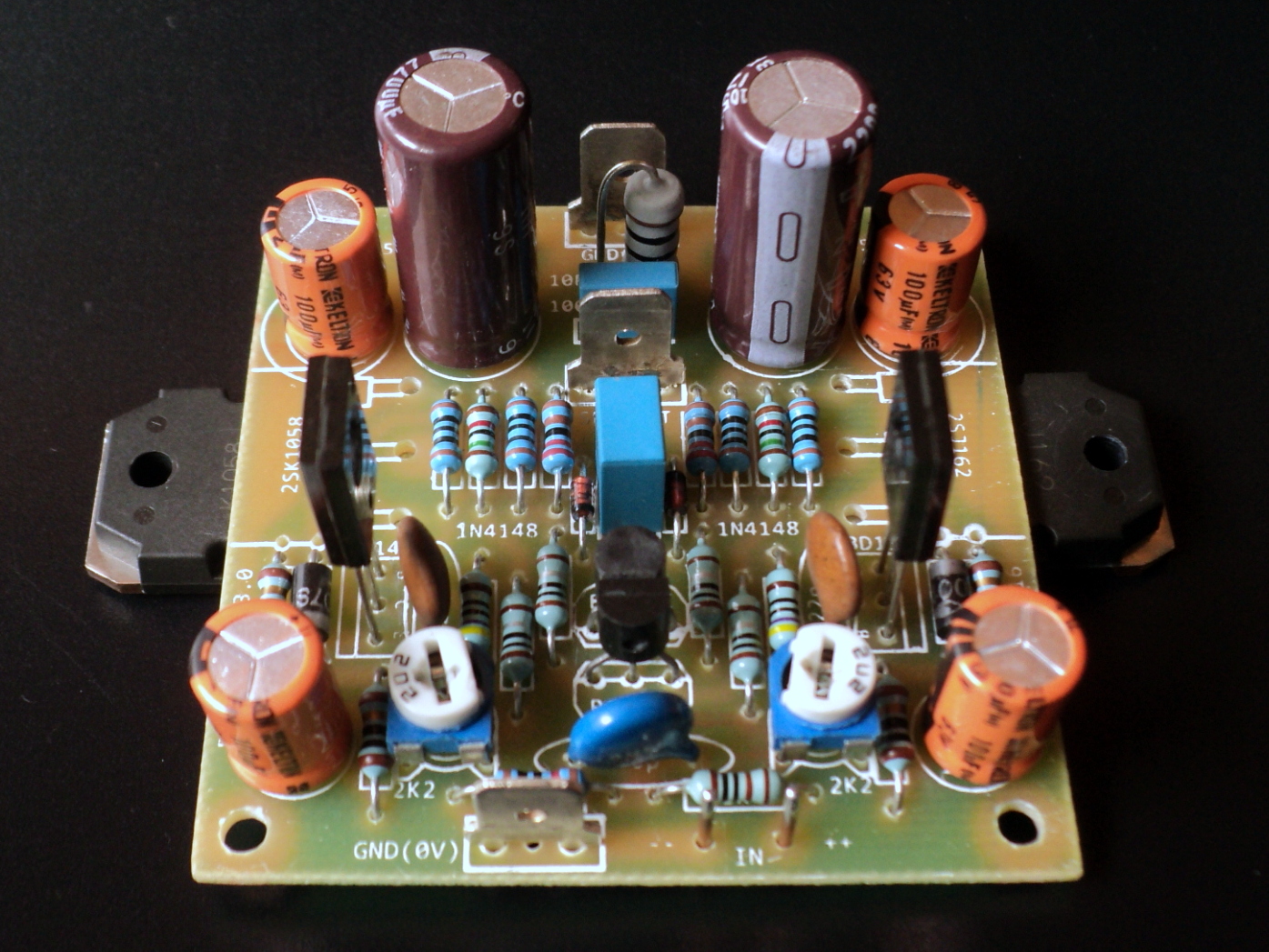

Hello Fellow DIYers!
Here goes the PDFs for the PeeCeeBee V3!!🙂
Wishing you all a Merry Christmas and Happy New Year!!!
shaan😉
shaan😉

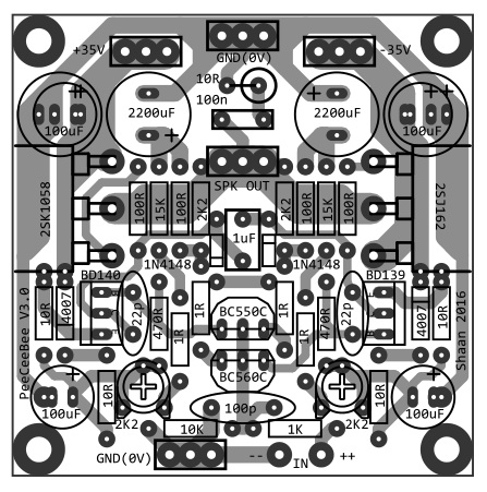

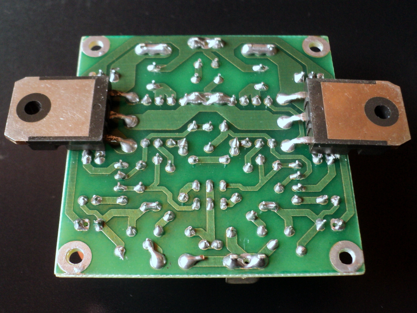

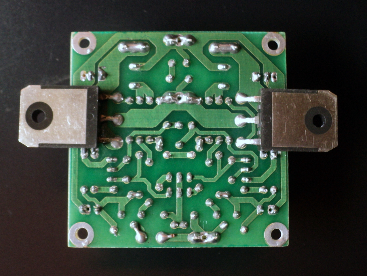

Hi Shaan😎
I see the feedback electrolytics in the power GND now!
Since February 2016! 😉
Do i missing something?
I see 2200uf connected together with the power gnd wire when in the other version together with the signal gnd wire.

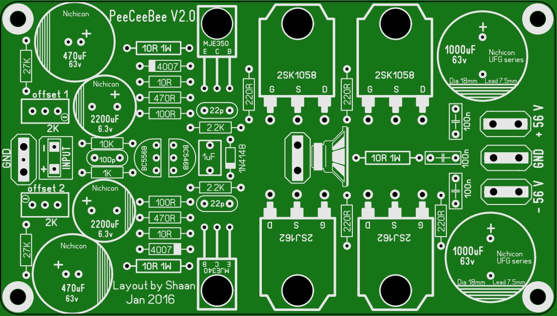

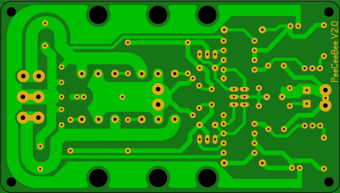

Hello Shaan
I retouched Peeceebee V2.0 pcb.
I will use Nichicon UFG series Audio Grade Electrolytic Capacitors
Nichicon UFG series capacitors diameter is bigger than other capacitors.
Gerber and lay files attached
Hi btesize!
Very nice unification of angled and curved traces! I love the combo!
Thanks for sharing. 🙂
New Shaan designed pcb is with feadback caps on power gnd,please make the same on your's.😉Hello Shaan
The reason the feedback caps in V3 were routed to the power ground is quite obvious as soon as we see the board layout, to accommodate all the components on that tiny board. V2 is more spacious compared to V3 so this trick is unnecessary. Also in V2 the nearest ground traces to the feedback section is too long to ensure a clean feedback ground. Notice that the feedback caps in the V3 is directly connected to the power GND with small dedicated traces, which I think is not possible in V2 just because of the size of the board.
Ok i got it!The reason the feedback caps in V3 were routed to the power ground is quite obvious as soon as we see the board layout, to accommodate all the components on that tiny board. V2 is more spacious compared to V3 so this trick is unnecessary. Also in V2 the nearest ground traces to the feedback section is too long to ensure a clean feedback ground. Notice that the feedback caps in the V3 is directly connected to the power GND with small dedicated traces, which I think is not possible in V2 just because of the size of the board.

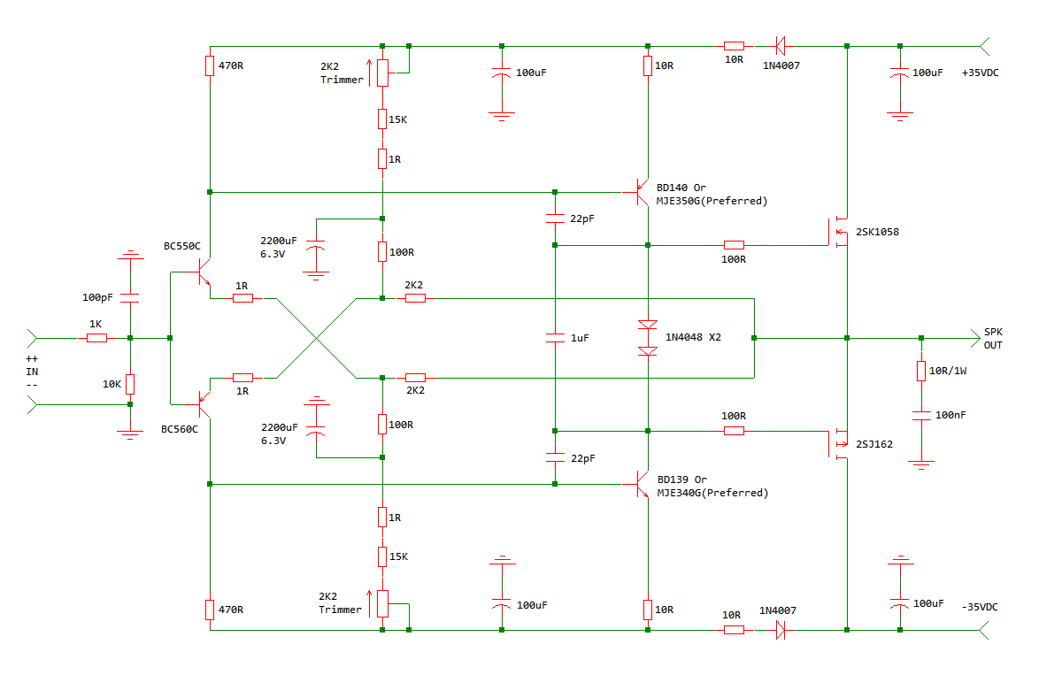

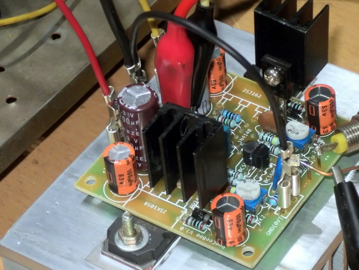

hay shaan, i have a few question
- Can i, add 3 more pair output stage & how many watt if use 4 pair ouput stage?
- In schematic V3 (post #2187) how to setting & measurement 2 pcs trimer for maximum amp performance?
Thank's, gyw
Thank's, gyw
Thank's, gyw
Hi gyw.
- Adding more pairs won't give you more power in the same load unless you increase the PS voltage as well. You can add 4 pairs and with +/-70V and get maybe 500W into 4R load (you will need to add/remove a lot of other stuffs for the amp to work well at that voltage). Even if you don't increase voltage but instead decrease load impedance for more power, emitter followers between the VAS and OPS will be necessaary for any VAS load above 2nF. Bottomline - not recommended in the default PeeCeeBee config.
- In V3 the trimmers are there mainly to zero the offset. Initially VAS bias is auto-set to between 5mA and 15mA by the 15K resistors. The trimmers will help to some extent to increase/decrease a VAS bias that is too low or too high. 10mA is a good VAS bias in V3 for overall good performance (100mV around VAS emitter resistors). OPS bias is auto-set by 1N4148 diodes. As preferred in the BOM and schema, using MJE340G/350G or any other high gain pair for the VAS instead of BD pair will increase performance.
