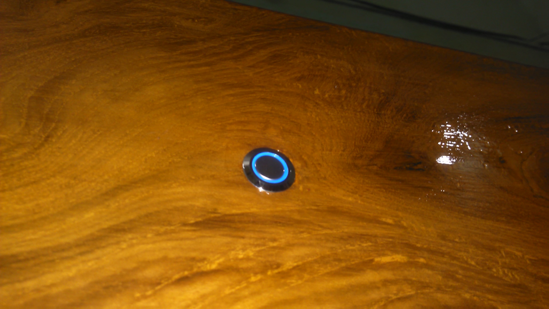

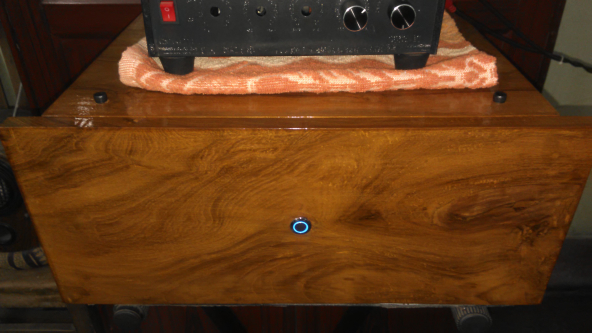

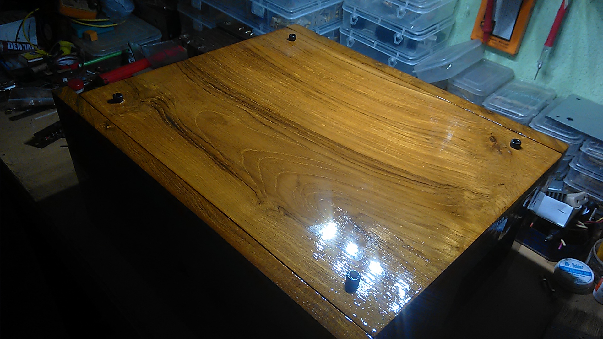

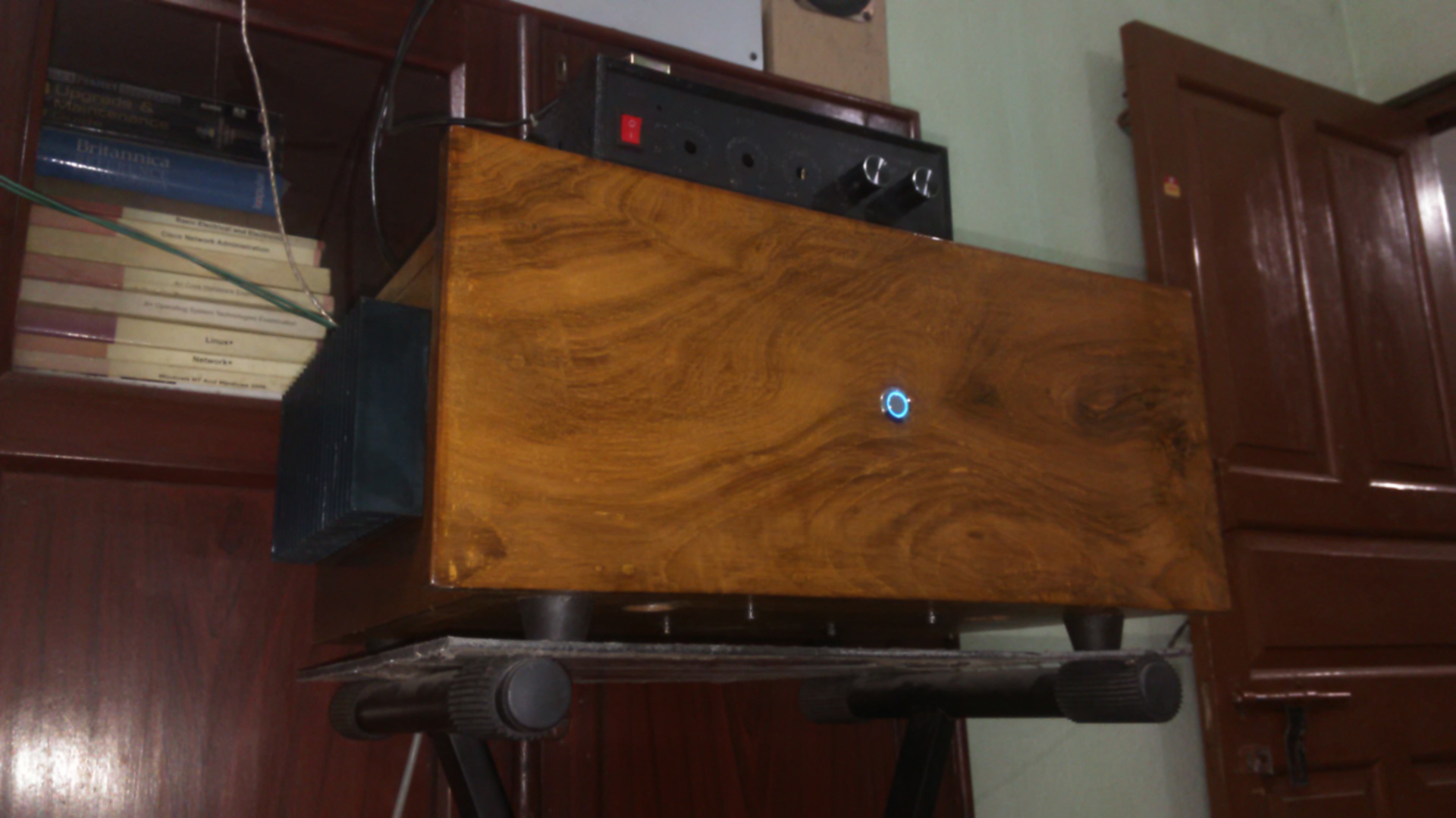

Hi fellas.
The v2 monster has been born, with a teak body. 😀

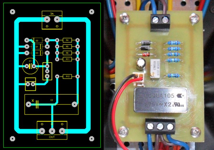

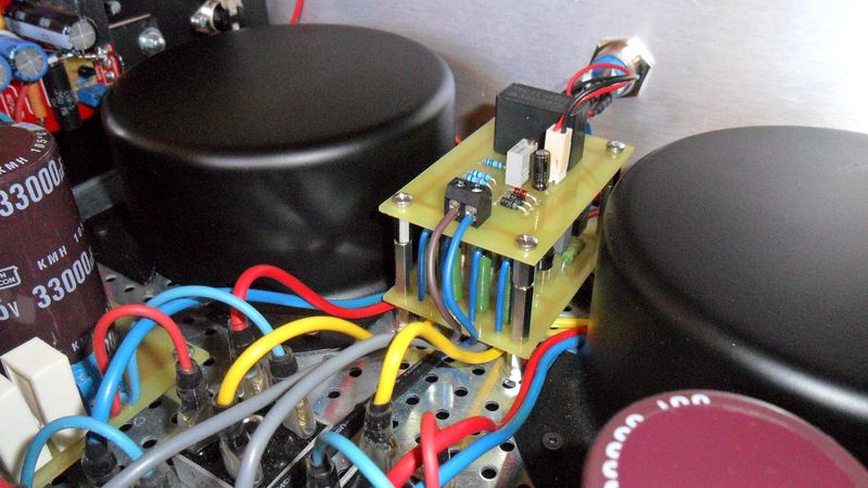

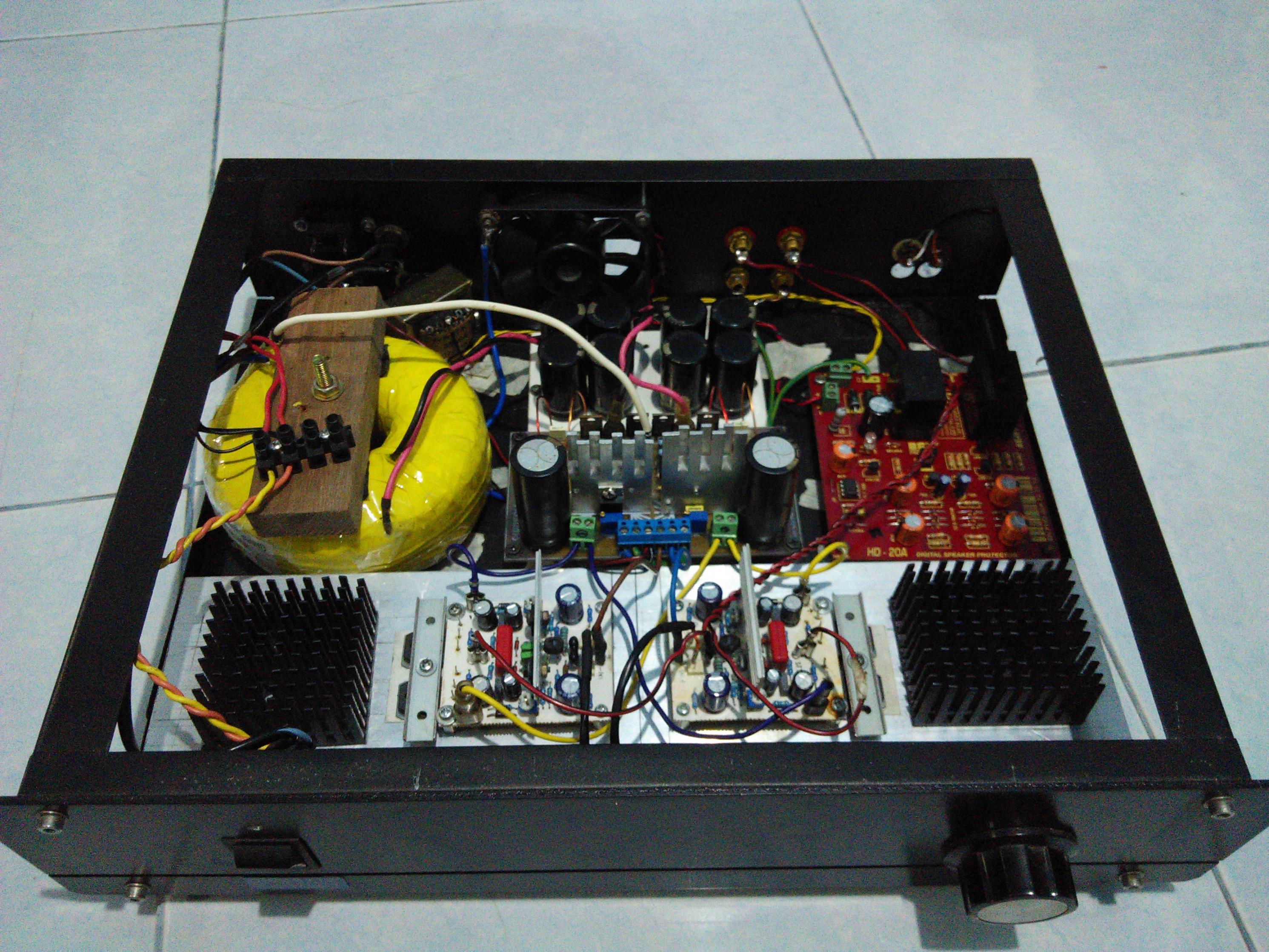

@xrk971
These switches are plain contact type. You will need a latch circuit with relay for switching on the power. I built one on veroboard and used in this amp.
In several projects I used a small assembly which provides power to the limineux circle with a light adjustment directly on the sector and which also allows the sector to bring the following items.
The operation is flawless and even in a preamplifier RIAA no noise problems.

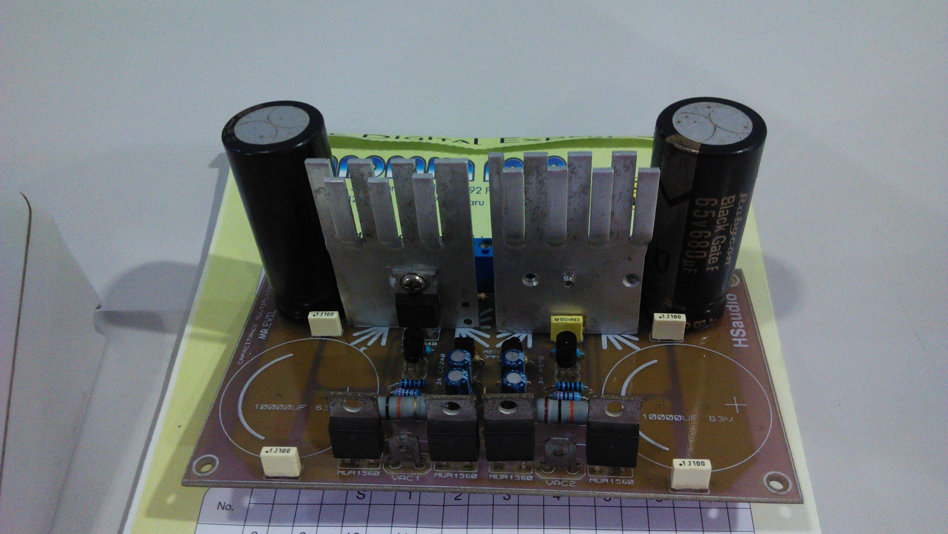

Thank Shaan, Found that black heatsink from old CPU cooler, cut in to two pieces then mount it there. The torodial transformer was 18-0VAC dual secondary, modified to 24.5VAC CT (extend couples turns of enamel wire), it was 6.25A for single rail based on the datasheet, should be enough to supply peeceebee. 🙂
