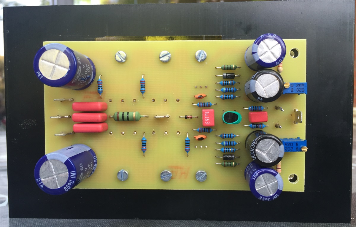

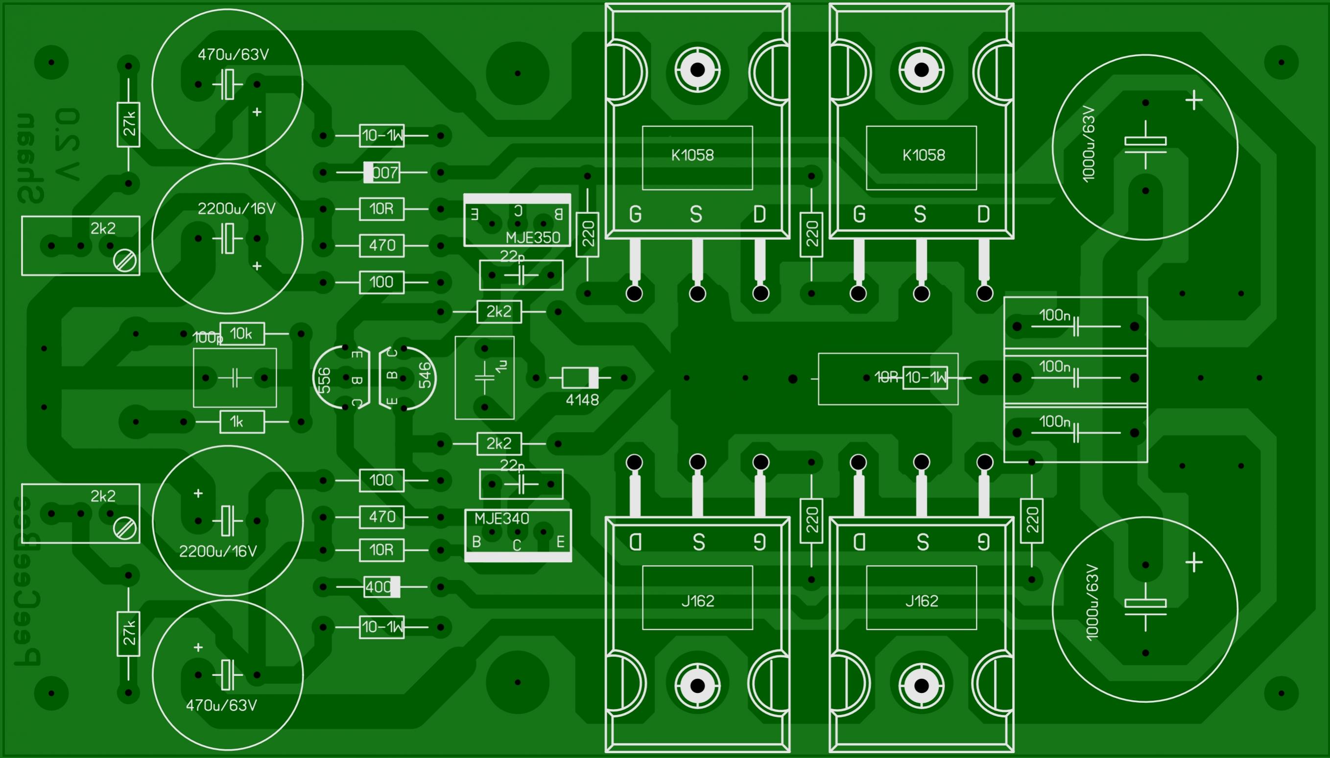

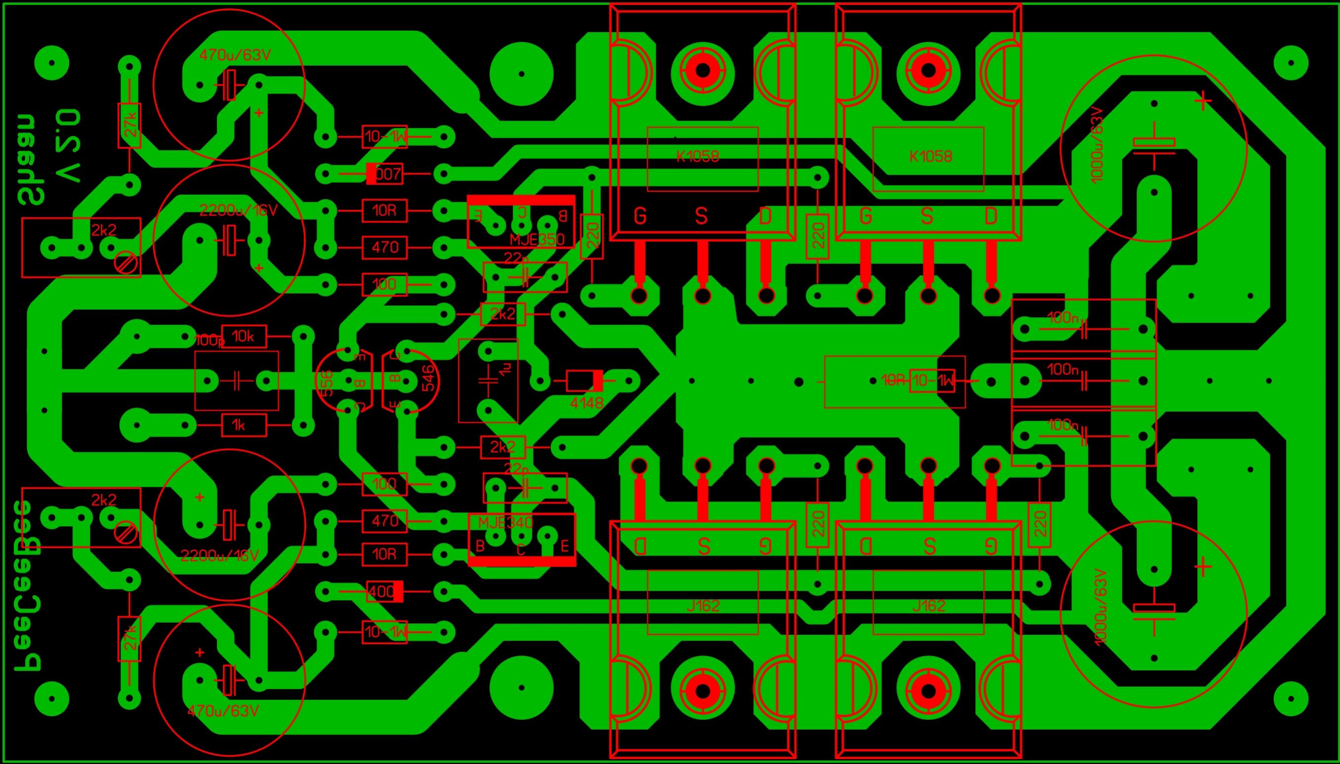

I made one for my own components based on Shaans Layout.
But it is not tested!!!
regards Olaf

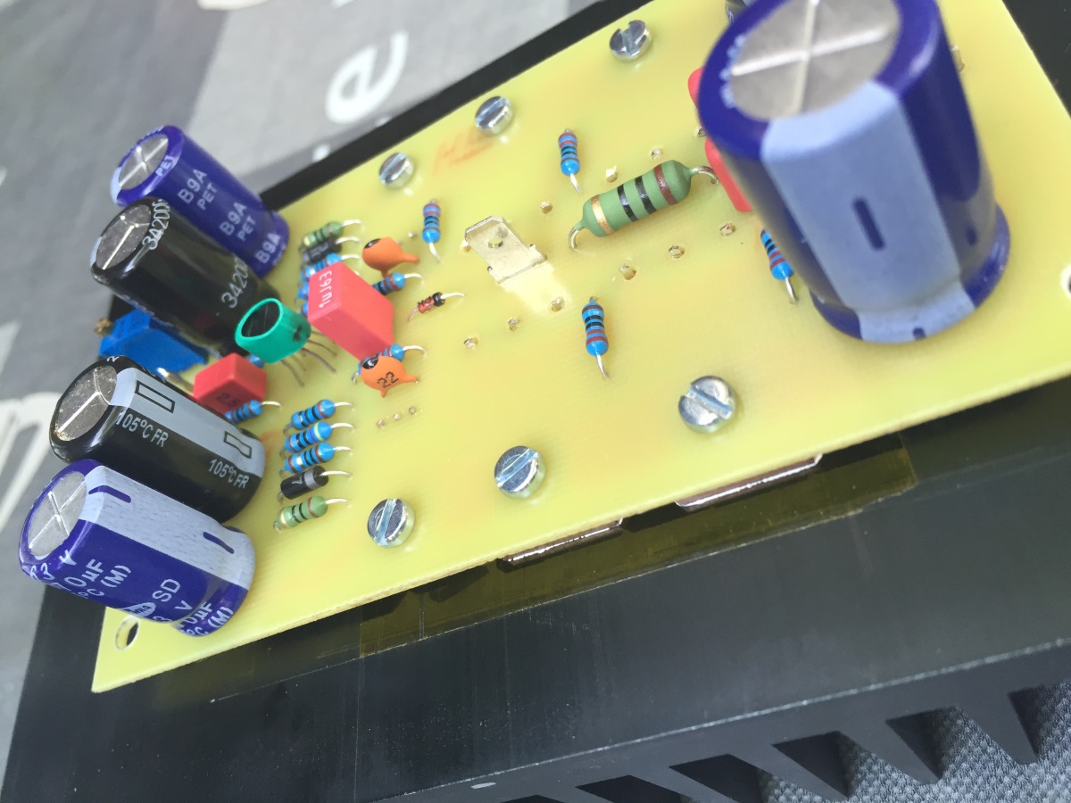

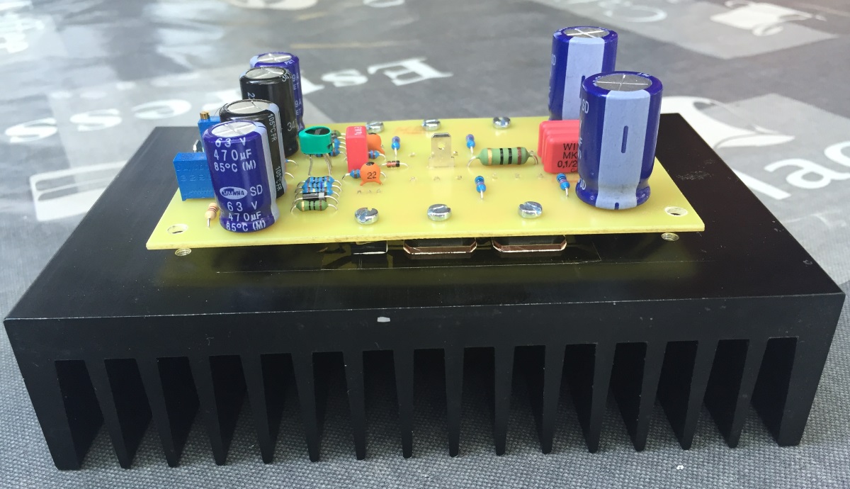

Hi Shaan,
Thanks once again! The V2 plays super good. Very beautiful sound, worked right from the first time powered on. When I find time I will upload some measurements.
One PeeCeeBee more 🙂
regards Olaf

here are the files. Have fun! It is a very cool amplifier 😎.
regards Olaf
