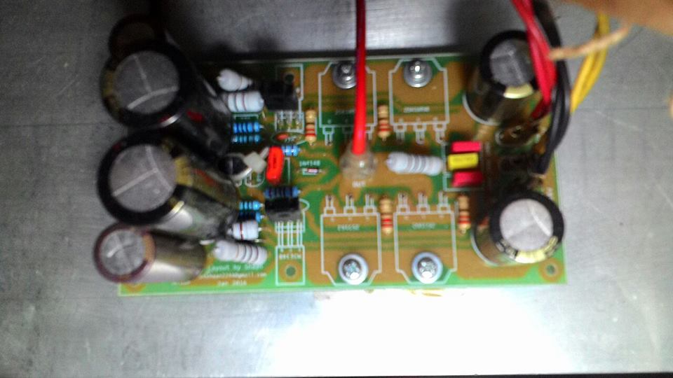

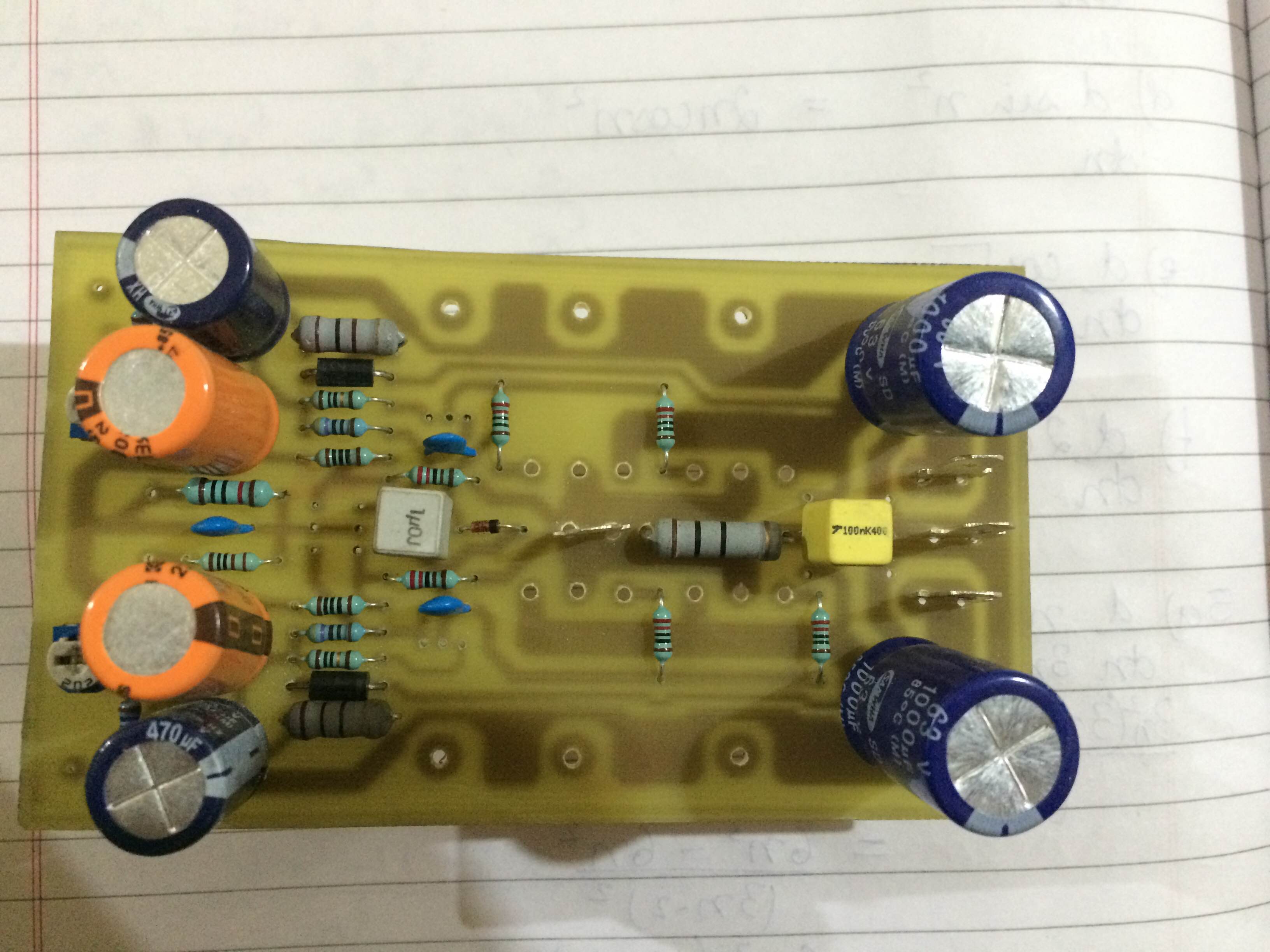

Hi..
this is my first VSSA V2.. with some parts available in my little village.
some resistors value are measured differently comparing to the color code . I choose the closest value to install into the pcb.
But the sound is very fine, and I plan to get better parts. I am sure these amplifiers will sound better with more appropriate parts.
Thank you so much dear Shaan.
Best Regards

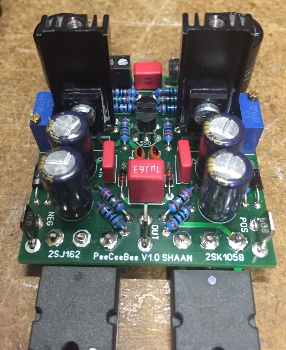

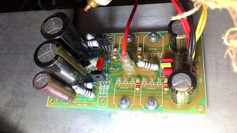

Do not use bc550/560 when power supply is higher than 35V.It's true... swap to bc550c/560c, more detailed and also low freq better than before.
Seem going to contact JB, my bcs' hfe under 500, not good enough ?
forgot; also replace those elna re3 to panasonic m series

my peeceebee board 1.1 version

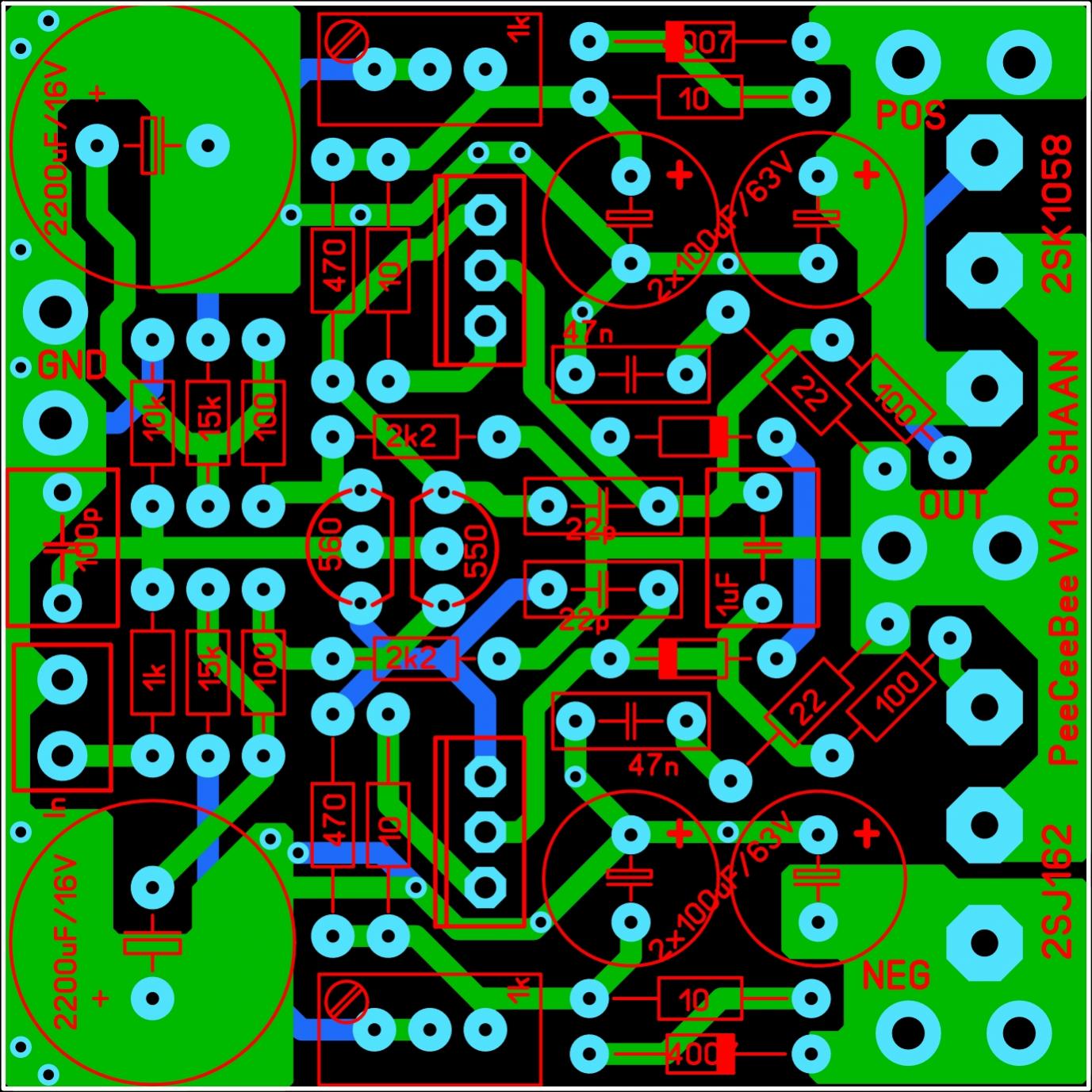

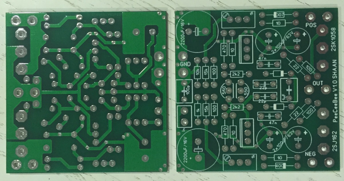

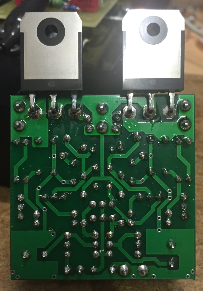

The story is, that I wanted to let manufacture the very first time a professional printed circuit board. Until now I have always etched for myself.
For cost reasons, the dimensions should be under 5x5 cm. For this the PeeCeeBee is perfect.
This is the result. I do not even know how to attach the modules (no more space for mounting holes ), but the PeeCeeBee sings and is looking nice.
regards Olaf
