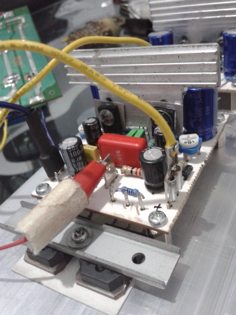

i've read some last couple pages of this thread, you said that peeceebee V1.1 perform better with supply of 32-35VDC, since i got a good quality of torodial transformer with 18-0 VAC dual secondary 112.5VA/rail (used to supply my lm1875), any possibilities to use it?
or just stay use EI transformer moderate quality with 24 CT VAC 120VA?

Hello guzz.
For two V1.1 channels I would go for two moderate quality EI transformer with 24VAC CT 120VA, or a single 240VA.

Hi shaan,
okay but sadly here, only have a single EI trafo but nevermind, never play music as loud as an amplifier could go in wattage 🙂
after done with my supply i'll try to report what actually my "baby moster" sounds like.
Then close your eyes and hook up that 120VA EI!
Looking forward to that.
