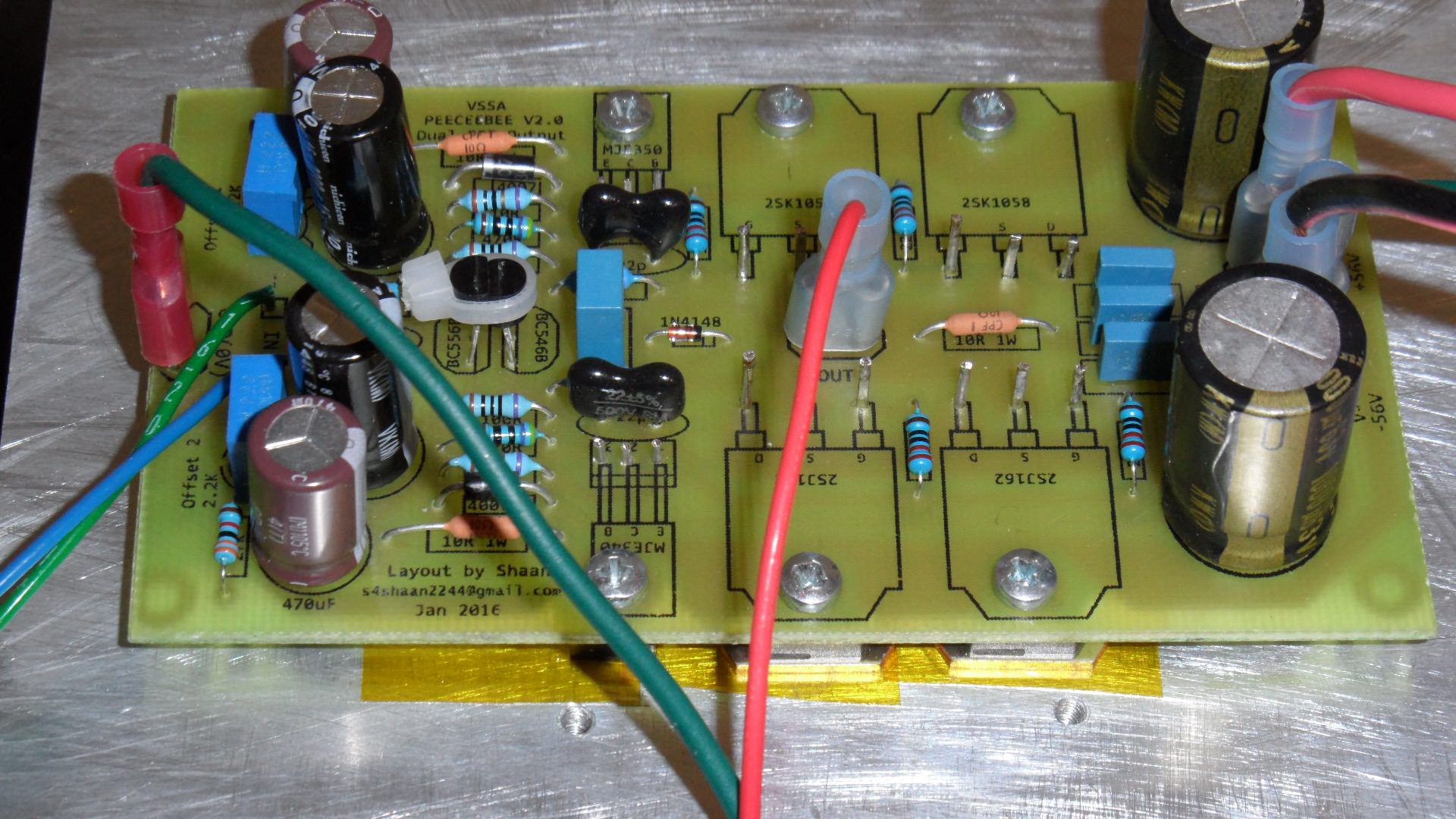

My Peeceebee, tested with 30vdc, It sound beautifully. Is it true that it don't need input capacitor? Thank you Shaan.
Great job!
If your signal source has an output capacitor or has less than 10mV offset then there is no need for an input cap on the PeeCeeBee. It has unity gain at DC so any dc voltage at input will appear on the output in-amplified (so a few mV input offset won't cause problem). And if your source is single supply based then a capacitor must be installed (usually all single-supply preamps have caps at their outputs)
edit- I don't see any insulation between the VAS bjts and the heatsink. Are these electrically isolated?
Ok i see this,nice pcb.
Thank you thimios and Jason.
Yes It is Jason layout, but has slightly different layout.
Great job!
Thank you Shaan,
The VAS Bjts are Fairchild which have plastic isolated tab.

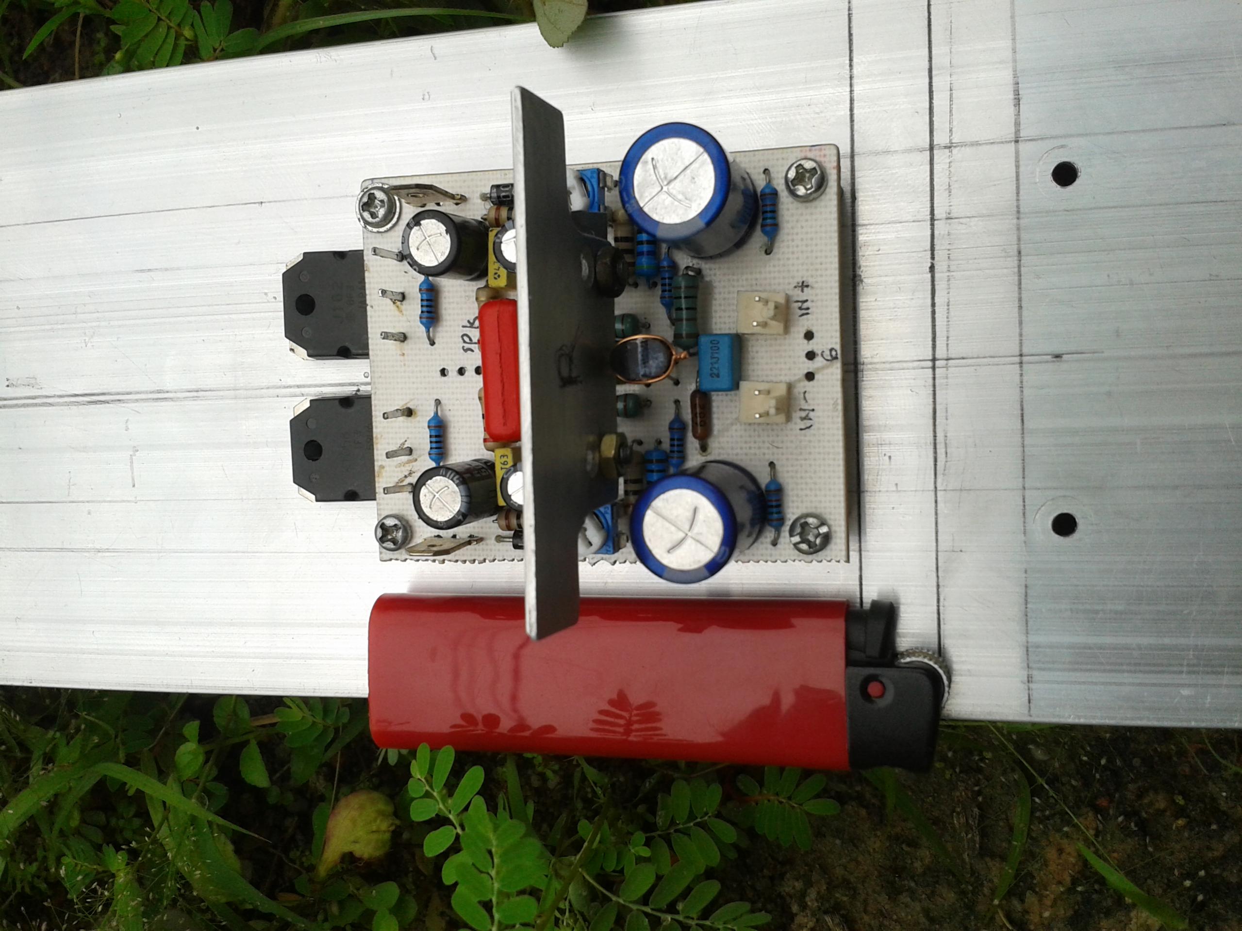

Hi Shaan,
I built a V2 as well. I really like it. Very simple to build, low parts count & cost. I used KSC2690A for MJE340 and KSA1220A for MJE350 as these are what i had. Running it at +-56V. As Terry would say, "Sounds Lovely" 😀
Very nice build.. Congrats.
new baby monster born !
*bc550c/560c swap to bc547c/557b, hard to find 560c here 🙁
*100pF swap to 220pF & 22pF swap to 33pF, use what i have in my drawer 🙂
*and also uses few of el cheapo 10% tolerance resistors
32vdc supply, 0.0-0.2mV DCO

Hello guzz!
You are right, the V1.1 is indeed a "Baby monster".
Congrats and enjoy the baby! 🙂

Hello guzz.
I see that you have built 3886 based amps before. How does PeeCeeBee compare to them sound-wise? Better? Worse? Same?
Thanks.
shaan
ermm... shaan sorry to say this (chipamp ers), this is my personal opinion, compare to my 3886... discrete much more better, specially in dynamics.. 🙂
it compared with my symasym, for this baby monster i have to build another decent supply for him 🙂
but even with just 3A transformator,4 x 3900uF and my old nokia phone as source... wow sound amazing, let see if i done with more decent supply and use cd player as source, power up as stereo... i believe 3886 will also lack behind 🙂
