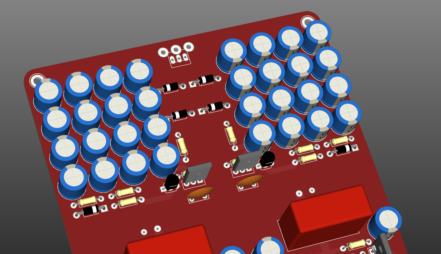

Is it possible that the diodes are printed with the wrong orientation on the pcb?
Just removed and traced them according to the schematic and it seems so to me.
I use a pcb from the first group buy.
Hi.
These diodes are in series with 100R each. In PCB the diodes and resistors switch places but their orintation and operation remain intact. Diodes are placed in the correct polarity, don't worry.

Changed the diodes to BAV21 and everything looks fine now!
As I used the previous ones on my V4 peeceebee, I assumed that it would be no problem.
Thanks Shaan for your support.
Errr... I have been using 1N4148 for all my V4 builds powered from 35V, and have never encountered such a problem, unless there was some problem with the diodes themselves, which I guess is what happened in your case.
I'm glad to know you got it working. BAV is totally fine in place of 4148.

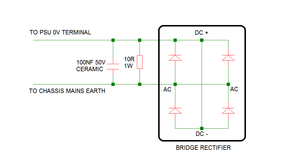

Ground breaker for my dual mono setup
Hi !
As I'm having a lot of spare time home these days (you know why I guess),
I've started working again on my PCBs.
One of them if completely populated and locked on its heatsink
and its PSU working well, but not both interconnected yet.
The PSU (Cresnet SMPS) doesn't have 0V and Earth connected, and I guess I should not get them interconnected with my setup.
I intend to build a dual mono enclosure, and I'm aware of the Earth / ground issue connection to the heatsinks.
Could you please provide a schematic of the ground breaker circuit I need for my setup ?
Did I make myself clear ? Thanks in advance

Hi Jean.
You can connect the loop breaker the way shown in the attachment. You can either use bridge rectifier modules or just four 15-20A diodes and make the connections as shown.
Be safe and bests.

OK, one more question: do I need TWO breakers (one for each PSU),
as I have 2 PSUs (dual mono setup) in my enclosure ?
Thanks a lot !!
JMK
Thanks a lot !!
JMK
Yes, one breaker is needed for each PSU.
