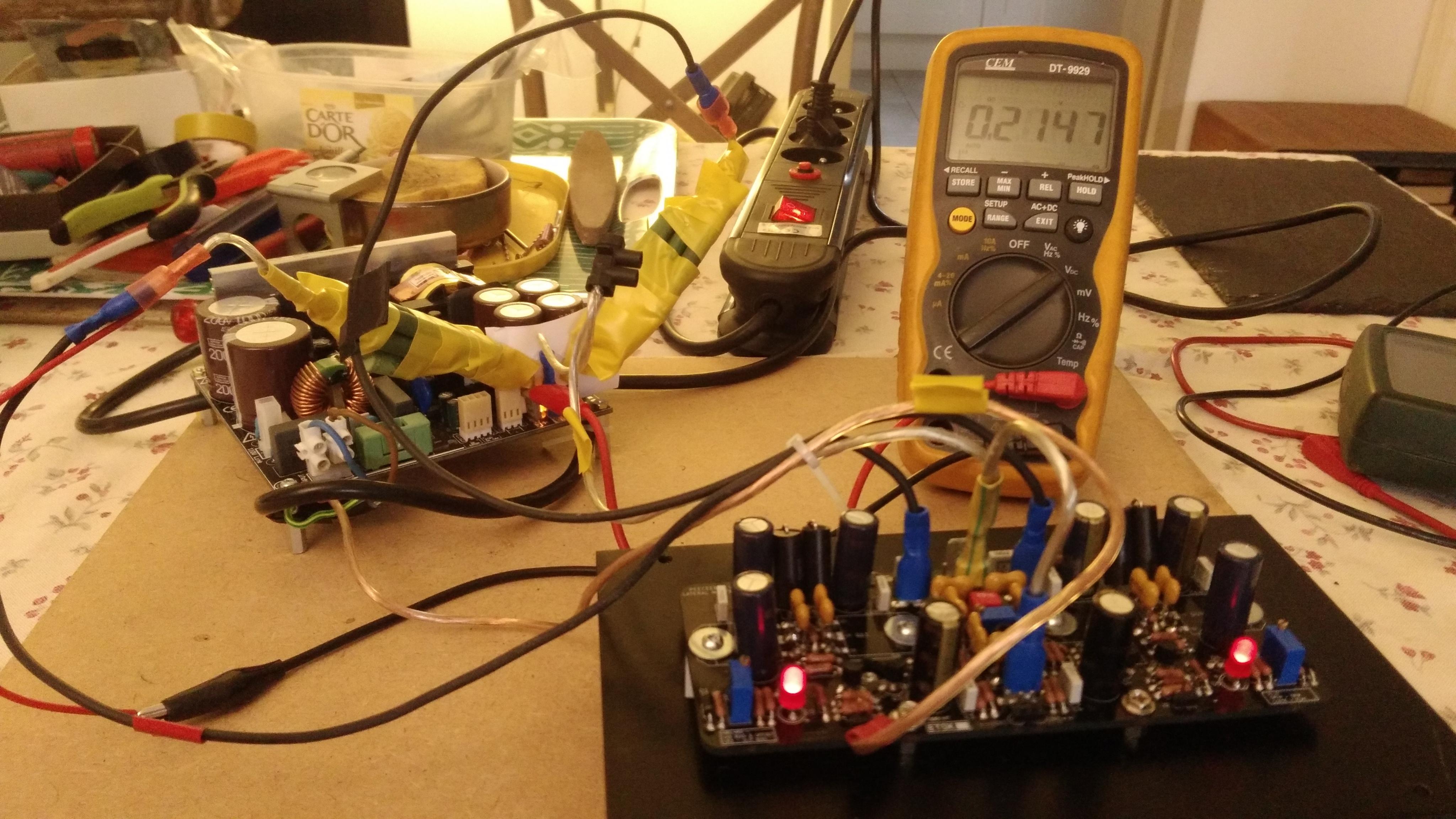

Mosfet bias brought back to 215mV
But it's heatsink is really hot after 15mn !!
My workbench's mess attached, no shame !

Thanks for the pic. With heatsinks lying flat it should get hotter than usual as airflow is restricted. All looks normal. :up:

It can be stabilised at any bias. But that bias has a direct relationship with cooling required. So one has to find it out in a given cooling situation.
If it is acceptably warm then 150mA is just fine. If it still gets too hot, then try 100mA.
