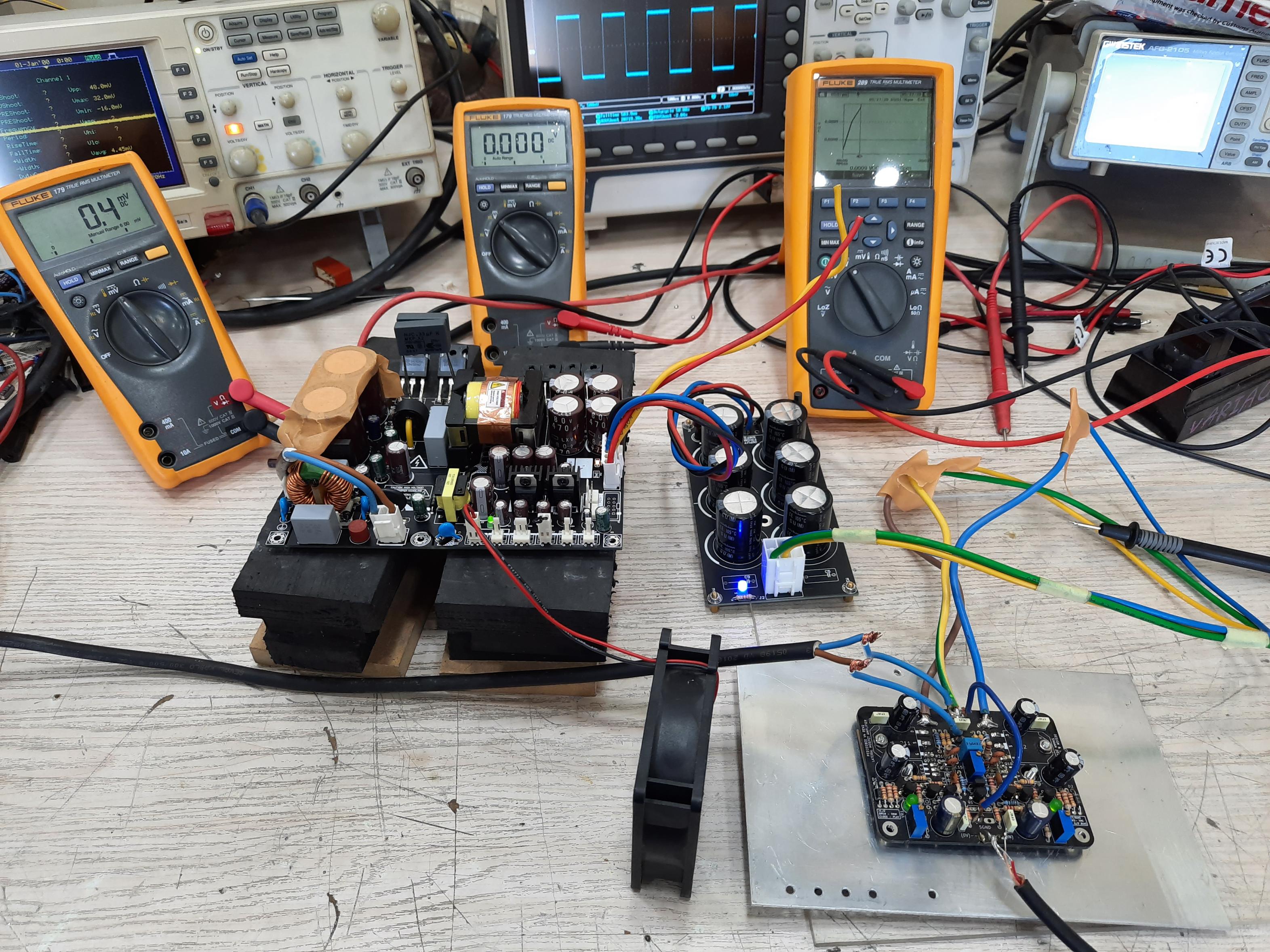

Hi !
Good news again, my 2nd amplifier board (that was seriously overloaded) is finally fixed and working like a charm.
I changed every semiconductor, had to solder some bjt legs directly on the tracks, it's not so nice looking but it's working fine.🙂🙂
JM

Thanks. I just did the VAS biasing, offset trimming and mosfet biasing as prescribed for a new setup, without any problem.
Everything stable and good values.
Now I also have a scope (2 channel digital and a signal generator), maybe look what square and sine waves look like ?
JM

Hi.
Glad to know they're both running.
Don't increase squarewave output beyond 5-10VPP or else the zobel resistors will overheat. If you plan to test the sinewave into clipping then don't let the clipped sinewave sustain for more than a couple seconds when zobels are on board, for the same reason.

I've been very careful. Last time I made measurements (and blew it 😕), I accidentally and unknowingly pushed the range button of my generator, and increased the signal by 20dB !!
The figures are perfect up to 100KHz and beyond, sine and square.
This is a wonderful amplifier.
Next step for me is to install the whole thing in its enclosure, I'm still waiting for parts here and there ............
Thanks a lot
JM

Advice for checking new boards after some "break in" ?
I don't think there is actually something like "breakin in" for an amplifier,
but now my 2 amplifier boards have been working for some time with my main speakers
outside their actual enclosure.
I'm working on the enclosure, changed some connectors etc, cleaned the whole thing etc
I think there is nothing wrong checking .........
What should I do ?
Simply check the offset on the output ? jumpers open or closed ?
Then check the mosfets bias using the 1R resistors (jumpers open or closed) ?
Anything else ?
Thanks for your advice !

Hi JM.
You can check the offset and bias without removing the jumpers, but probably much won't need a retouch.
