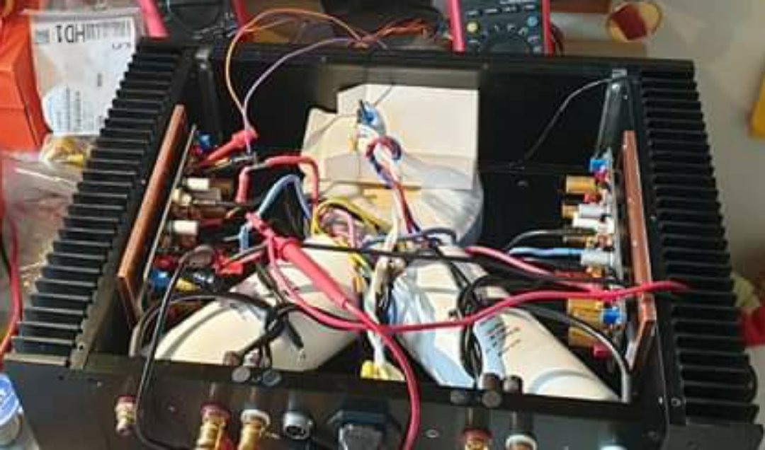

Problem with hum
Hi Shaan,
There is hum due to gnd loop when I have the amp directly connected to my CD (Esoteric K-03 SACD).
Same hum when I have only one channel connected. No problem with IPad or IPhone.
I use one transformer 2x36 V 500 VA and two 47.000 caps, common for both channels
And I have 2mm ceramic isolators for output mosfets.
Both heatsinks are connected to power supply's 0V ground.
Noticed that hum is less when I have gnd-loop breakers there.
Can I avoid these connections (The cables from 0 volt to heatsinks) ?

Hi Theodosis.
When using a metal chassis with heatsinks only one connection from 0V to chassis floor through ground loop breaker is recommended. After doing that you can remove the heatsink connections to 0V.

Sorry but I'm not sure that I understand this 😕 Could you please draw a scheme? I plan to use a ground loop breaker
See, the heatsinks are electeically connected to the chassis, right? So you don't need to connect each heatsink to power supply ground individually. Just one connection from chassis base plate to power supply ground will be enough. In that connection use the ground loop breaker.
Thanks, now I am sure I have understood 🙂

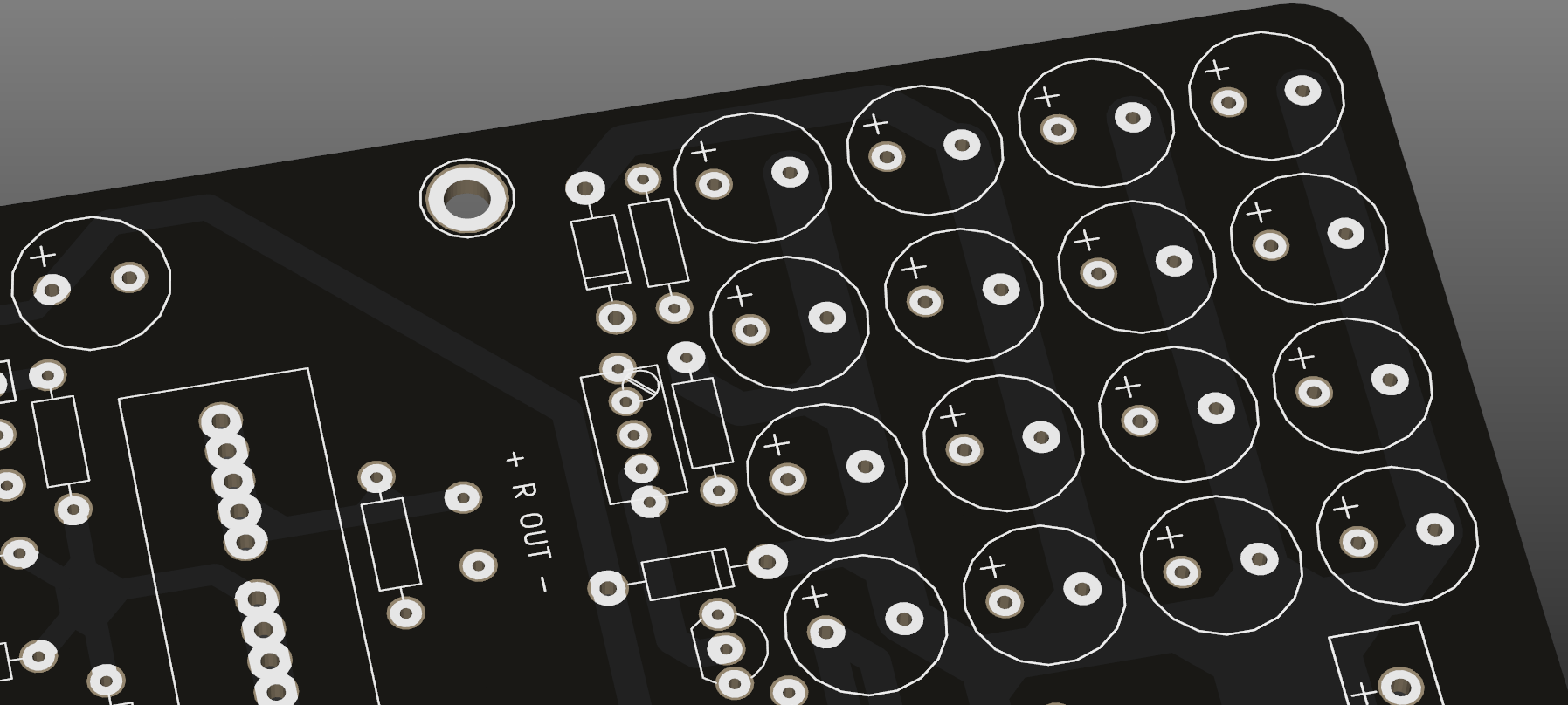

Preamplifier update:
Got an email from PCB fab that they're back into full production. So placed order for a couple prototypes for the upcoming peeceebee preamp. In a couple weeks will get them at hand. The board is quite large with the onboard power supply, about 170mm by 120mm. I didn't make it super compact like the amps so assembling will be easier (a few electrolytics will need to be soldered though (check attachment) 🙂). There will be some manual settings alike the amps, including fine trimming of the power rails.

Hi Shaan,
Done as suggested but there is no improvement with the hum.
Probably the ground loop is with the CD. The signal ground is connected to chassis in the CD.
So can I have the amp power supply 0Volt not connected to chassis ?
Hi Shaan,
Not connecting the amp power supply 0V to chassis may result into oscillation, so keep it connected.
You can try this and see if it improves:
Take a 10ohm 1/4watt resistor and a 100nF ceramic capacitor. Solder them in parallel. Intall this network in series with the SGND connection by cutting the SGND wire and soldering it in the middle. Do for both channel.
