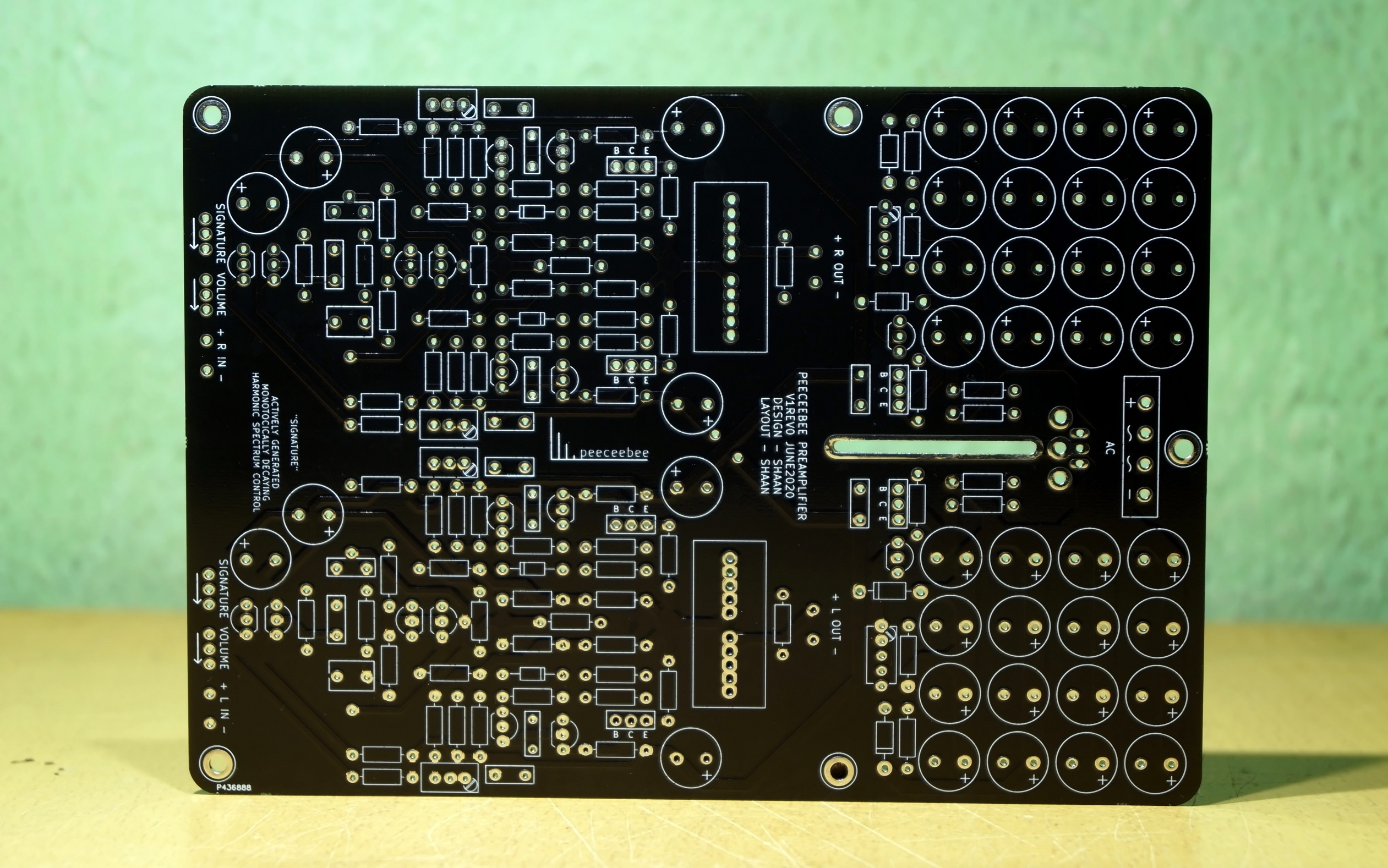

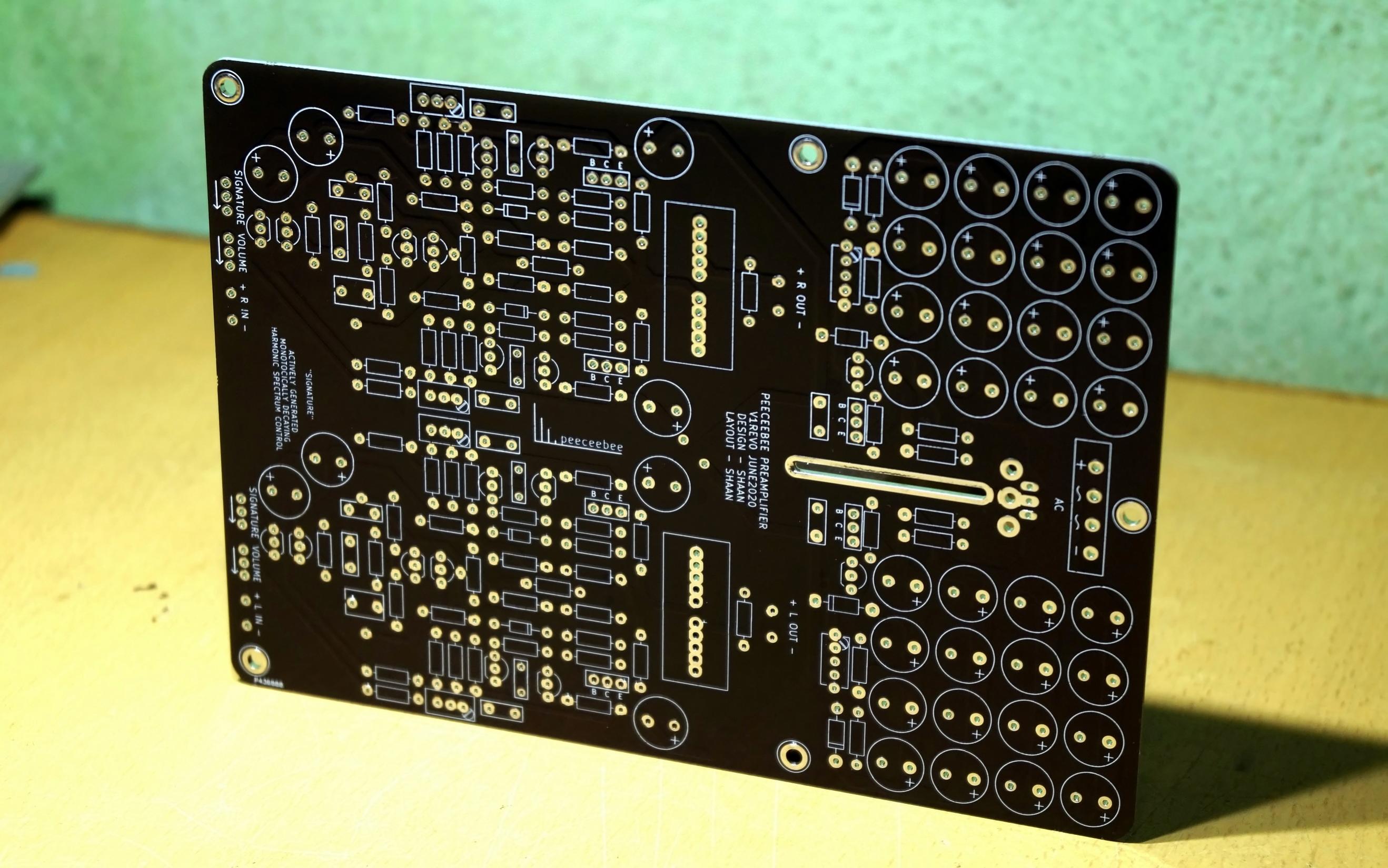

I will start a new GB for the preamplifier soon (probably by early July). All details will be posted there. I will post an update here as the thread goes online. 🙂
Looks very nice Shaan😀
I like your “signature” control. This should be fun!
Thanks.
Yes, it is fun. It allows to vary the feeling of the music as per one's taste, mood, time of day, season, source material, speakers, amplifier and so on. 🙂
At one end of the knob it can make the system extremely transparent with about 0.0001% minimum distortion, and at the other end it can make it extremely warm by masking the system with about 1% maximum distortion typical of low powered SE Class A amplifiers. One only needs to find the positions of the knob that sing in harmony with the rest of the system (which will vary from one listener to the next) - i.e. a truly personal preamplifier.
As you would have guessed, there is a sweet spot in this control for (I think) every moment, mood and music.
p/s:
Did I tell you that it is also a fantastic headphone amplifier?
