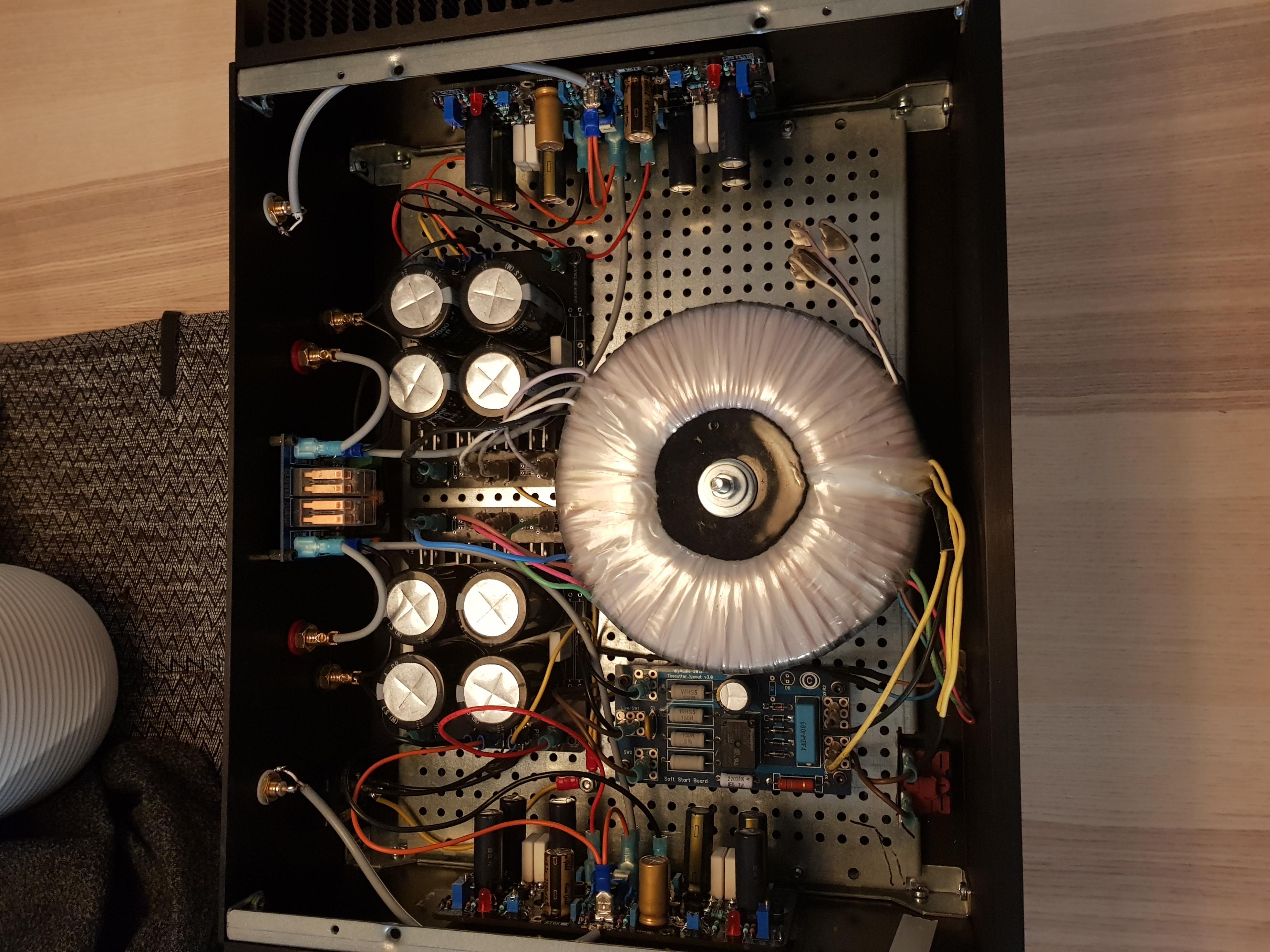

For comparison you can see my linear PS with old Hegel(norwegian amp brand) torroid. My cabinet is quite full, and it looks like we have the same from modushop. For my next AB build I will try SMPS. Still have a krell ksa50 to complete tho... 😛
My V4H has been rocking for 1 year (after stability was fixed) and Im very happy with it!
Thank again shaan for sharing your design!

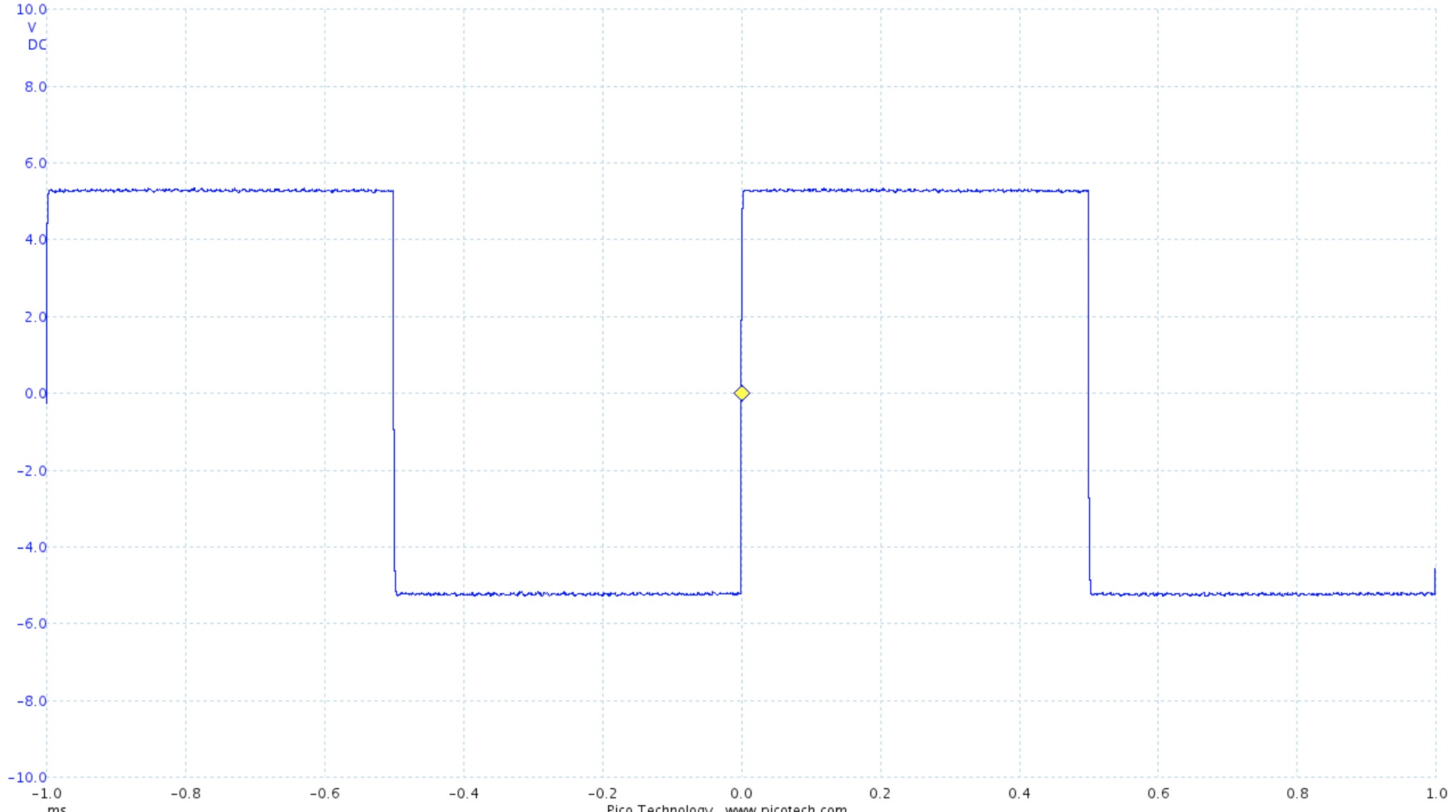

Just a quick and small measurements.
1khz, 10khz and 20khz squarewaves into a 6.8ohm load.
Only a 12bit picoscope used.
