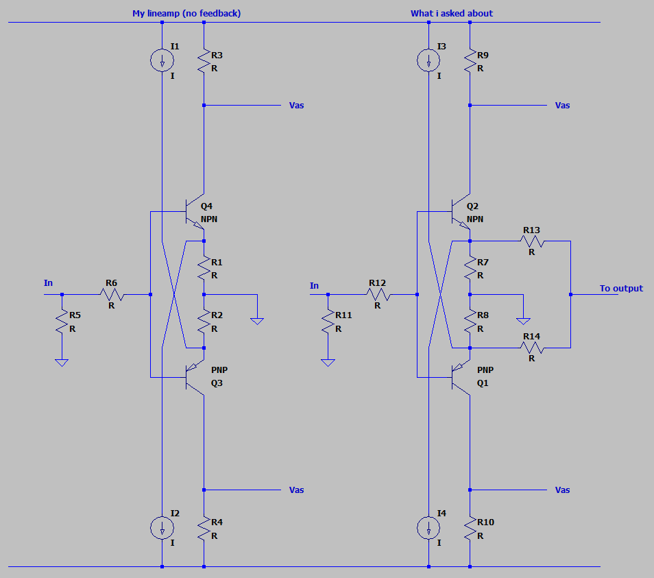

You are using almost the same input I used in my line amp many years ago ( no diamond ). Mine however, is dc coupled. And I was wondering if you have tried your amplifier without capacitors c3,c4,c9,c10?
In my line amp, these would be shorted directly to ground ( they where actually never there in the first place ), and the css's Q7 and Q8 would draw their current from the other side of the two 100 ohm resistors R3 and R4.
Q7 and Q8 then need to draw additional current because the input transistors do not open before the voltage across R3 and R4 go beyond ~0.6 volt.
Meaning the css's should draw an additional 6 mA. I also use a servo to balance my css's for zero offset.
Does my question make sense?

Hi Jorgen.
Does either of the two designs in the post (#2) linked below look similar to the design you mentioned?
simulating-building-simple-symmetrical-amplifiers-post2
If yes, then there you have it. This design works pretty well, but due to high sensitivity of the input pair to temperature changes a servo is needed, as you mentioned. With the capacitors installed there however, offset is very tame even if the input pair is not thermally coupled to each other.
Hi shaan
I'd say the left one is close. I drawn up a quick sketch. To the left it shows how my 25 year old line amp works. To the right it shows what I was asking.
Regards
Jørgen
