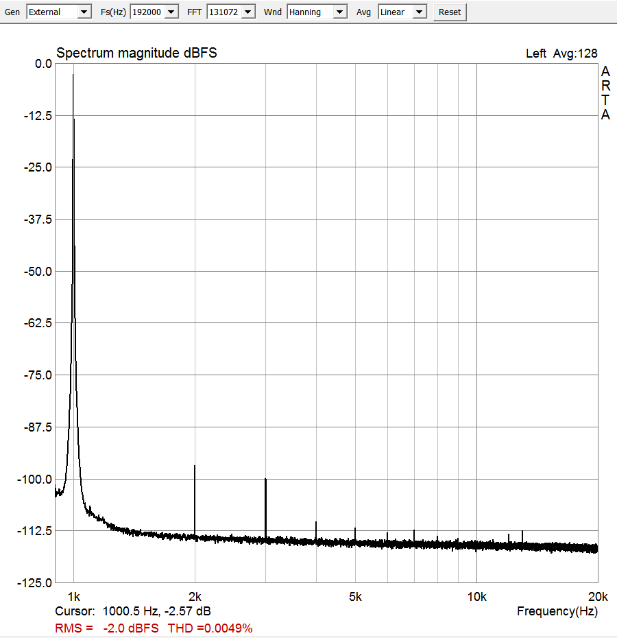

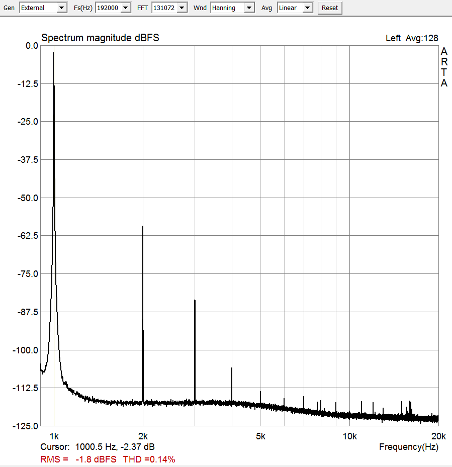

Preamp Update!
Real world tests have been done on the preamp. There is an additional knob besides the volume knob. It varies the harmonics between the two extremes shown in the attached pictures. Looks fun? 😉
