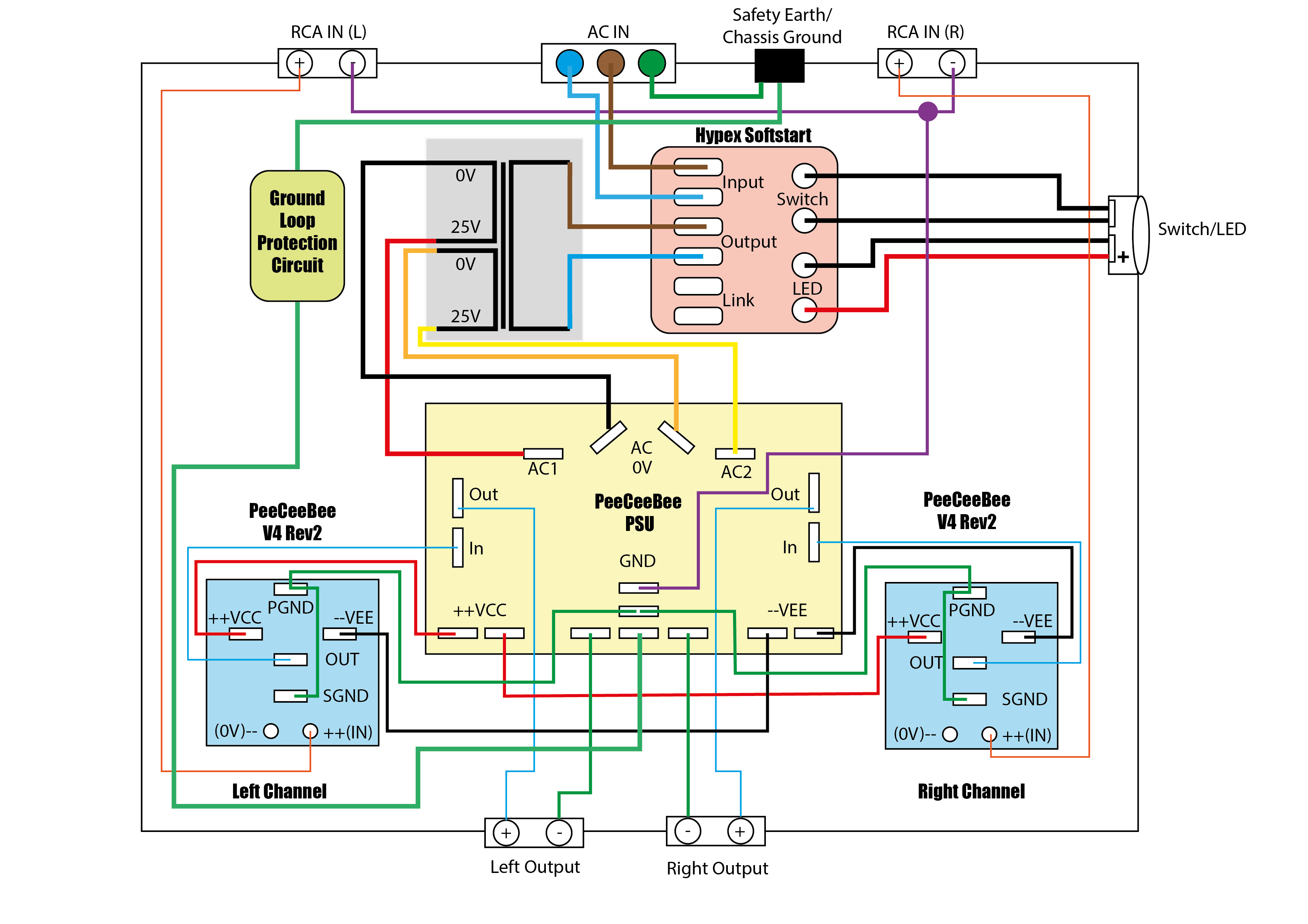

PeeCeeBee V4 GB!
Image attached as it wasn't included in the last post. I've also updated it to include the connection of the IEC earth to chassis ground as per Loafimus's suggestion.
Does it all look correct now?
I would put your RCA grounds going to PSU ground and not the chassis. I would go from PSU ground to chassis ground and put a CL-60 between PSU and chassis. This is to separate your audio ground from your dirty chassis ground, but have it available in case it's needed.

IEC earth to chassis earth. I did some reading on this, both on this forum and links provided and came away none the wiser really. I read in a few places that the IEC earth should be fixed to the chassis and that it should be the only thing connected at that point (in my chipamp I had the chassis ground connected to the earth). That's why I put the chassis ground from the PSU on a separate connection. I don't understand the rationale behind this if they're both connected to the chassis though. This aspect just confuses me.
This is explained also in that presentation. From my understanding, you only want one chassis ground point to prevent ground loops.

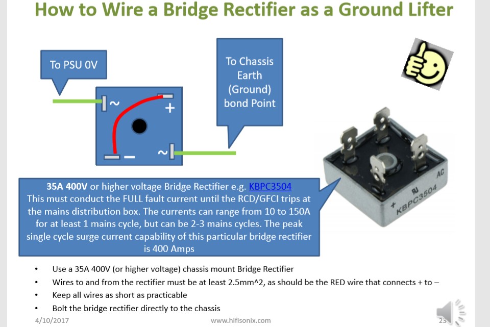

Thanks, just checking we were talking about the same thing. I have read these again and understand it now. There is a PCB for the ground lifter as described by Rod Elliott in this article, part way down the page A Complete Guide to Design and Build a Hi-Fi LM3886 Amplifier - Circuit Basics
I've just priced it up and it's £6 for 10 so I'll order them.

Thanks again for your input. I have read that and am understanding it a bit more now with everybody's help. I did note though that it has a different way of wiring the ground lift compared to Rod Elliotts in the earthing article(see attached image).
Again, many thanks to everyone for their help and patience, it's been a bit of a steep learning curve for me working on this amp.

I've made what I think is my final layout block diagram, so thanks to Loafimus, JLS001 and of course Shaan for helping me along.
On the diagram, I've connected the RCA input grounds together and routed these to PSU GND, which then exits the PSU through a ground loop protection circuit before connecting to the chassis at safety earth.
I have a further question regarding this layout. If the RCA input grounds go to the PSU GND, what is the point in having the --0V input (gnd) on the amp? It's not meant as criticism, I just don't understand.

... If the RCA input grounds go to the PSU GND, what is the point in having the --0V input (gnd) on the amp? It's not meant as criticism, I just don't understand.
Cheers
Neal
The 0V at input is signal ground. The shield of the input cable is supposed to connect to it. In case there is a ground loop problem in a stereo installation, this technique of leaving 0V unconnected and shorting the shields and routing directly to ground can help lower the noise. In dual mono and monoblock setup this technique is not necessary as the two channel do not share the grounds except at the signal source and a local induction loop can not form in the input shield between the two channels.
One has to keep in mind that as long as a shared ground is used with or without breakers, there will be a local induction loop as soon as the far end of the input cable shields touch one another (which is normally the case when a source is connected). This loop is different from the typical GND loop that happens through mains earth when source and amp share the same mains earth without any breakers. It is also one of the oldest problems in stereo amplifiers sharing one PSU. The noise it injects into the input depends directly on transformer's leakage EMI and distance of the loop from transformer. It can also be frustrating at times; I have seen chipamps where there is hum from speakers when the two input RCA far ends are not touching, and as soon as they are touching the amp goes into pin drop silence, and no there is no loose connection!
