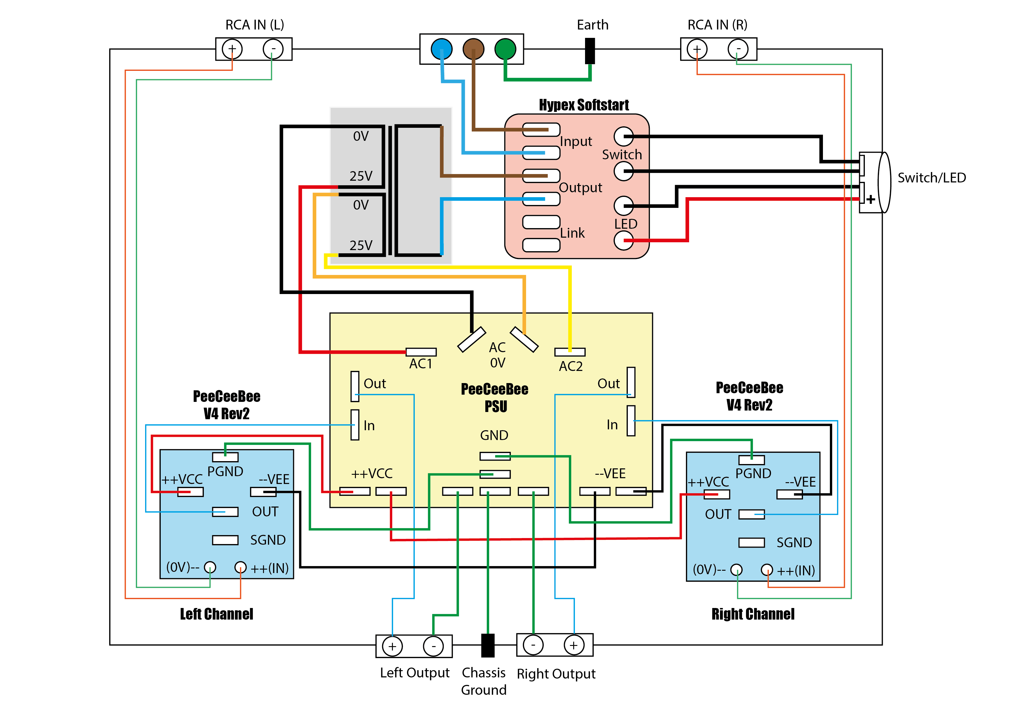

Help with wiring
Hi all,
I need some advice about wiring everything up together.
I'm very much a novice and I've largely followed instructions in the past, or have managed to work things out for myself which haven't been explicit, but I'm a little uncertain about putting this amplifier together.
In addition to the V4 Rev2 PCBs, I'm using Shaan's PSU and a Hypex softstart which can also incorporate a vandal proof type LED power switch, which I plan to use. Would somebody please be kind enough to go over my block diagram of the wiring to see if I've made any mistakes? I'm also unsure of where the signal ground from the amp is supposed to connect to.
Any advice much appreciated.
Cheers
Neal

Pretty much the same setup I did.
You'll want to put a jumper from SGND to PGND, then from PGND to the GND on the PSU.
Also, your IEC earth should go to Chassis Ground.
I'll be interested to see if you have any hum in your amp wired up like you do in your diagram. I ended up with a bit of hum and the biggest help was tying the two RCA in grounds together. I also added a CL-60 thermistor to split the PSU GND from the chassis GND.
Just a suggestion, but you may also want to add a mains fuse in there before your soft-start.
Hi Loafimus,
Thanks for chipping in.
With regard to the jumper from SGND - how do you do that with just the one tab - do you put two wires into one faston for example?
I have a mains fuse in the IEC connector, but thanks for the check.
IEC earth to chassis earth. I did some reading on this, both on this forum and links provided and came away none the wiser really. I read in a few places that the IEC earth should be fixed to the chassis and that it should be the only thing connected at that point (in my chipamp I had the chassis ground connected to the earth). That's why I put the chassis ground from the PSU on a separate connection. I don't understand the rationale behind this if they're both connected to the chassis though. This aspect just confuses me.
Sorry if this seems a bit basic, but can you explain what you mean by tying the RCA grounds together please? Do you mean running a wire (jumper?) between the tabs of the RCA sockets? What happens at the amp pcb ends?
What does the CL-60 thermistor do in your setup? I used a thermistor in my chipamp but that was for inrush suppression.
Apologies for so many questions after you took the time to help. Please bear with me.
Cheers
Neal
@NealJ: you can bundle two PGND ground wires into a single faston.
Except for your Hypex softstart which I'm not familiar with, your wiring diagram looks good.
PGND to SGND on the V4 board can be jumpered. I connected a second ground wire on the faston of PGND and jumpered the extra wire to SGND.
For ground isolation check out Rod Elliot's circuit. Additionally I have used Rod Elliot's DC blocking circuit for "live" lead of incoming AC supply for V4.
The PSU is Shaan's PSU. Do read up the instruction sheet in the PSU GB post#1 regarding which rectifier diodes to use (and not to use) depending on whether your transformer is center tapped (4 diodes) or dual secondary (8 diodes). There is also jumpering to be done in case of center tapped.
Assuming you're using a shielded balanced cable between RCA socket to amp input, extend the shield at RCA socket end and screw/solder it to chassis. At amp board end shield stays open and unconnected. The rationale for this is to break any ground loop that may be present in your audio signal path.

Understood, thanks. I can see it in Loafimus's photos now I now what to look for!
Do you mean the loop breaker circuit? Just to be clear, it's OK to connect the ground from the PSU to the earth safety on the chassis? I got the information regarding using a separate connection to the chassis for the PSU ground from figure 2 on Rod Elliot's site: http://sound.whsites.net/psu-wiring.htm

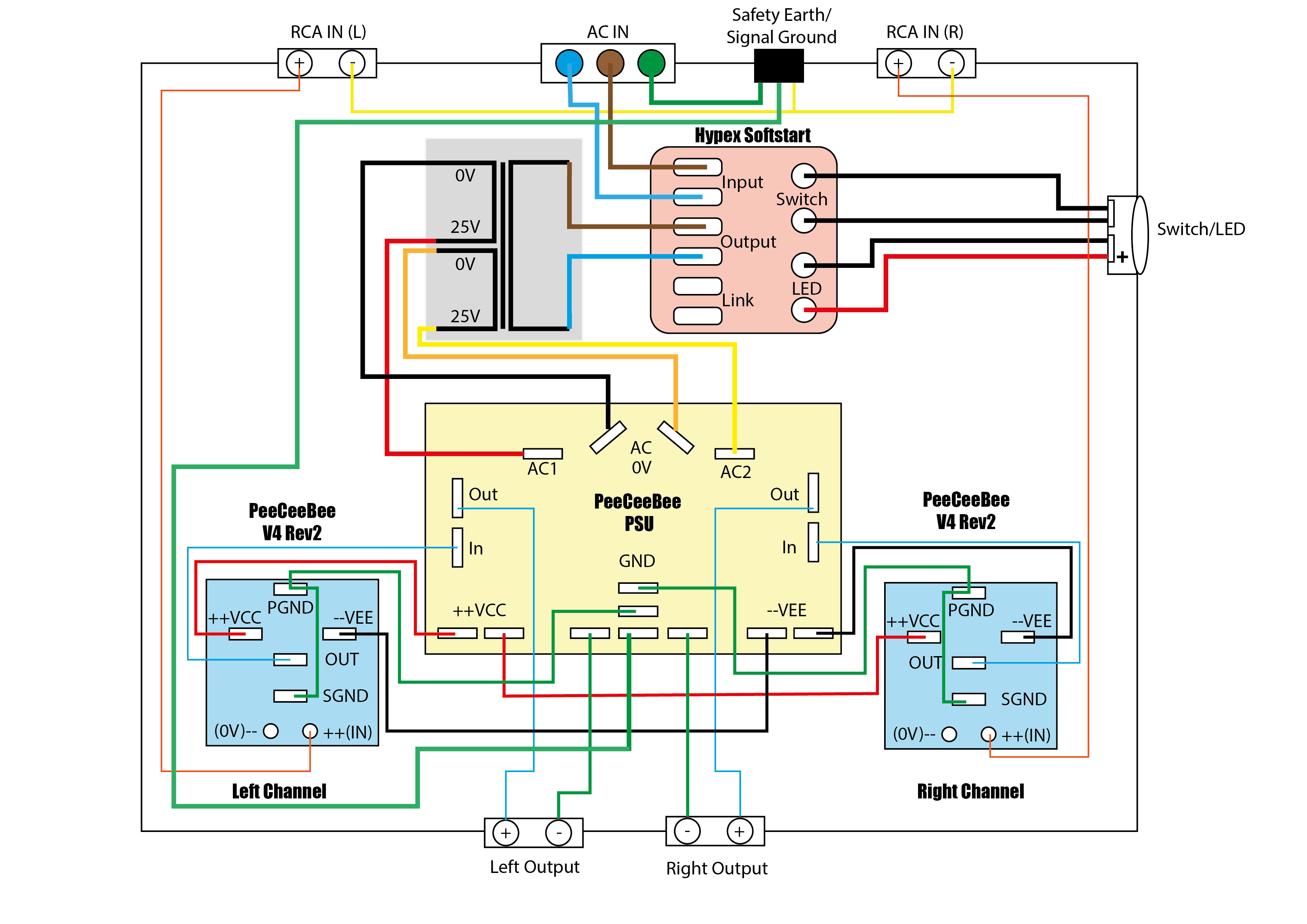

I think I've got this now then, does my updated diagram accurately represent what you are suggesting? I don't actually need to do anything with the shield of the coaxial cable?

Image attached as it wasn't included in the last post. I've also updated it to include the connection of the IEC earth to chassis ground as per Loafimus's suggestion.
Does it all look correct now?
