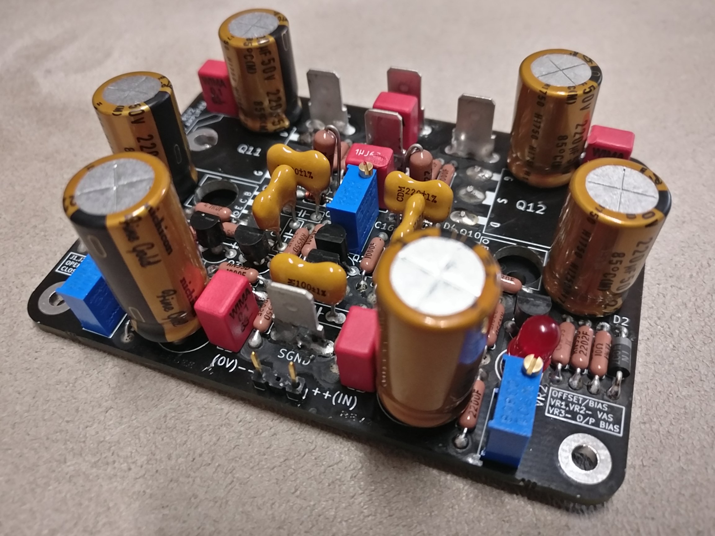

Very nice build Loafimus, congrats. I don't think mine will be so neat.
I just finished the 2 boards, it was a lot work! Hope I didn't make mistakes. I can't test them right now, because I didn't have mica insulation 🙁

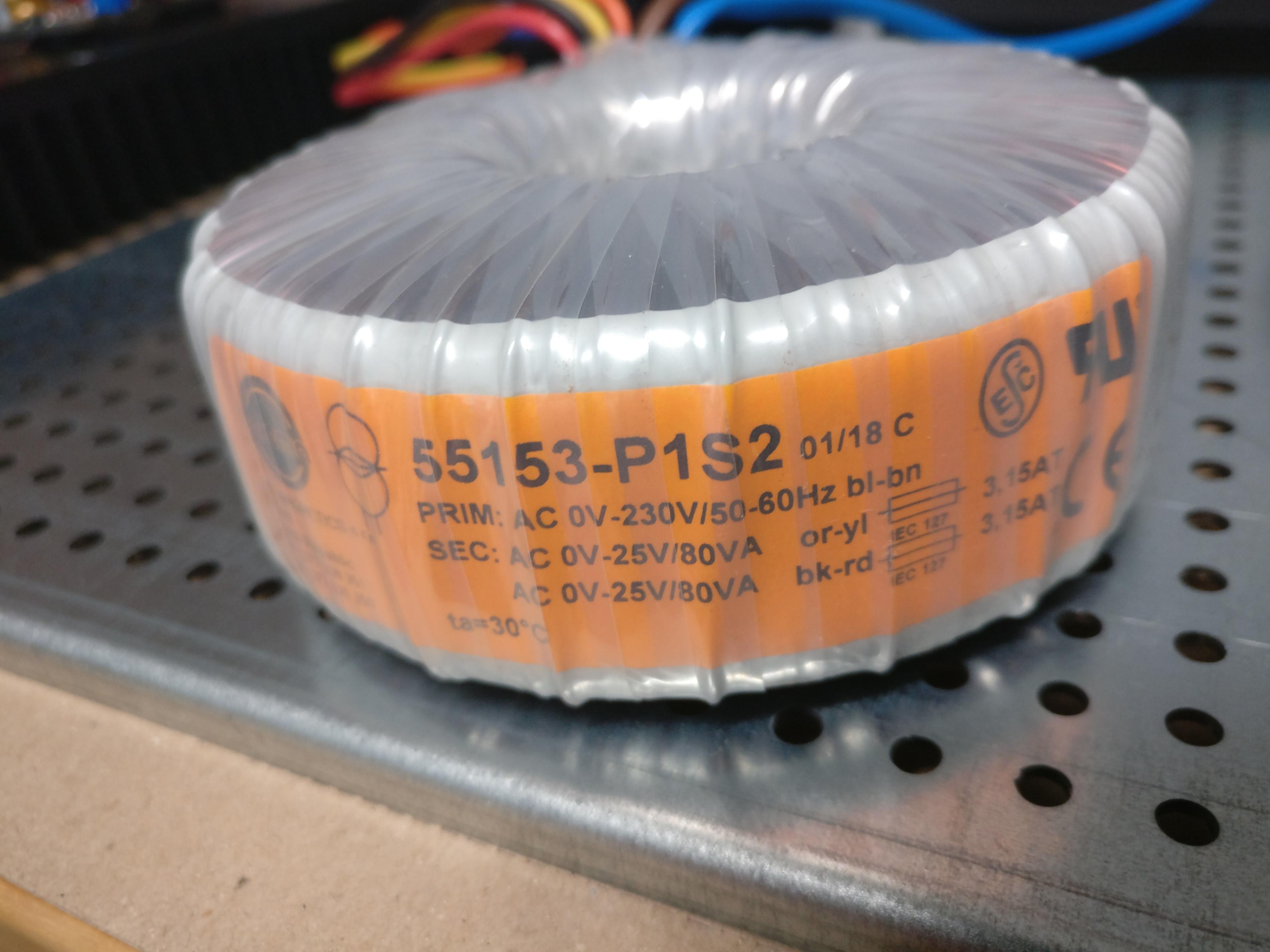

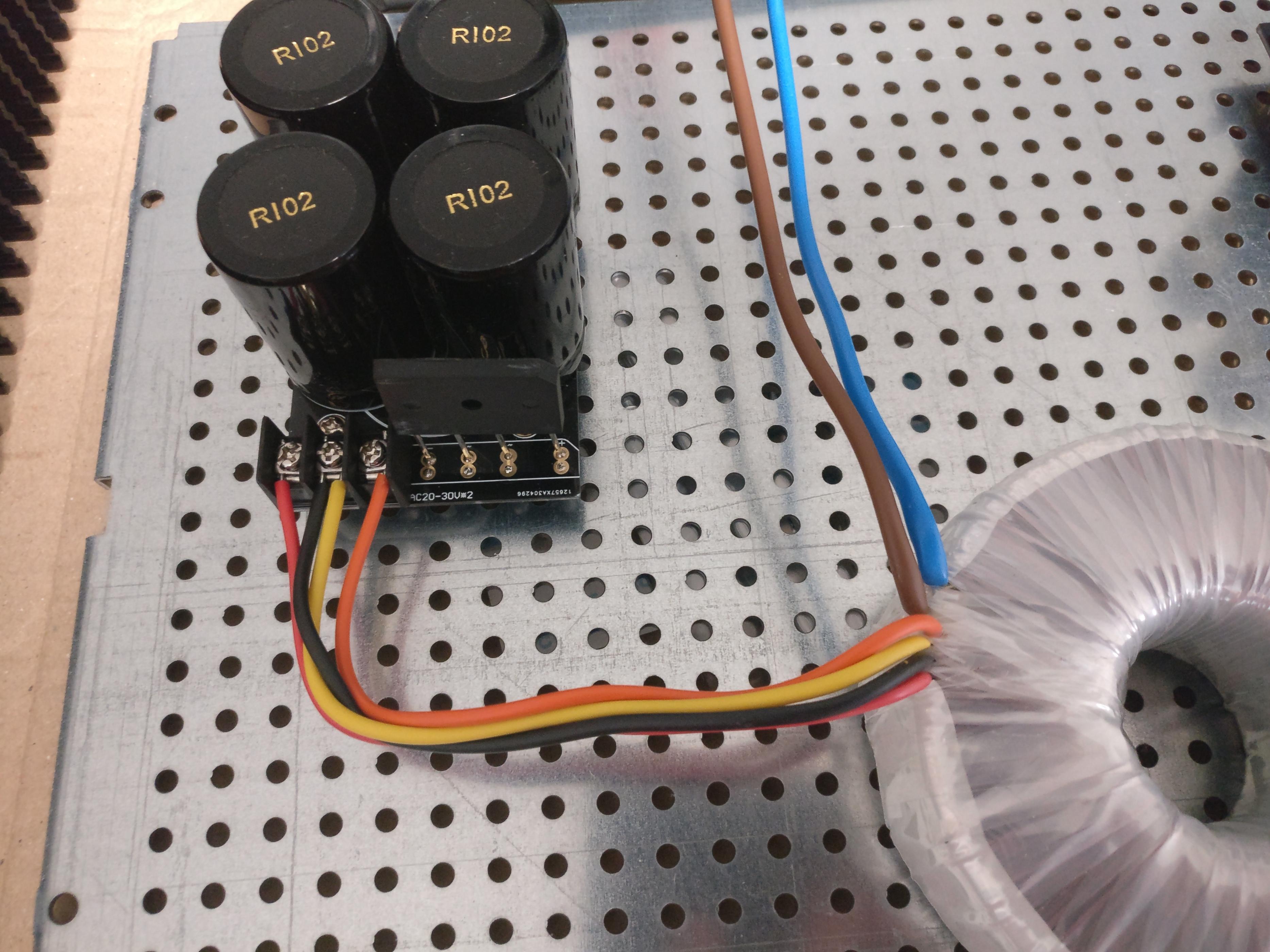

I have a doubt about connecting the transformer with the PSU.
PSU have 3 connectors ac / gnd / ac and my transformers have 2 secondaries. I've connected this way (see attachments)
Is it OK?

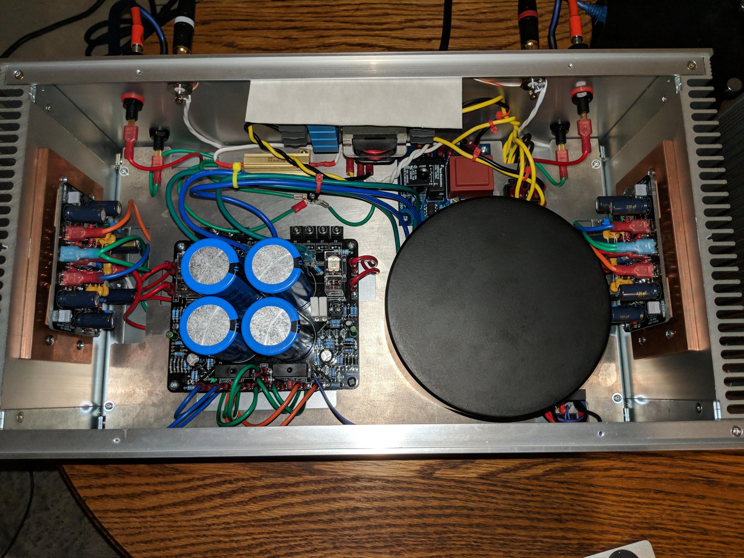

Just a quick update.
I solved all my minor hum problems! The three big things I did:
1. Tied the grounds of the RCA inputs together. This made the most drastic change and basically cut the hum in less than half.

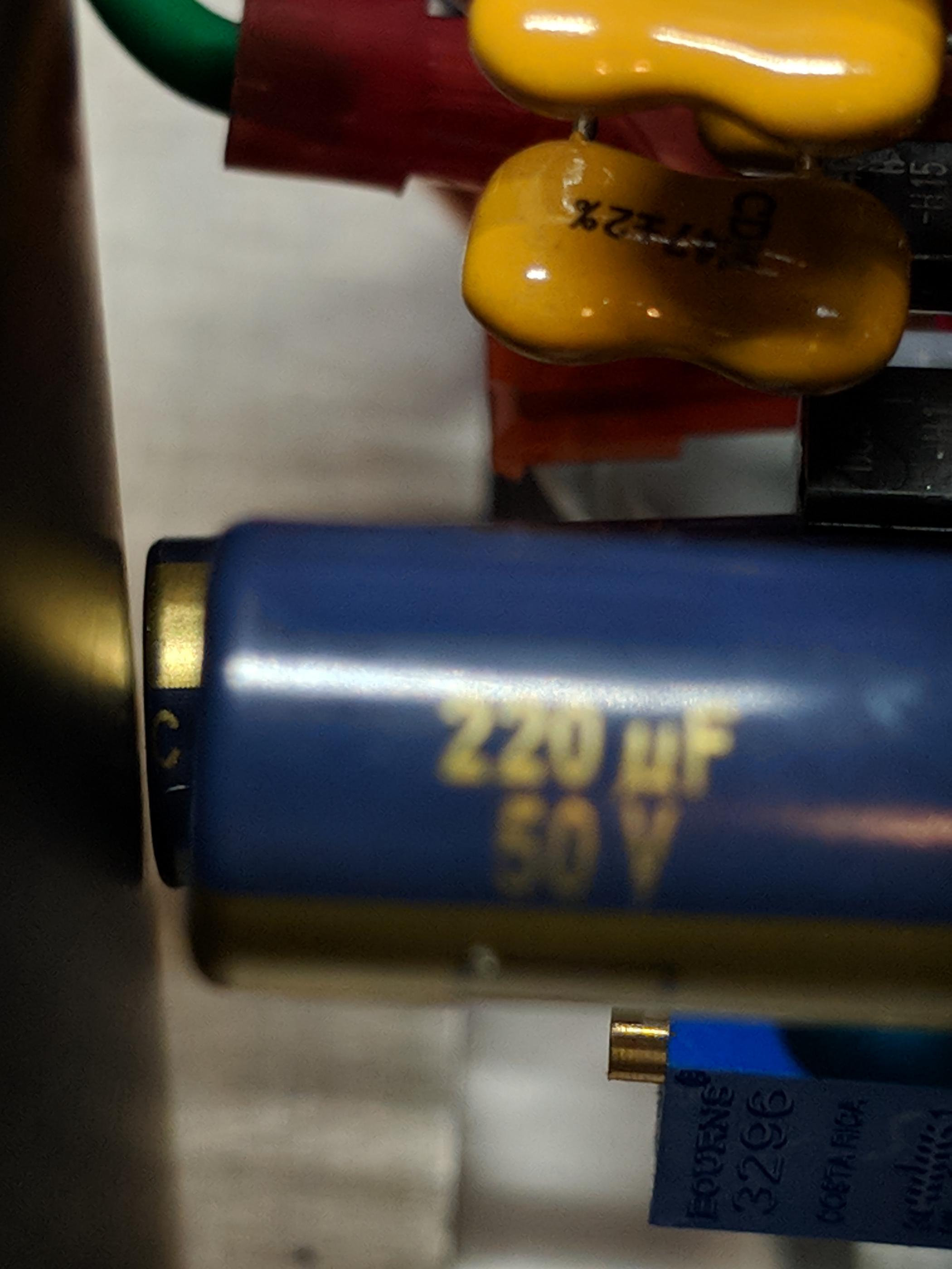

2. I swapped out the transformer with the 300VA 25V shielded Antek with the steel cover. It was a tight fit, the attached picture shows how close the steel cover was to the cap. This basically made it where I had to put my ear to the tweeter to hear a feint hum.

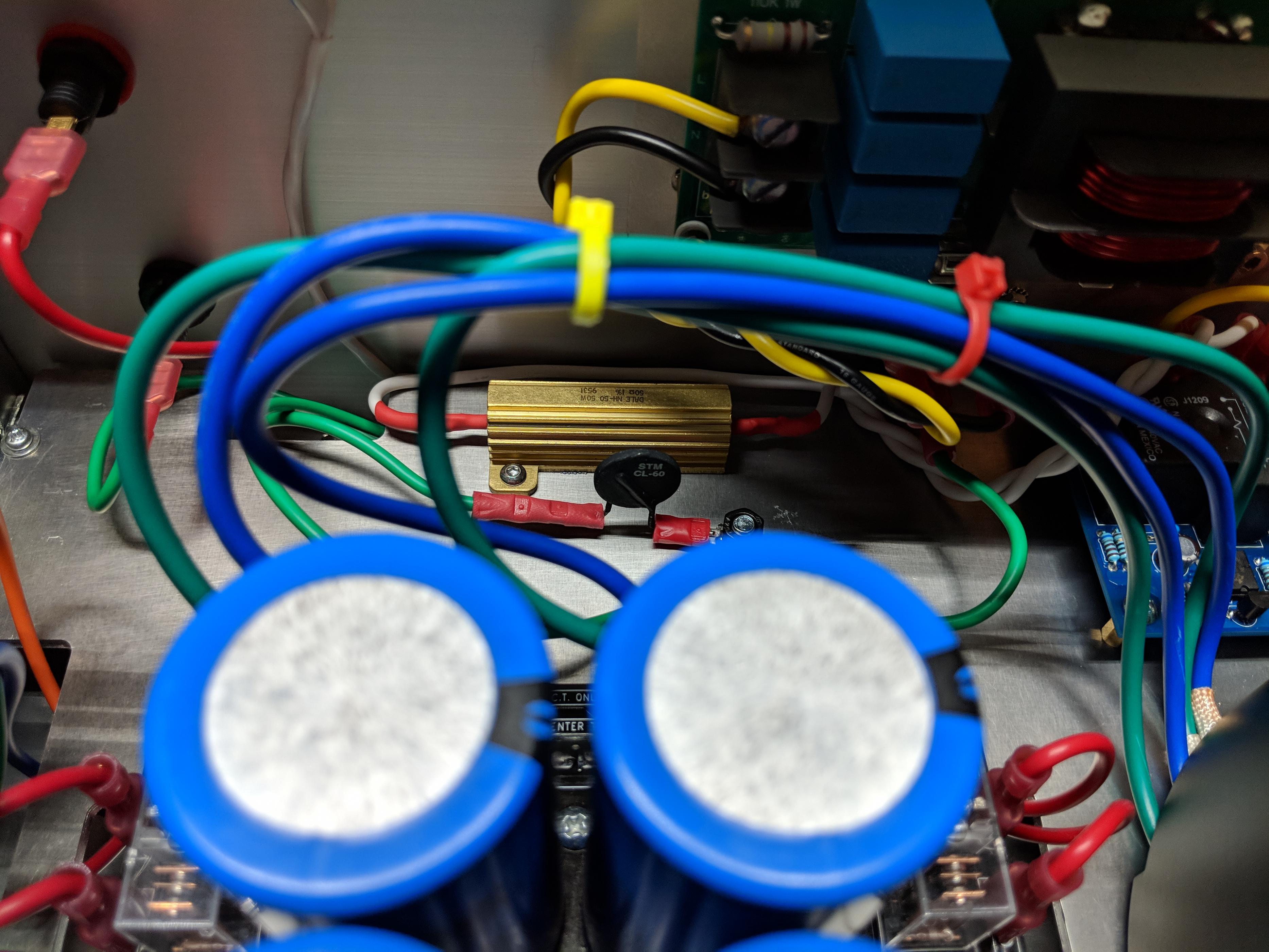

3. Put a CL-60 Thermistor in between the PSU ground and star ground. After this, it has to be dead silent in the room with my ear to the tweeter and really looking for noise.
The amp sounds great, is dead silent, and I couldn't be happier.
