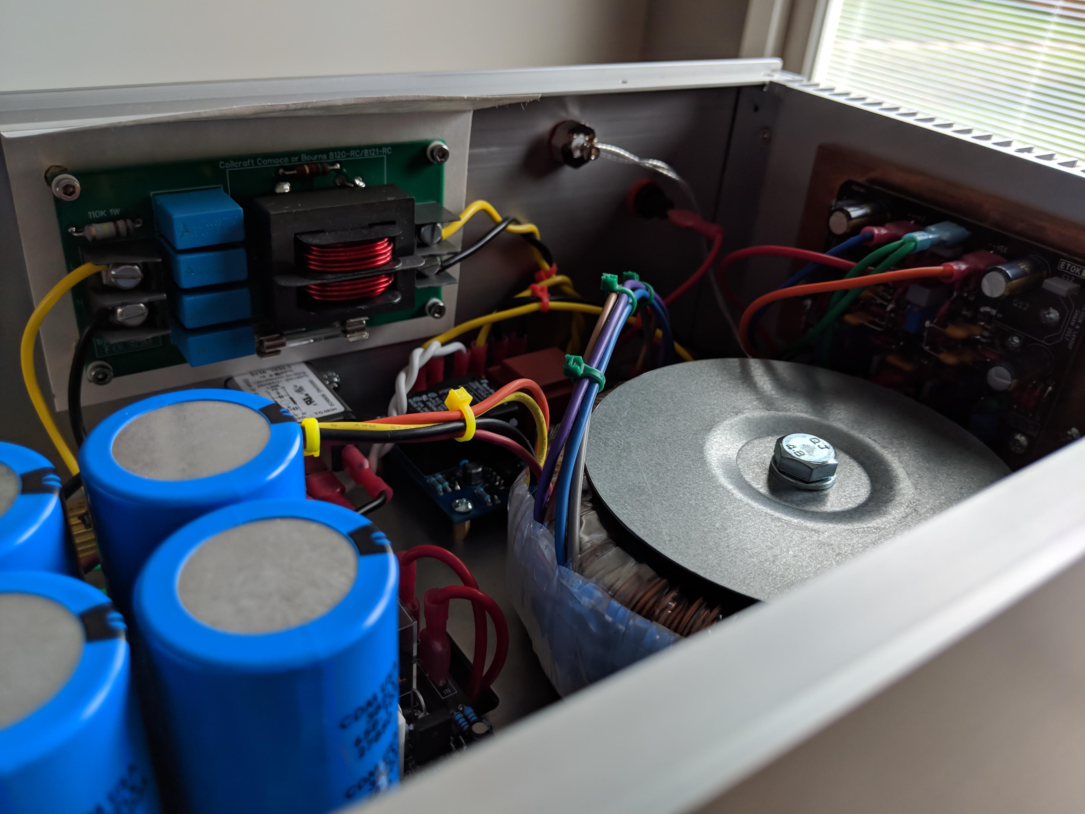

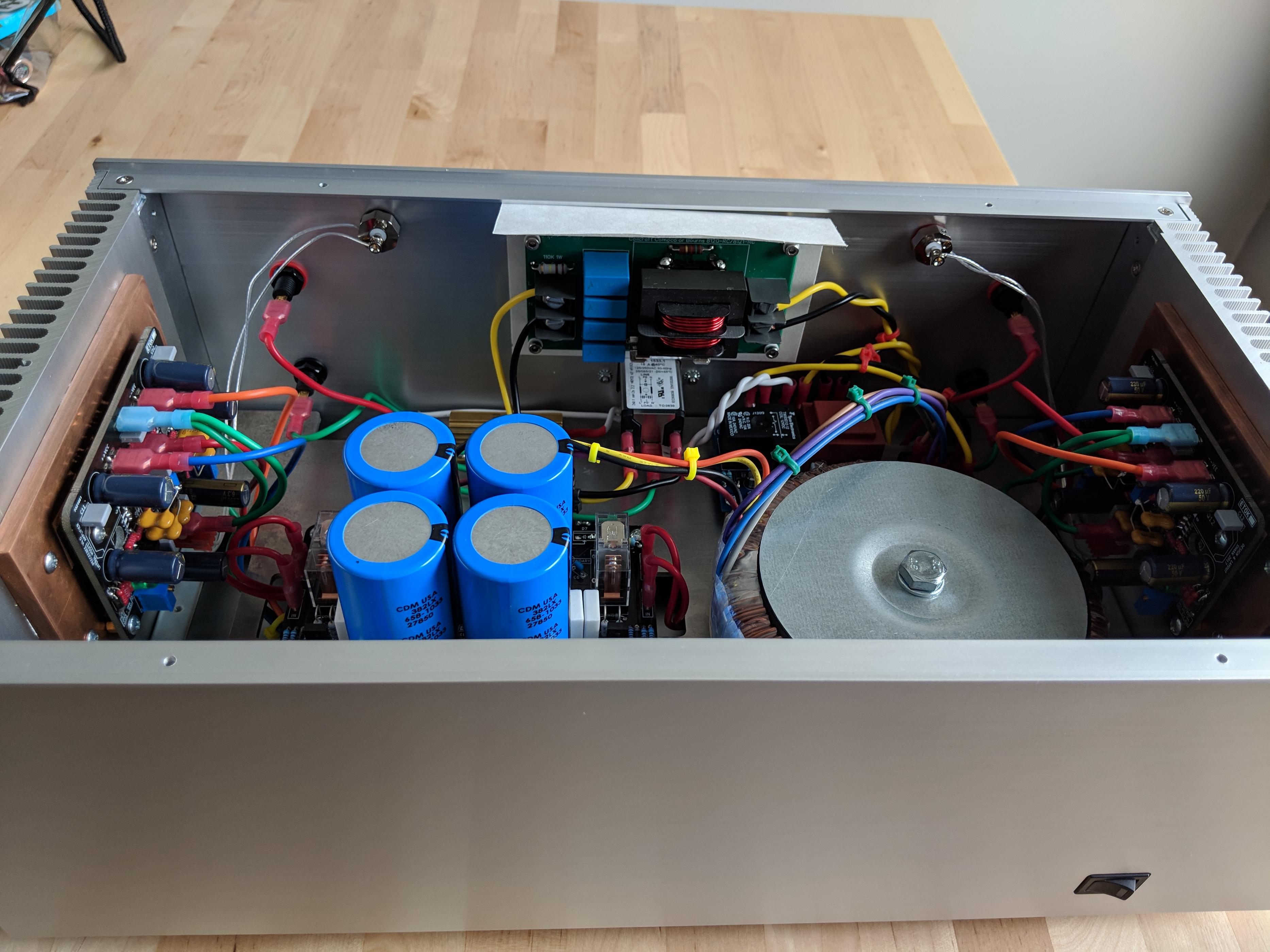

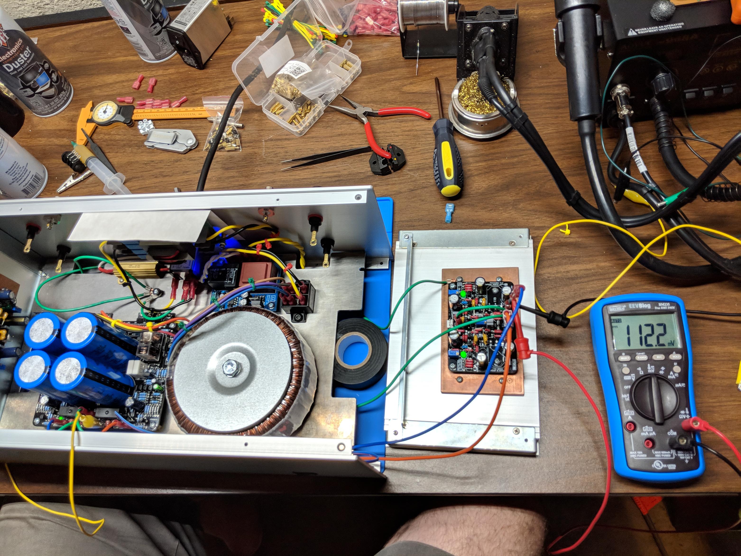

Finally got the V4 all buttoned up and singing! Haven't done any critical listening yet, but from the little bit I've sat down with it, I'm impressed. I don't think my ZRTs have ever pumped out bass quite like this yet.
I ran into some grounding issues with the inputs and I'm getting a bit of radiation off of my transformer as it's humming a little bit. I'm considering doing an Antek 300VA 25V that is shielded to see if it helps, but it's barely noticeable as is unless you're looking for it.
I've attached a few photos, but here is the full build album including some fancy CNC work by gtose. Luckily he was born my brother and I get to abuse him as much as possible:
Peeceebee V4 Class AB Amplifier - Google Photos
Along with the V4 (modded to Rev2), the build includes Shaan's Peeceebee PSU and Speaker Protection. Folsom's EMI filter is used along with a soft start from eBay.
Edit: I should mention, the fix I had for the ground buzz was to tie the two RCA input grounds together. This eliminated most of the parasitic noise. I was only getting the noise when an input is connected. If I short the inputs, it's dead silent. If anyone has any ideas to further silence the amp, I'll give them a try.

Looks great Loafimus!!
You’ve got a lot of goodies packed into that chassis. I’ve had very good results using the Fo-Felix.
Looking forward to hearing about your listening impressions.

Hi Loafimus!
AWESOME BUILD!!!!
Glad you liked v4's lows. I hope you will like the rest too. 🙂

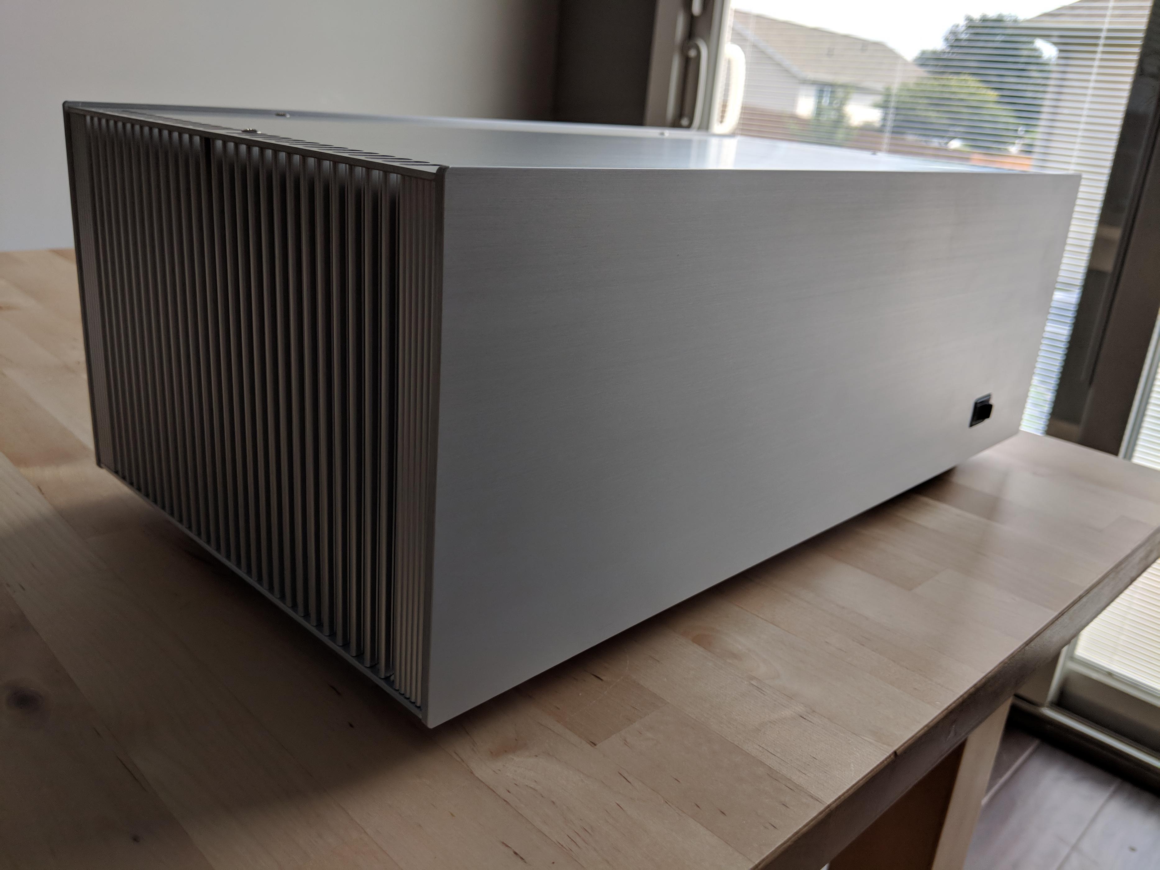

Happy to know that V4 is your first discrete amplifier and you liked its sonics!
You've given v4 a really nice looking cab! I hope the amp stays with you for a long time to come and keeps your musical sessions fresh.
