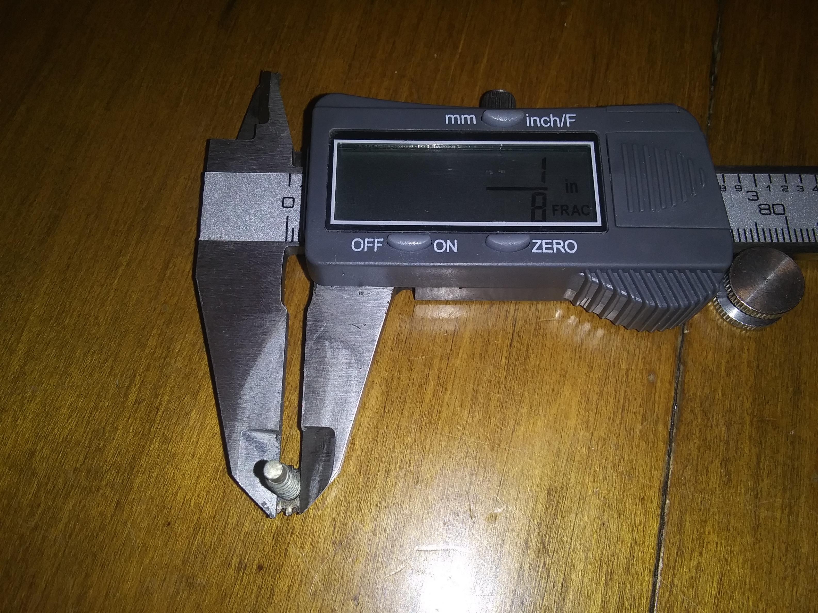

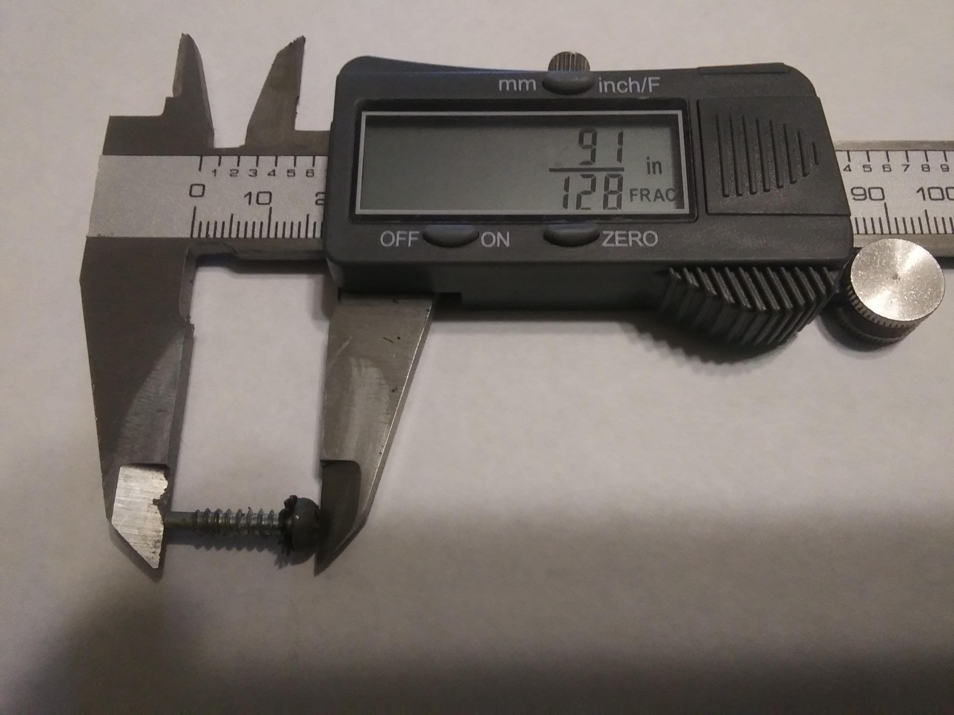

Hey Jo, I think maybe yours (or mine) have been modded? I have socketed TO-3's, which is what I've been asking about as I'm not really sure of the procedure with sockets, usually it's like you said a full insulator kit, with washer, and insulators for the pins and bolts.
Anyway the first 5mm or so of the shank is smooth, which I'm guessing isn't super critical but probably just helps center it in the socket?
Not really familiar with US/Imperial sizes, but I'm guessing this makes it a #4 x 3/4" or maybe 1/2" given I'm including the head.

That is a sheet metal screw. Not a machine screw. The unthreaded part is for self align with a auto-feed air gun, just jam it at the hole and the thin part will line it up. Unthreaded part is not necessary for hand assembly.
Conversion mm to in is 25.4 mm/inch. 1 mm is .0394 inch. #6 machine screw fits through a .140" clearance hole, #4 fits through a .089" clearance hole. Numbered sheet metal screws are about the same size as machine screws of that number but are not precise.
Round head screws the nominal length does not include the head, only the shaft. Flat head screws the nominal length includes the head. To measure the clearance hole your screw goes through, use the flat part of the caliper arms to measure over the outside of the threads at the fat part.

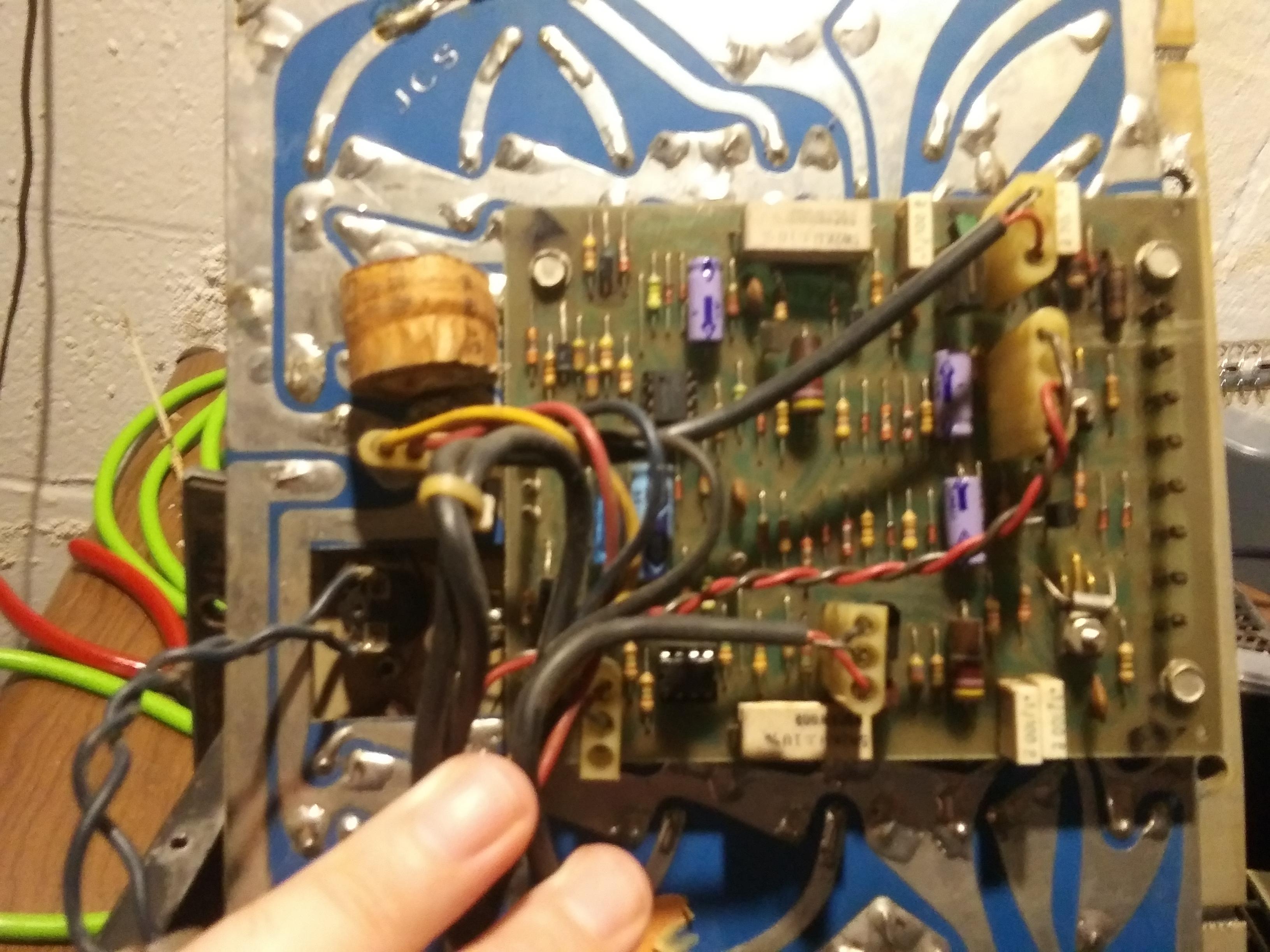

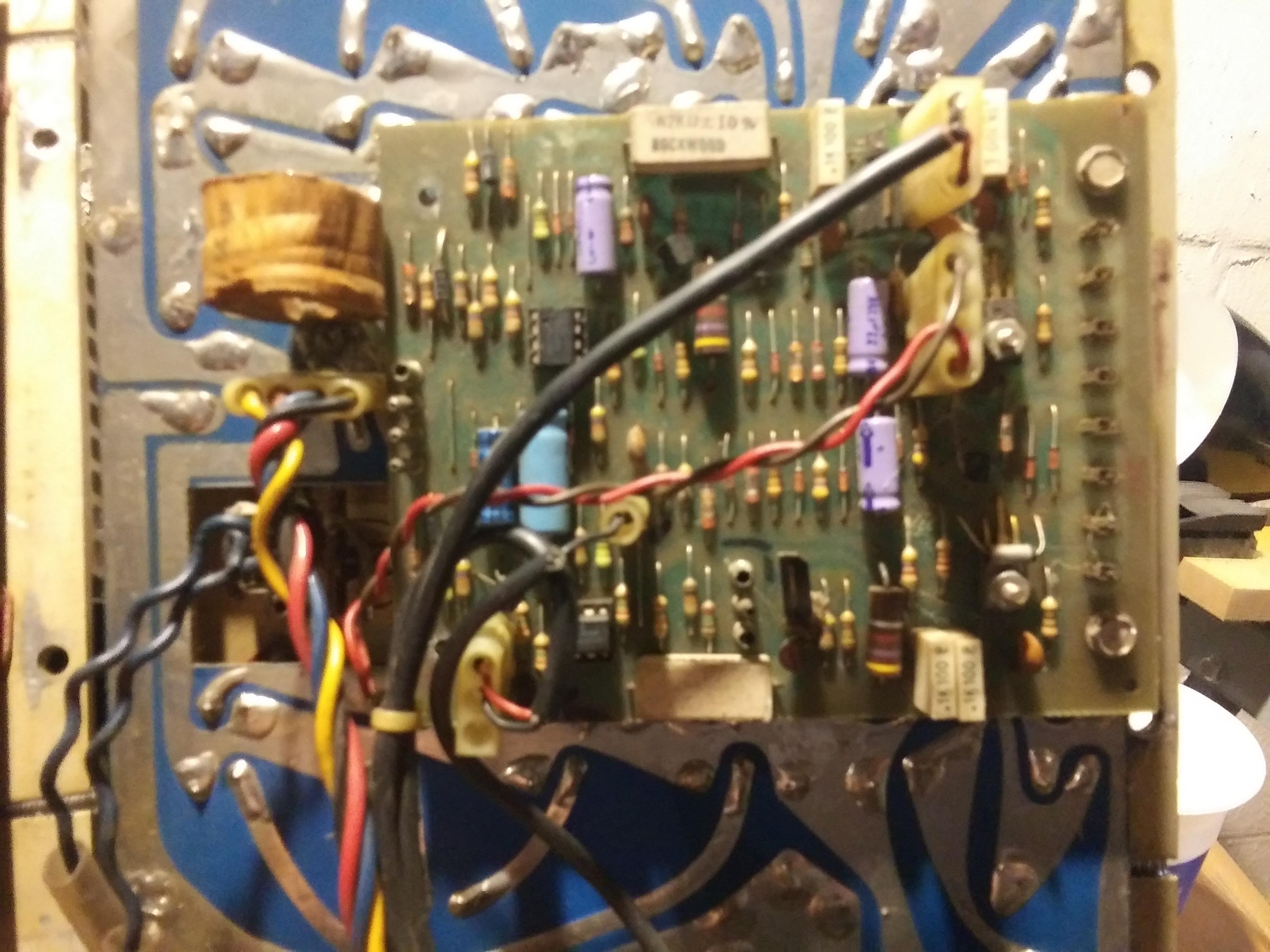

OK, I think I have the Series A (with Series C driver boards) semi-sorted. I spent some time straightening out the header pins on the Channel A output module and got the driver board fitted.
Channel B (picture with my fingers in it) was all hooked up already, so I used it as a model for Channel A and oriented the heatsink the same way round, as the cables had enough flex to let me do so.
Channel B had one extra 3-pin connector used, and there was only a single pin cable left on Channel A, so at first I thought just connect the single pin to the middle of the 3-pin. However after looking at the handy schematic / layout for Rev C that Enzo provided (thanks again) I saw that the 3 pin connector was connecting to R12 (thank god for the layout), which leads to the inverting input on the op-amp, and that there should be a single post from R34 which is the signal for bridge out.
To confirm, I ohmed out the loose single pin connector to the 3-pin on the Channel B board, and when the Stereo / Bridge switch is put in Bridge, they are connected, so I'm pretty confident that it's the bridge out connector, and that there is not 3-pin for Channel A, as it doesn't need an inverted output in Bridge mode.

On the side with the output transistor emitters connected through .33 ohms to speaker hot, the collectors can be all shorted together, as they are all +80 v. If shorted to the heat sink, the heat sink has to be on insulators to the case, which is speaker return.
On the side with the OT collectors going to speaker hot, the OT collectors can be shorted together but if shorted to heat sink, again the heat sink has to be insulated from case. Look for plastic ring washers around the heat sink mount. These could discintegrate in 40 years.
Never took an A apart to see how the heat sink was mounted.
Note I said output transistors collectors are connected through screws to the circuit board. Definitely on later models. Not sure of your OT socket comment, the picture didn't show that. But if there is a circuit board for output transistors, the screw to output transistor case has to touch PCB land for collector current to flow. Click on the mcmaster link post #105 to see picture of a star washer 4-40 nut that will make sure that connection to pcb land is made. If actual phenolic sockets, the connection to collector has to be made with a wire soldered to the post on the socket. I've got a schober recital organ 15W amp with phenolic socketed TO3 output transistors, but no peavey products.
There is an apparent drawing error on schematic. 1/4 jack is shown as tip touching ring unplugged. Ring is case ground or speaker return, that cannot be.
If the DC protection triac was shorted, the speaker hot would be shorted to speaker return and case ground all the time.
First thing I'd check would be if someone assembled it with no insulating wafers on that module.
Triac is easy to test, just measure resistance between black and red speaker posts on the rear. The triac is wired between them. If they measure shorted together, your triac is almost surely blown.
1.8 ohms between red and black.
I figure that the 4 pin connector that's on the output board rather than the drive is the output connector (and probably the power too) and the layout seems to confirm this.
If I unhook that output module connector, I still have about 2 ohms between red and black speaker terminals AND none of the cans ohm out to ground anymore (on either module channel A or B), so it looks like the crowbar did it's job, I suppose I'll have a blown fuse as well.
