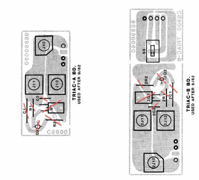

I bought 3 Peavey CS-800 amps. All have issues. Strangly enough, they all do the same. I replaced the fuse, and plugged it into my DBT. The light glows bright, and dims down.
But when I connect a speaker to either channel, the bulb is bright as can be and stays that way. :scratch2: The speaker is fine. They were all caked in nicotine dust, and are all clean. So its happy and stuff. I don't want to take it off the DBT, because I don't want to kill the amp.
I'm using a 100W lightbulb. This is the original PV-800. It is the same model as the one shown in this picture. (I got the pict off Google, its not my actual amp.
The traic boards are fine. Should I start checking the outputs for shorts?
-Nick
Also, I removed the triac. I'm not using speakers of value on the amp anyways, and if something little shorted the triac, it could lead to costly amp repairs, instead of new speakers.
Can I remove some of the fancy wiring that I'll never use? Like the bridge mode switch and wiring (would I have to do something to the boards after) and wires that power the octal sockets for 70V transformers?
My main thing is I want to get these amps working. I'm going to sell one, and keep two. Can't sell one or use one if they are all goofed.
Lastly, the fuse is 15A. The fuse has a white casing (ceramic fuse I would assume) is this fuse a fast blo or slowblo? I assume slow blo, as I don't see a soft start circuit inside.

Yes, those traic and related parts are only protection, the amp will operate fine without them. You can likewise remove the seat belts and airbags from your car. It will still drive fine. I don't recommend it, but indeed the amp will amplify just fine without them. To kill it, all you really needed to remove was the triac itself. Those other parts won't get in the way. Or wouldn't have.
I won't hesitate to disconnect them during troubleshooting if I have any reason to think they will interfere, but i always have them working and in place when I am finished.
They protect your speakers, but not so much from being blown, but from catching fire. I wasn;t joking. They also intentionally short the output to blow the fuse. If they blow the fuse, it turns the amp off so no further damage can occur. This is called crowbar circuit.

As was said, the triacs are like seatbelts on a car, they don't HAVE to be present for the amp to work. If a momentary spike trips the triac, it shunts the output until that signal crosses zero. Unless you disable it, this amp has the Peavey very effective DDT circuit that liits peaks to prevent clipping but stays out of the way otherwise. A transient peak won't kill the triac. Trying to be a dead short across an 80v rail will.

Now, is the amp designed to handle a short across the speaker terminals, and only blow a fuse, not the output transistors?
Another guy said it would be stupid if the triac when shorted would result in damaging the output transistors.. (Although the triac would only short of the output transistors were malfunctioning, or the amp had a major failure.)
My view on it is this. If a triac shorts, and the outputs are all working and happy, then they should withstand a short, and the fuse will blow, but the outputs being able to simply handle the dead short.
