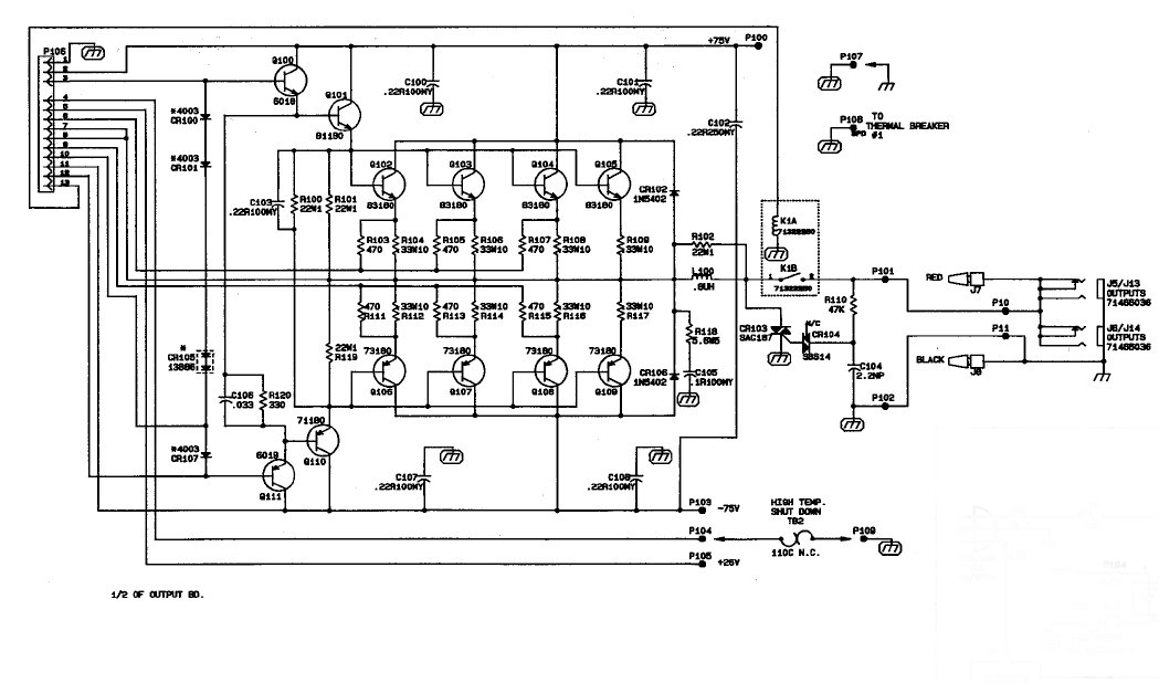

I had one of those big diodes in the output boards go short circuit, all triac crowbars were bad, a few driver transistors , and one small signal diode, no caps surprisingly.
Read my post "Damn crowbars".
Oh, I guarantee there were caps that were bad. Maybe not bad enough, but at least degraded. The problem with “damn crowbars” is that turn on/off thumps often trip them. Resulting in shorting out the output transistors. It probably didn’t do it when the amp was NEW, but give the caps a few years/decades and all the time constants are no longer in the same relationship to one another. Didn’t thump, now it does. Then the crowbar trips. Put in new caps, the thump goes away (or at least reduced in magnitude). Take out that dumb crowbar and replace it with a muting relay and now it’s tolerant to capacitor changes as they age. Then you don‘t have to change them till they’re really bad.
If an output transistor blew out and shorted, the crowbar would fire. It would be seriously overloaded and short the triac out too. If a DC fault were caused by something else (ie, the VAS current source opening up, slow-charging caps, dropped mic), the triac would also fire. This would short the output stage - but not necessarily blow it. When/if the fault clears, normal operation resumes. At least that is how it is supposed to work. The output transistors were a little undersized and the triac VERY undersized in order to do this safely.

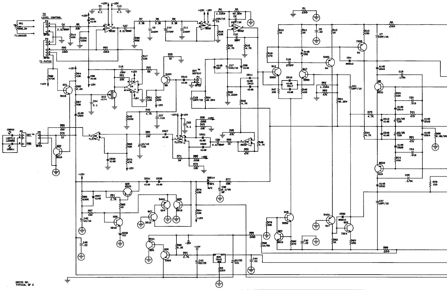

How does the CS-800 adjust its DC offset? Is there a servo running on an OpAmp?
How would one go about tweaking such a thing?
Built like a tank and zero trimmers inside.

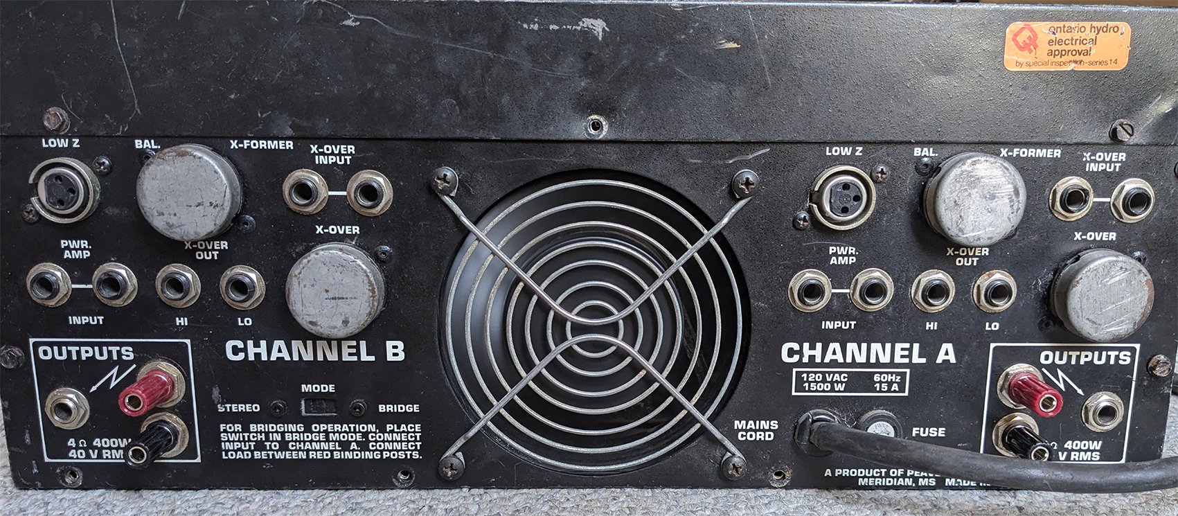

I think I have an untouched unit. I think I am the second owner. I have not listened to it yet.
No, the DC offset is not terrible, just my curiosity.
If you look at the schematic you posted, the second op amp upper left has speaker ground as feedback. Signal goes in the top. The first op amp, the feedback crunches down the signal against the + rail if the DDT detects too much high frequency. This turns down the gain if the highs are too hot. So centering on ground is an inmportant input.

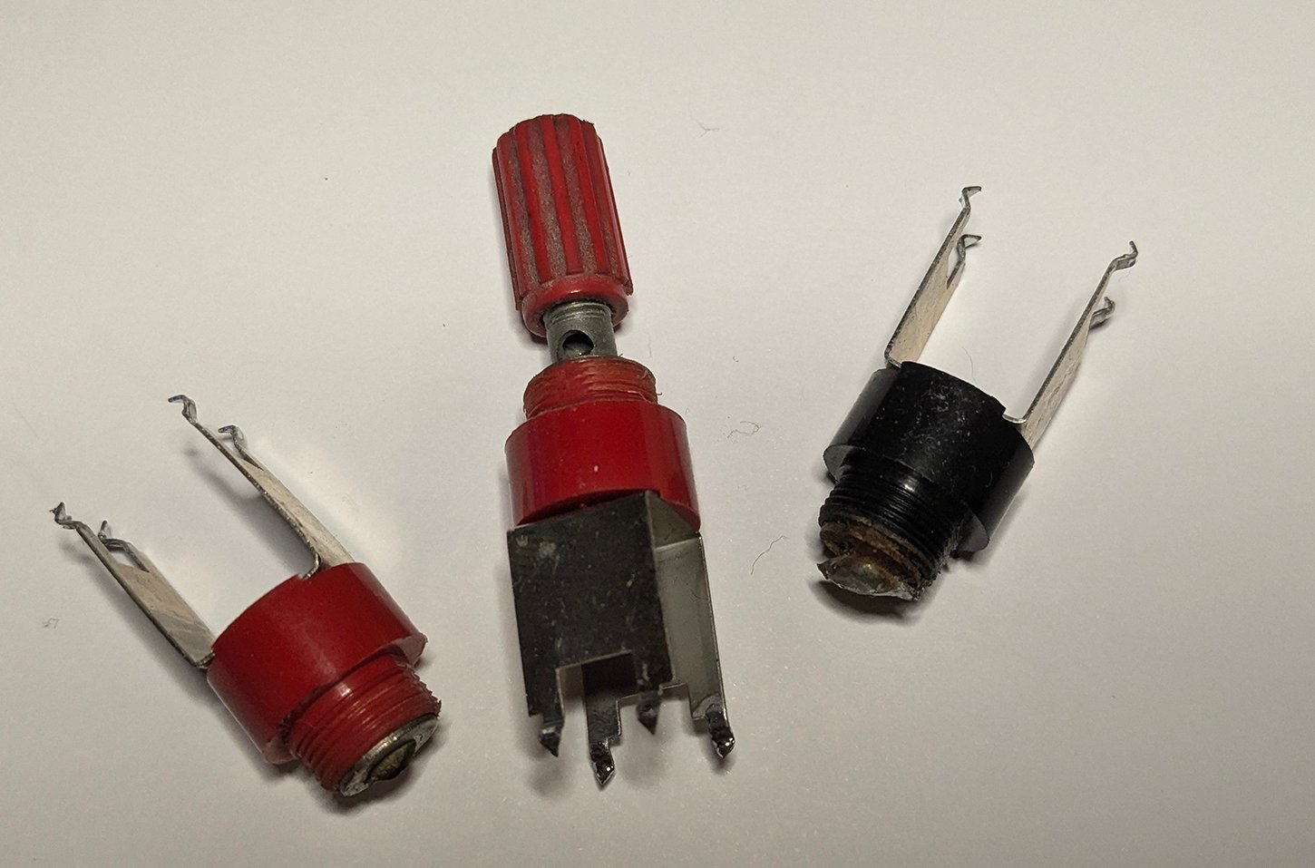

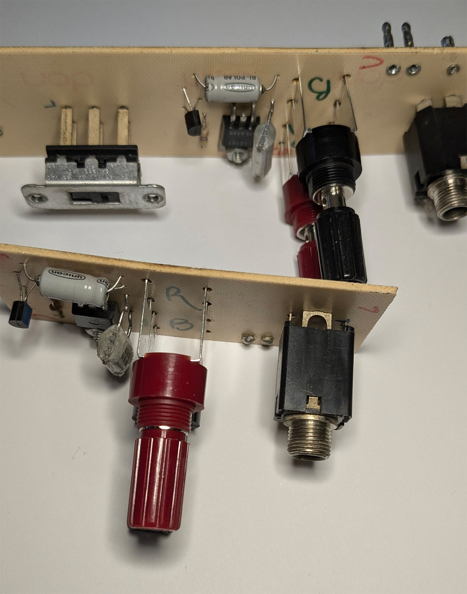

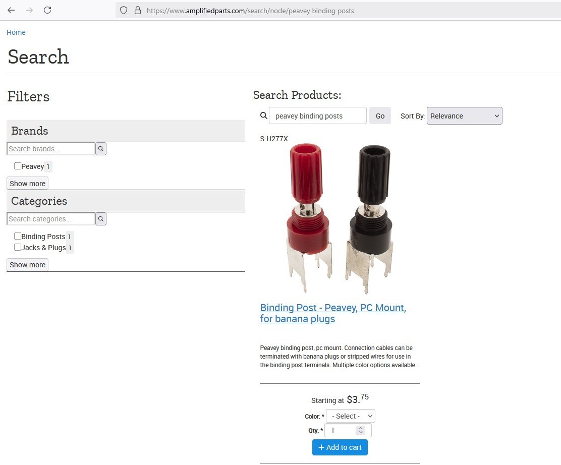

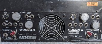

New binding posts. The ones that fit into the boards and help mount the PCBs they are part of.
They are cheesy. I could have modified the PCB mounts and added new heavy-duty speaker binding posts but I had no justification to do that.
I wish they were better though...

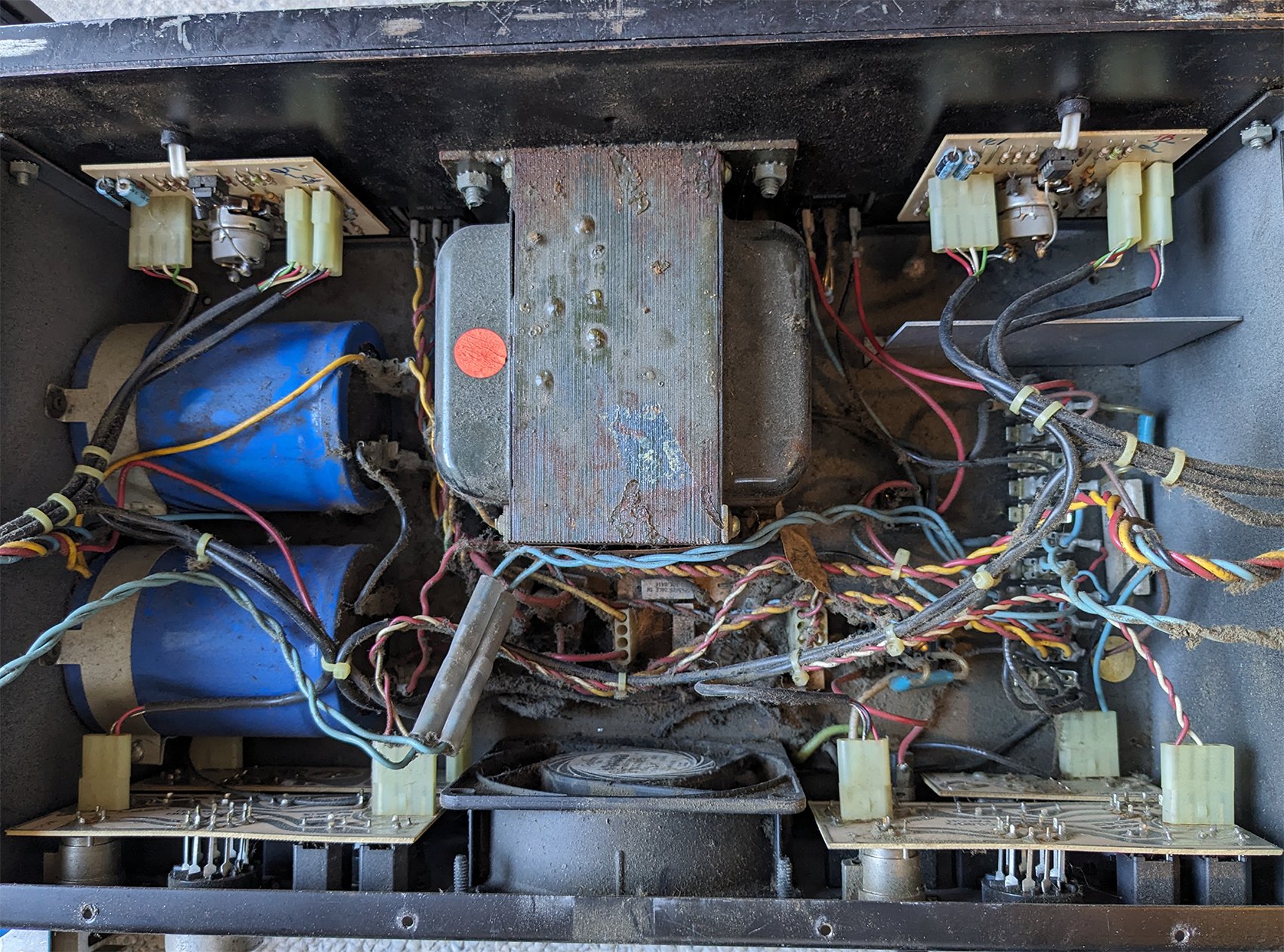

I clean the heatsinks & output transistors completely with isoprophyl alcohol on cotton balls with a screwdriver and a pick. The fan I usually replace. The exit louver could use a clean. The tops and bottoms of the PCB's should be wiped with the cotton balls & alcohol. Inside & outside of the case, 409/fantastik/spicnspan rubbed with a paper towel.
Perhaps new pots and connectors. For sure new long service life electrolytic caps. I put a filter over the air inlet, sticky fiber I buy from mcmaster.com . All that, good for another 40 years.
Instead of banana/binder jacks, which are obsolete, the whole output panel could use a replacement with Speakons. The 1/4 phone jacks need to go, they are an invitation to shorts.
