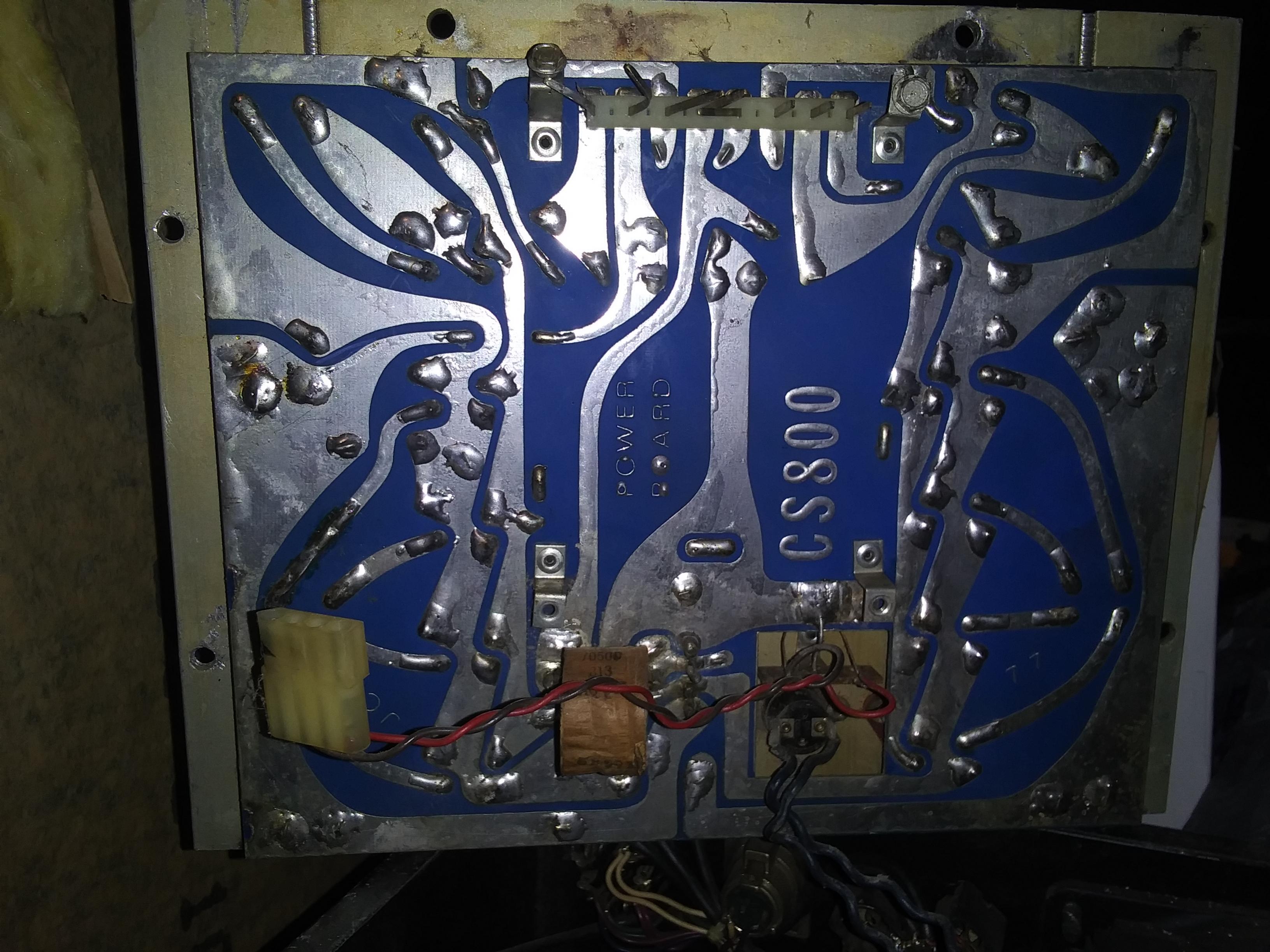

Sorry to resurrect an old thread, but does anyone still have the full manual for one of these beasts? I contacted Peavey and all they had was the schematic, no board layout or parts lists.
Thanks in advance guys.

That looks like a couple of A revision.
The semiconductor PN is on the schematic and crosses as follows: TO92 can be 2n5401/2n5551 for the high voltage ones (80 up) and MPSA06/56 for lower voltages. TO126 7204 is MPSU10 and 7205 is MPSU60.
TO3 can be MJ15024.
The IC 5278 is a 741.
The triple diode in the heat sense stack can no longer be bought. You can buy them from Peavey parts department. Red led can be substituted electrically but it doesn't really fit in the slot in the heat sink for a DO41 package.
There was a complete semi cross list on Nymeria
Happy hunting.

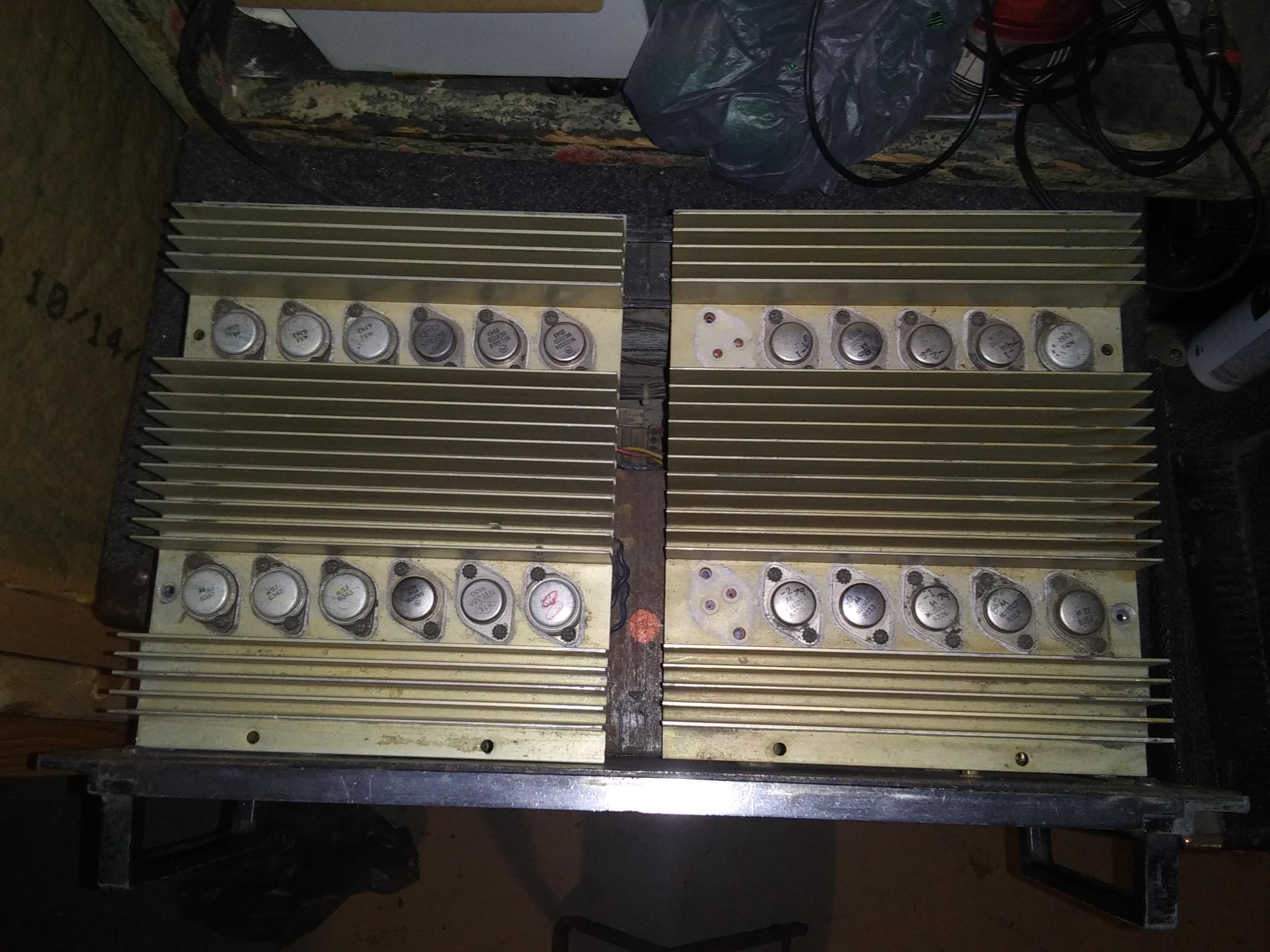

Yeah I was hoping for the board layout, because I have some components missing.
For example, the first two transistors on the heatsink, as you look at it from above, the leftmost one in each row. Are they the drivers?
I need to get deeper into it once it comes out of quarantine.
I think I'm lucking out and they are Motorola's, because I have a 10 pack of MJ15024 (or something) which I had used a couple of on a Peavey Century, oddly enough, I'm hoping I can drop into the circuit to replace them. I'm going to have to re-read this thread on the transistor substitution thing.
Usually. I've only worked on Cs800s & PV-1.3k. If the emitters of the two to3 transistors go to the bases of all the other ones, they are drivers.
there is a little less cross conduction of the output transistors if the drivers are a little faster. Later models used MJ15020/21 as drivers, which had 20 mhz ft instead of 3 mhz.
These A models are a little hissy to tempt me, as a keyboard player. A is Great for beach bars & loud guitar or bass stage shows. where the volume is the same all the time. 741 is the source of the hiss. Later IC are not pin compatible with 741.
Um, the 5278 IC is a TL071, not a 741. On the C version they went to 5534.

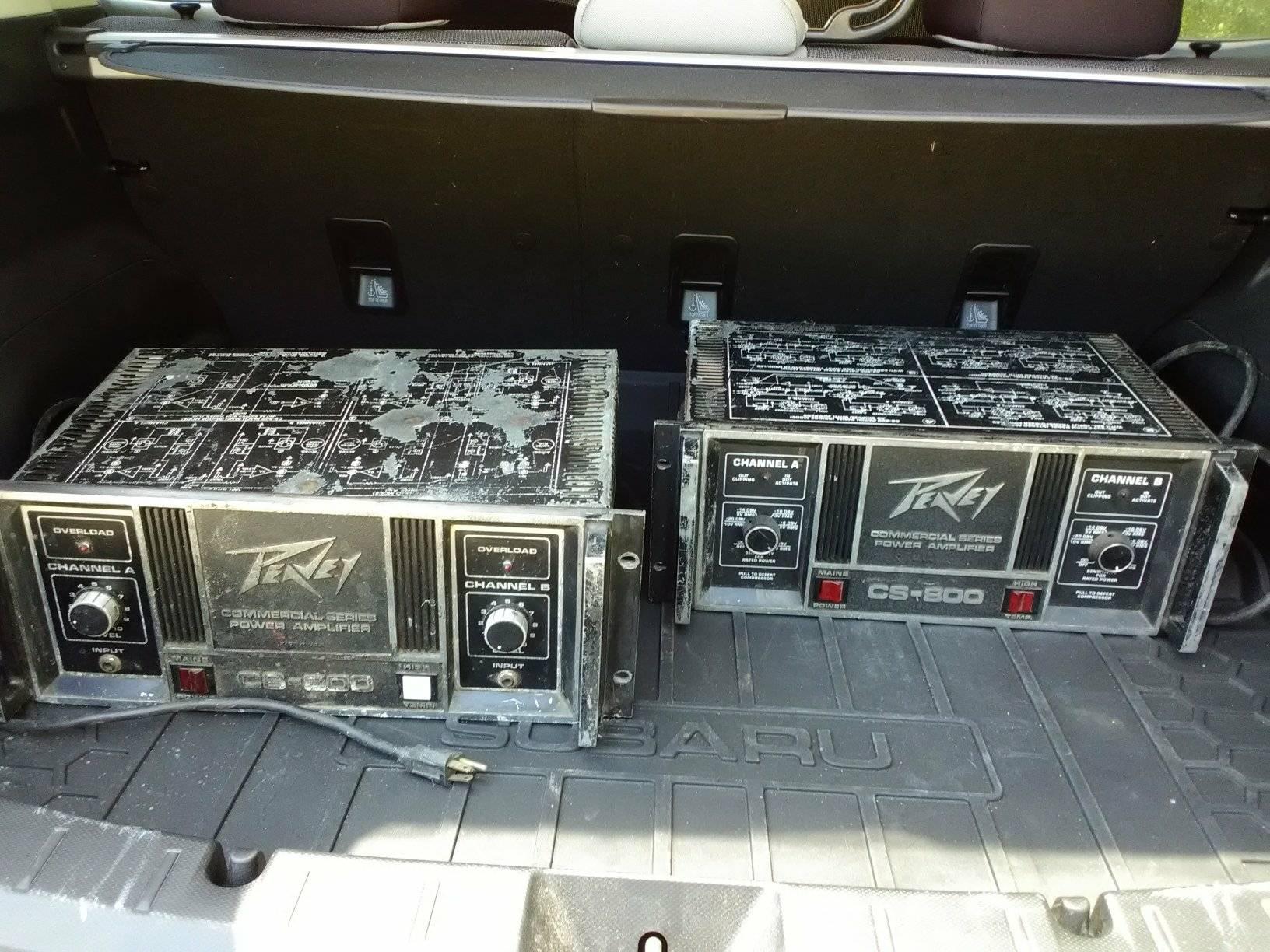

You seem to have two different versions of amp, one looks to be an A series, but the other is a B or C. Look on the driver card on the output modules. The older A and B series have ONE IC on the card, the C version has two.

I think I may have a mish-mash of parts, if such a thing is possible? Are the cards interchangeable?

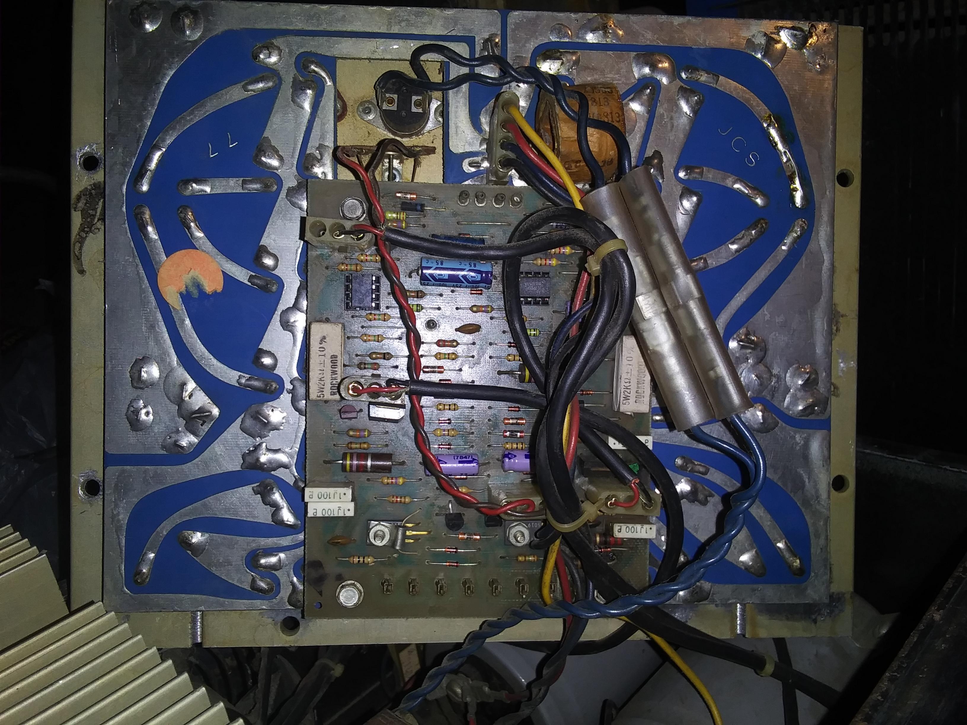

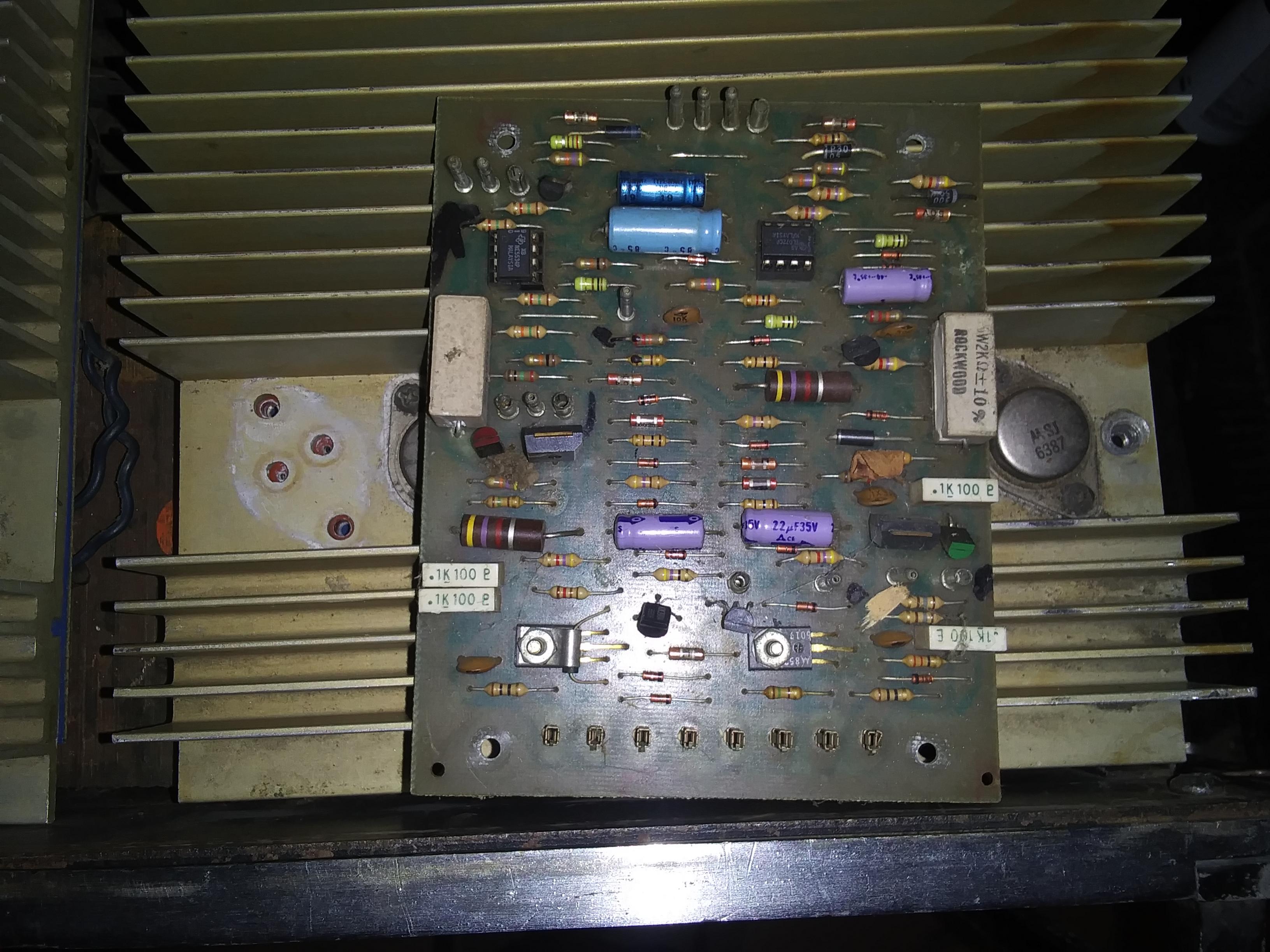

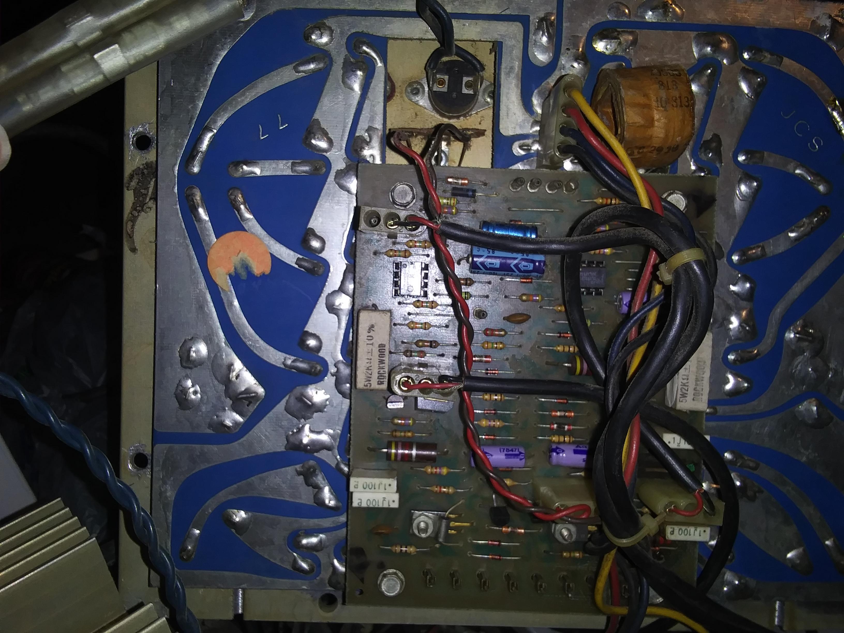

These are pictures of the A series (the B series is working allegedley so I haven't cracked it open), both driver cards have two small 8 pin IC's. It appears that the ouput module was just dropped in backwards, and the pins for the driver module are bent, I'm assuming it goes the other way around, as that is how the screw holes on the edge will line up?

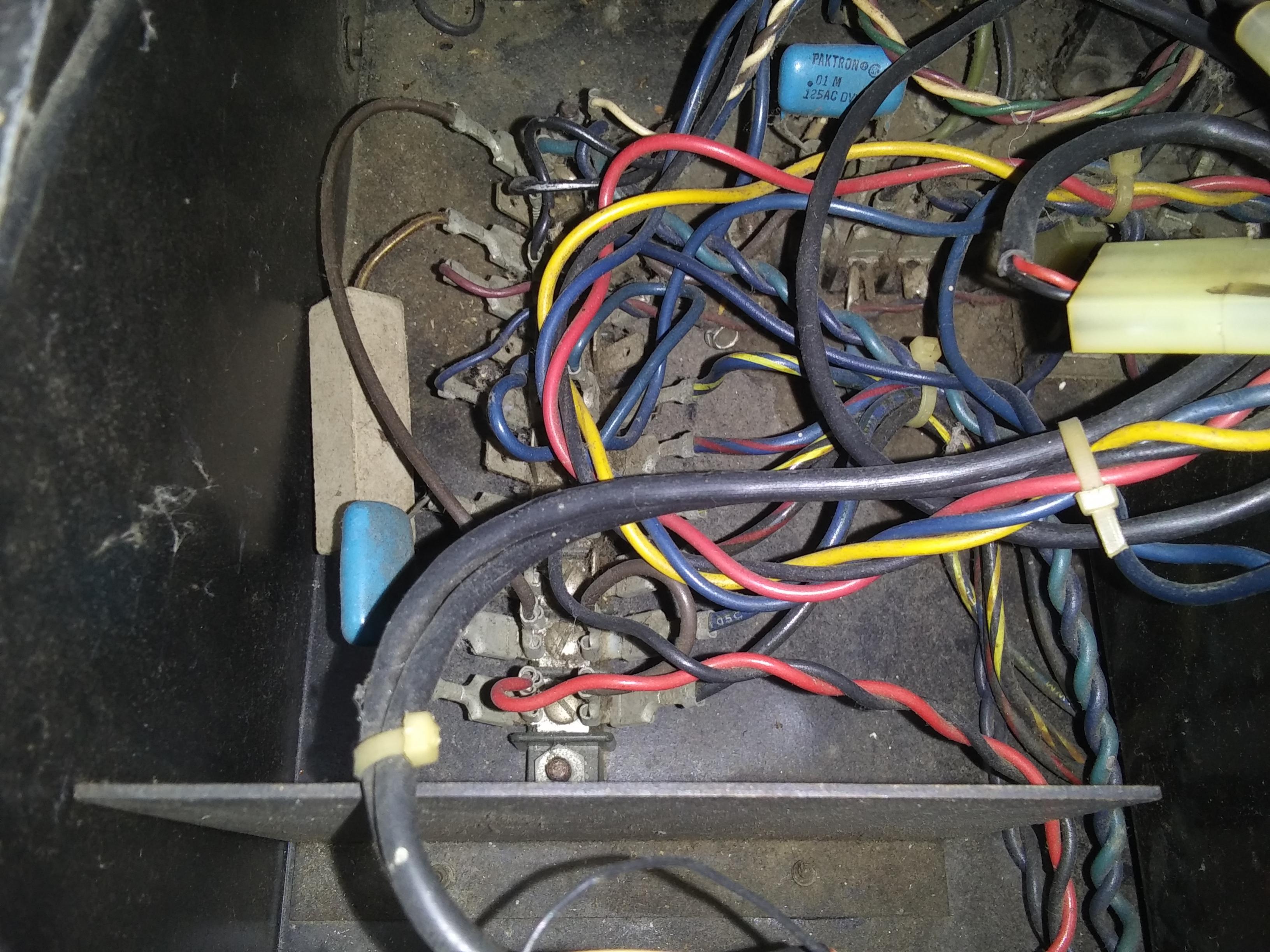

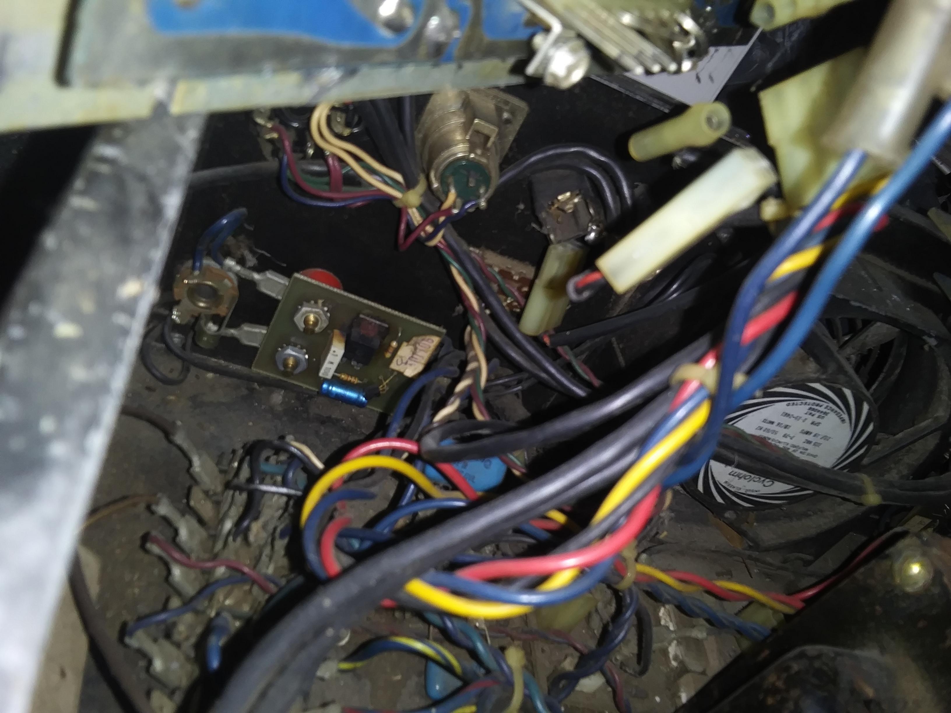

I'll also have to figure out how all the molex connectors connect. The hardware on this isn't metric is it? I'm guessing the little circuit board on the output is the triac board? Also, the TO-3's on the heatsink don't have an insulator washer do they? Just some heatsink compound?

Peavey tended in late 80's to use interboard ribbon cables named KKR , I bought pins for my PV-1.3k. None of the distributors index them that way, you have to have a 9 digit part # to look one up. Those driver boards are interchangeable driver to output board so you can put the bad one on top to repair it, but the interdriver board cable only fits one way. The jumper plug on the cs800a schematic is round, you would have to measure it to find one in a catalog.
The triac on rev A is to short the speaker, usually blown up in dead equipment. Disconnect for testing. The 8 v "sac 187" DC detector I bought from newark as a powerex bs08d, but you can use two 5 watt 8 v zeners line to line in parallel. Also known as a 2n4992. Ignore the middle pin on the powerex.
15 amp power switches are so expensive there may have been a running change at some point to turn the power on with a
triac on the case bottom with a resistor from 120 hot going through power switch to triac gate.
A thought on the interboard connectors. If they are .250", .187", or .085" wide, they are standard amp crimp terminals. They can be crimped with a stock klein or ideal crimp tool. All auto supplies have the .250" ones usually in the dorman line, and some have .187" and .085" ones. NAPA calls the .187" wide ones "ford ignition terminals" but they were used in appliances long before ford ever used them.

With two ICs on the driver cards, you have a C series. And in fact the schematic file for those does include a layout.

Crowbar triacs are on the speaker post boards.
Another ident idea. The A and B series have just two small transistors on the small board with the volume control. The C version has two ICs and other small parts on the volume control boards.
Thanks for the schematic Enzo, the board layouts will be most helpful.
Is it possible to mix the modules? I have what appears to be (from what y'all have told me) a series A, it has the white HIGH TEMP indicator, the inputs are on the front, and the level knobs do not pull out. Yet that drive board you say is a Series C? I didn't pull the amp off the shelf as I had nowhere else to put it yet, so I couldn't see the control board itself.
Regards the TO-3's, I took one off the heatsink module, and they have an insulator underneath, but nothing round the screws, is that normal? Does the mica sheet provide insulation between the screws and the heatsink and it's going into a socket? In which case if I order these, I'm set?
