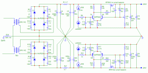

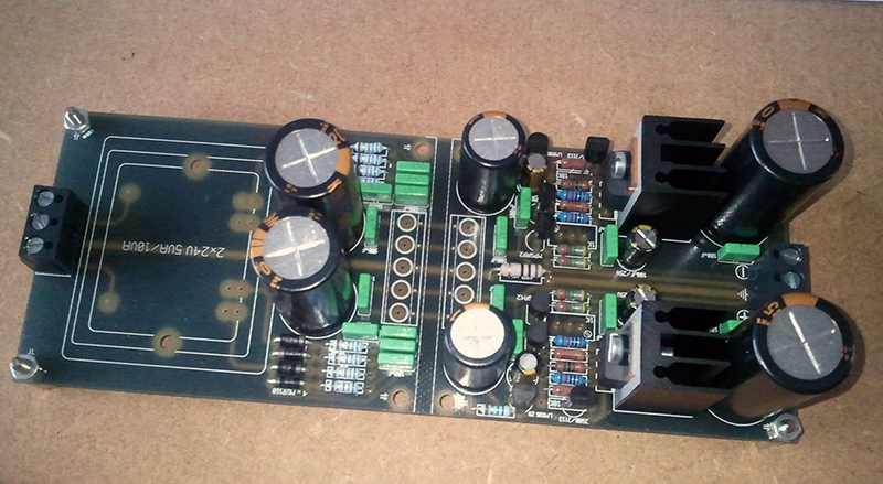

nAr used a 2 x 24V 300VA RCore from Selectronic 😉 And Mundorf MLytic Capacitors 😎
But I'm currently planning to use the same PSU as I have in the UGS preamp.
Reason is, it will sound probably better than the actual onboard 7824/7924.
It is a design by CheefDeGaar, and it is inspired from the Pearl 1 regulation. As you can see, Flat made the PSU bipolar, symmetrical.
It is 24V OUT and has very good regulation, silent, and is ajustable to your needs.
The diodes are MUR160, ultra fast diodes along with RC snubbers.
There's also a Pi filter before the regulation. Layout is compact so it's practical.
I'm also preparing a 30V flavour to upgrade my current AlephOno PSU. And Yes, I love RIAA stages 😉
