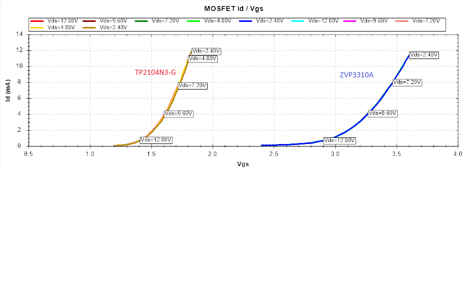

After a few years of excellent listening my Pearl II has developed a pop on startup in the left channel. Otherwise, it's still fine. Any thoughts before I start meddling?

Thanks for the suggestions. So far I have replaced the ZVP to no avail... still pops in the left channel on startup, whether after a lengthy idle or soon after switch off. Will check the P1 in the next day or so. Unfortunately don't have an oscilloscope.
