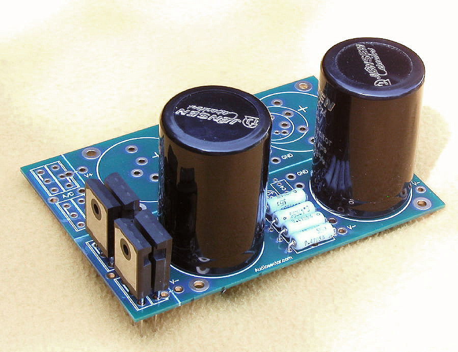

6L6,
But , But , But ................ ! Ok Dad 😱
Seriously , I need a design for the PSU .
I have the boards . I have soldered the regs as per PD . LM317 + sinks on their way ....
I have Nichicon 10000 uf 50v Caps -2 per board
Can I take the B1 design you made for the B1 and double it ? Cap and resistor values ?
Rich
Rich
Don't use the 317's in the Peter Daniel board. Unfortunately, you should remove them from your board. The Pearl 2 has on-board regulation. It's the things with the heatsinks.
Here is the original supply design -
You also need to tie the two sides of the Peter Daniel board together.
Once all the regulation is off the PSU board, you could put a couple of low-ohm (.5ohm, 1ohm, 2ohm...) resistors in, like this -
So once it's done, your board should be similar to this, (although both sided must be stuffed) here shown with the rectifiers still attached (assuming you are using discrete diodes)
