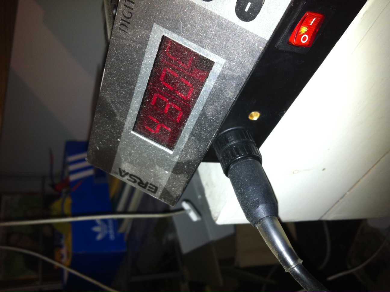

I want these connectors ... can anyone help with a name or a supplier please ?
Rich
Rich
Is that signal or suply?
IF you are after suply have a look at Rapid uk
Loads of stuff at half the price of Farnell or RScomponents
If is signal loads of XLR plugs
By the way XLR carri up to 1.5 A so maybe.
I am using 4 pole (4pins) speakers conectors fo my F5 20 A dc rated at about £2.50.
3W LOCKING CIRCULAR CABLE PLUG
There you have it
http://www.rapidonline.com/Cables-Connectors/3-pole-Locking-mains-connectors-63561
Beter ones
http://www.rapidonline.com/Cables-Connectors/Speakon-4-pole-loudspeaker-connectors-67751
The one I use
Prices are unbelivable....
There you have it
Beter ones
The one I use
