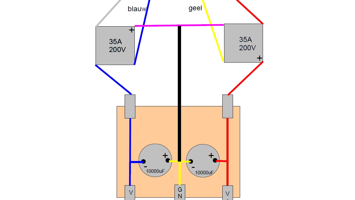

Gentlemen,
What are U1 and U2 ..... alternating regs ,I know that much , but what are they ?
thanks, Rich
thanks, Rich
U1 is a 7824, which is a discreet 24v positive regulator in a TO-220 case. U2, a 7924, is the negative regulator. They are kind of generic, made by many suppliers.
Example listing - Digi-Key - NJM7924FA-ND (Manufacturer - NJM7924FA)
Thanks for checking for me, Wayne and Audiofanatic.Yes that connection needs to be there. It was missing in original article.
I had been wondering why the center connection was not there (as in the Pearl II manual) but assumed it was the way is was supposed to be. I will include it in the drawing.
Thanks again (en groetjes),
Albert
