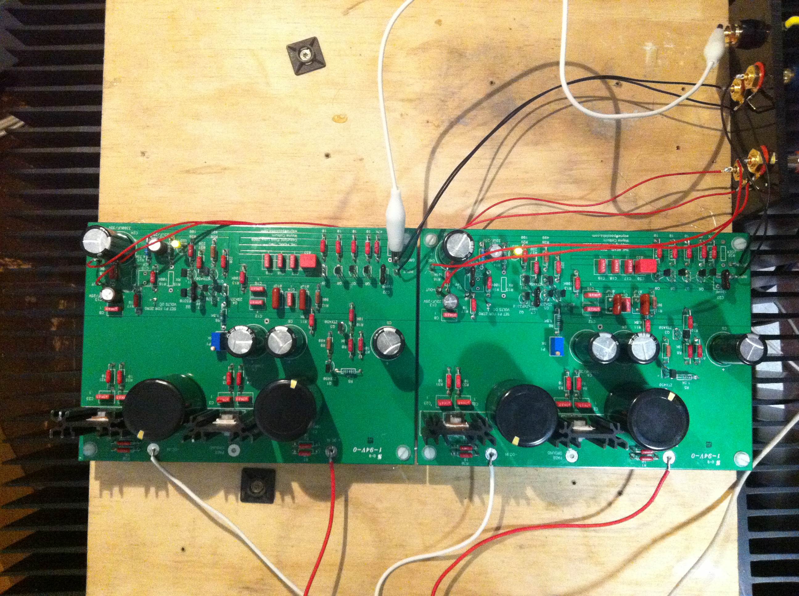

Gents,
Excuse me for feeling rather smug ..... Pearl 2 fires up first time 😀
Still all the tweaks to do . I used the 5pf silver mica caps at C9 .
I'm shocked and stunned ... FIRST TIME ! Anyway , back down to earth .
I need to get a better cartridge as I;m using an old DJ cartridge and the Veenil
I have is not the best production in the world.
Love the crackle and pop ..
There needs to be more gain , but there doesn't seem to be much point until I get a decent cartridge , a good test disk and everything has settled down .
I want to sit a read what others are up to before I touch it again , but I'm open to advice about things to try out .

I know ..... I'm still waiting for the transformer so I'm using a 24 vdc mac PS
Can I damage anything by using it ?
I have Peter's boards for the final PSU .
I know of only one place I trust to get a transformer from and he's not around till next week .
R
6L6,
But , But , But ................ ! Ok Dad 😱
Seriously , I need a design for the PSU .
I have the boards . I have soldered the regs as per PD . LM317 + sinks on their way ....
I have Nichicon 10000 uf 50v Caps -2 per board
Can I take the B1 design you made for the B1 and double it ? Cap and resistor values ?
Rich
Don't use the 317's in the Peter Daniel board. Unfortunately, you should remove them from your board. The Pearl 2 has on-board regulation. It's the things with the heatsinks.
Here is the original supply design -
You also need to tie the two sides of the Peter Daniel board together.
Once all the regulation is off the PSU board, you could put a couple of low-ohm (.5ohm, 1ohm, 2ohm...) resistors in, like this -
So once it's done, your board should be similar to this, (although both sided must be stuffed) here shown with the rectifiers still attached (assuming you are using discrete diodes)
