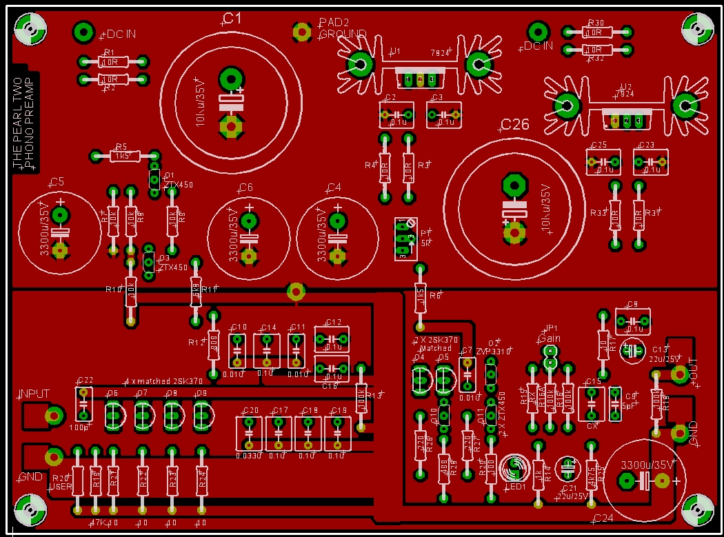

I did my own PCB, smaller than the standard PassLabs design. It fits on 6''x9'' double side PCB material sheet I used. I got very nice Mundorf M-Lytic power supply caps, Vishay RN-60D resistors all around, and 0.1% CMF-55 resistors at key locations. These are the top and bottom layers, one channel. Both channel fits on 6''x9''

Very nice design 😉
Slyvain, check your PL on the size and output of your tranny... An Rcore would beat the philtron at these levels

... and you kept the "square landing areas" I added ! 🙂
I must say, they are nice to live with.
Soldering on top of the board only is easier, also thanks to the "vias" 😎
I perfectly agree for a RCORE transformer, it makes sense for all line levels applications, DACS, preamps, active filters ...
