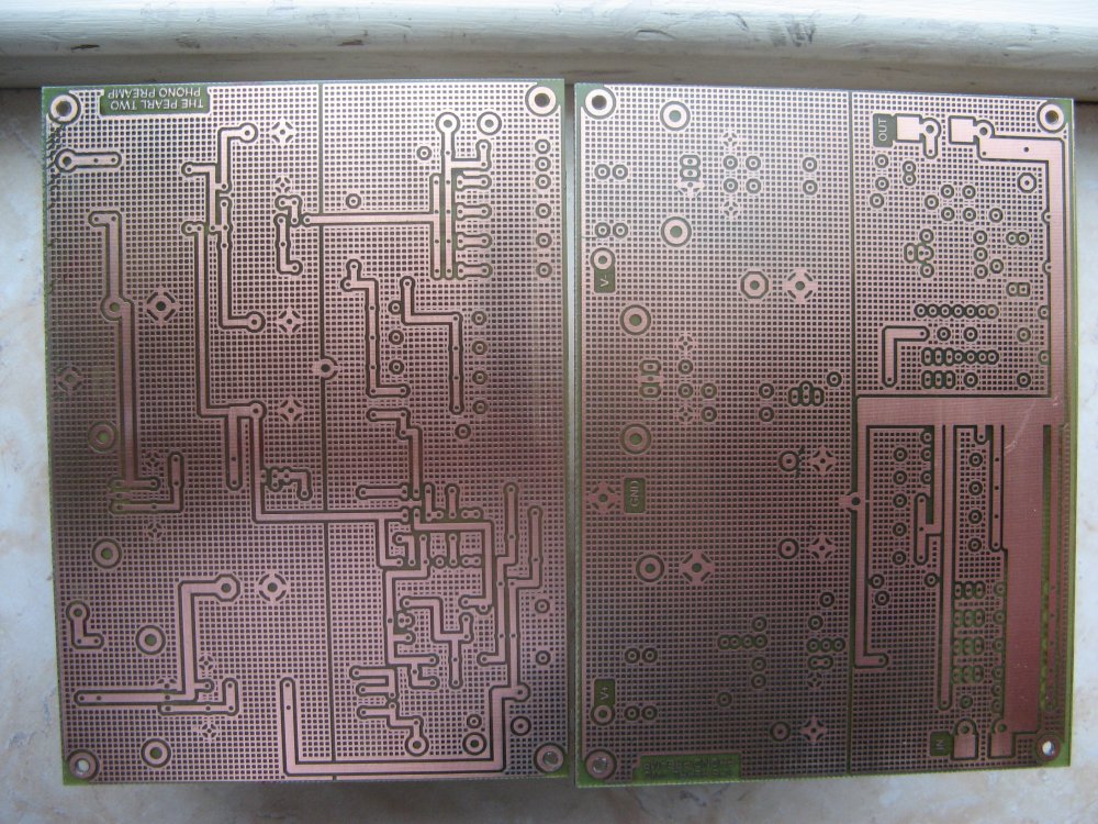

Here the actual boards. There was a few errors on the pictures I posted previously. They are corrected on the real boards.
Hi. I already have a separate power supply from my Pearl project, I'll just re-used it and decide later on which one sound better 😉
Perfect finish for the raw boards Sylvain ... 🙂 Next drilling and populating !! (the most fun part) 😎

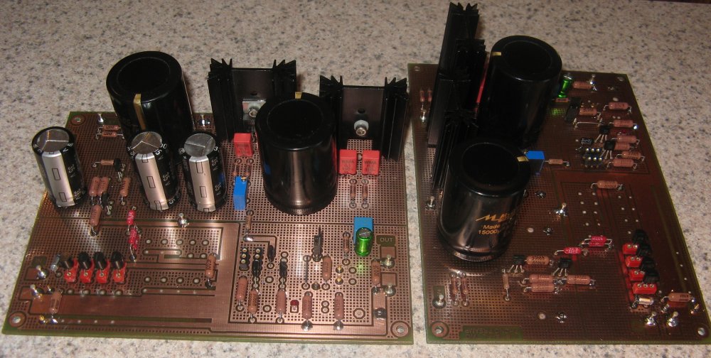

Here the populated board. Still missing a few parts.
I like the idea to mount the input jfets on pins ... easily swappable to get the perfect match 😉 Contact resistance should be low enough, just be sure that the jfet pins are clean with no oxidation 😎
Just use first rate MilMax IC socket, gold plated, high insertion force. TO-92 fits perfectly in these. I used them years ago in my PassLabs Xono and never had a problem. I used them now with all matched parts. On my Pear 1 I had a burned FET from one of the QUAD (certainly from a very bad spark I heard with a defective tonearm wire on my Thorens TD124. It was then easy to find a match from my stock of FET. In circuit matching is also the best.

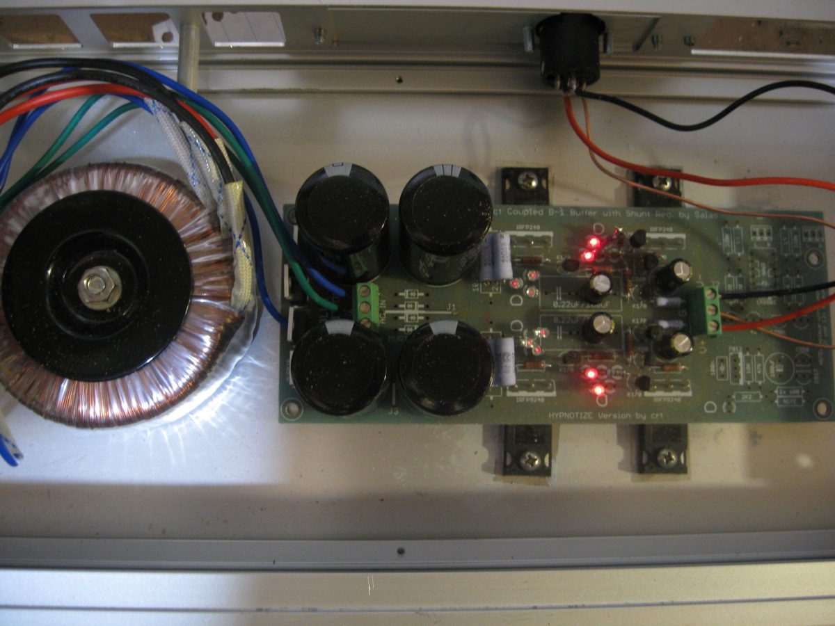

I used a Salas shunt Reg for the power supply. (attached)
