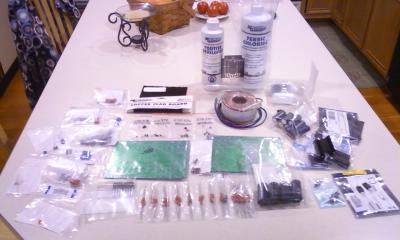

Building a Pearl 2 as well now that the Aleph is done? I have the Pearl 2 boards and matched fets, just about ready to start collecting parts. Same thing with Pumpkin preamp. Cant wait to have them done!
Russellc
All parts are in including parts for power supply. Time to get started.
