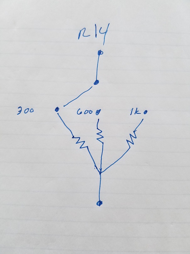

I just added 3 position rotary switches to mine for gain adjustment. Works quite well. I run .25mv carts with no stepup.
So you have like 3 values of R14 to shift with the switch?

Yes 300, 600, and 1k. Non-shorting rotary switches and there is zero noise when switching. 🙂

Do you have wires from the location of the resistor to the switch - and back? Or have you managed to place the switch near both PCBs in some way?
I used shielded wire and noticed no additional noise.
I know it would be a pain to take pic of this implementation, do you perhaps already have a pick of this setup? Do you happen to remember what switching device you used?

Part is here: A10303RNZQ C&K Components | Mouser
Wiring is like the drawing attached.🙂

It looks like a fairly large part, do you have a knob on the outside of the chassis? It looks large enough for those purposes. Or is it concealed inside?

You need to be able to turn the rotary switch.

Hate to drill a hole through my face plate, I guess I could have it exit the rear panel. If it isnt too large, I can conceal it inside. I will not need to change carts very often, so no big deal for me to make "internal" adjustment. Maybe even a small board inside with Tiny DIP type switches...

Do you have 2 of these single pole switches - or should it be A20303RNZQ for double pole ?
I used 2. Do you mean 2 pole or 2 deck? I'm not fully up on switch terminology.
I meant 2 pole - but when you used 2 that explains my confusion 🙂🙂
