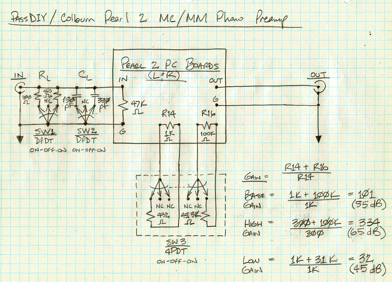

Into my second Pearl Two build! On this build I’d like to be able to adjust both Gain and Cartridge Loading. I’m doing this for the same reason as many others have, to be able to try a variety of MC and MM cartridges.
I am comfortable with my understanding of how to implement the Variable Gain at R14 which I will execute using a dip switch or sockets with 300r, 600r, and 1k resistors.
I am confused about loading. Based on some the cartridges I currently own and am looking into trying I believe I will need a range of values of 47k to 816ohm. Wayne’s Pearl Two Phono Stage manual/article states that “R20 is a user provided resistor value that sets the input load for the cartridge if not the default 47 Kohm.” Yet in the build threads builders are referring to C22 and using capacitor values in the range of 100pF, 150pF, 220pF, and 330pF.
Are the capacitors used in conjunction with R20 resistors to vary the cartridge loading and this just hasn’t been noticed on my part or is cartridge loading done either with C22 or R20 but not both ?
Do I just not understand what C22 does?
Why did Wayne point to using R20 for cartridge loading but not mention C22?
If using just R20 how does one calculate resistor values?
If using just C22 how does one calculate the capacitor values and how does this change the cartridge loading?
If both C22 and R22 are used how are those values derived?

R20 et R19 do the cartridge loading for MC cartridges.
C22 is for MM cartridges (I didn't put any caps at this place on my Pearl2).
Input load is (R20*R19)/(R20+R19). R19 being very high (47K), the result is more or less the value of R20 (on mine, I didn't solder R19 and used IC socket to swap R20 easily).
So for an adjustable load, you juste have to choose different R20 values (100, 200, 400, 800 for exemple) and use a switch to choose between them without opening the box (or sockets if you don't mind opening it).

FWIW, I put pin sockets in the R20 and C22 locations so I can swap out as required. Currently running a Soundsmith MI cart, so 47K and no cap.
Thank you, Folkdeath95 this is helpful. I may not end up with MM in play, though I do have a Technics EPC-U1200 mm cartridge, it is unlikely to be moved to the system the Pearl Two will reside in. So at this point I don’t need to be concerned with C22. It is clear to me now that vdi_nenna is referring to MM setting where the capacitors are concerned.
The formula for R19 and R20 is the parallel resistor value calculation formula, again clear to me now, as R20,R19 are in parallel, which are the parallel resistors vdi_nenna referred to in his post. Duh! Life is harder for us slow folks!
How does one calculate how much the decibel gain is based on the the R19 and R20 resistor pairs?
As gain can be set using R19 and R20 -or- R14 by itself is one way preferable to the other?

For switching gain between MM/MC, I installed a 220K in the R15 spot and then soldered a SPST switch to the resistor leads to short it out.
Is there an advantage or disadvantage to adjusting/increasing gain at R14 (as some have done) over using R20 to adjust/increase gain?
Also How does one calculate how much the decibel gain is based on using the R19 and R20 parallel resistors? So if R19 is 47k and R20 is 560r then the value of those two resistors in parallel equals 553.41r, using the 553.41 value what is the gain in dBs and how is that calculated?
AFAIK, R19/R20 don't set gain but only input load.
To set gain, here is a shematic with formulas posted somewhere before in this thread (I'm afraid I forgot who is was😱):
