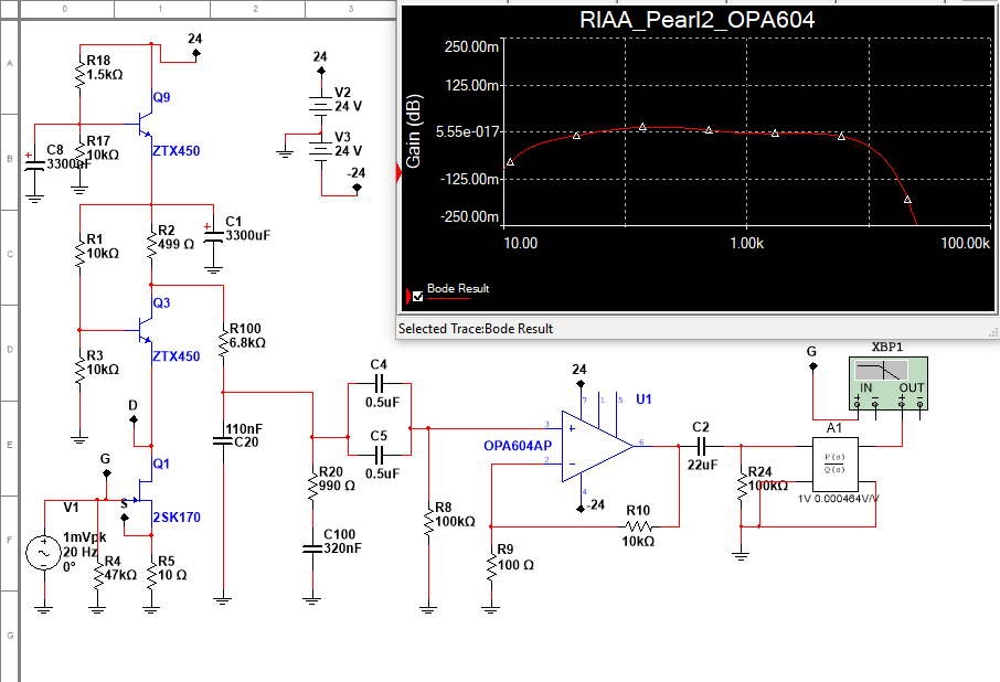

Pearl II without tears:
There isn't a better one. They are both very, no, extremely well designed, with similar circuits and design goals.
The Simplistic Folded is a bit more flexible if you want enormous gain. The Pearl is probably a tad quieter in input noise because if the paralleled devices.
The designers have their signature PSUs, Nick uses shunt regs, Wayne uses mountains of capacitance.
Choosing one is akin to being in a garage full of Ferraris and and asking which one is the the most Italian sports car.
