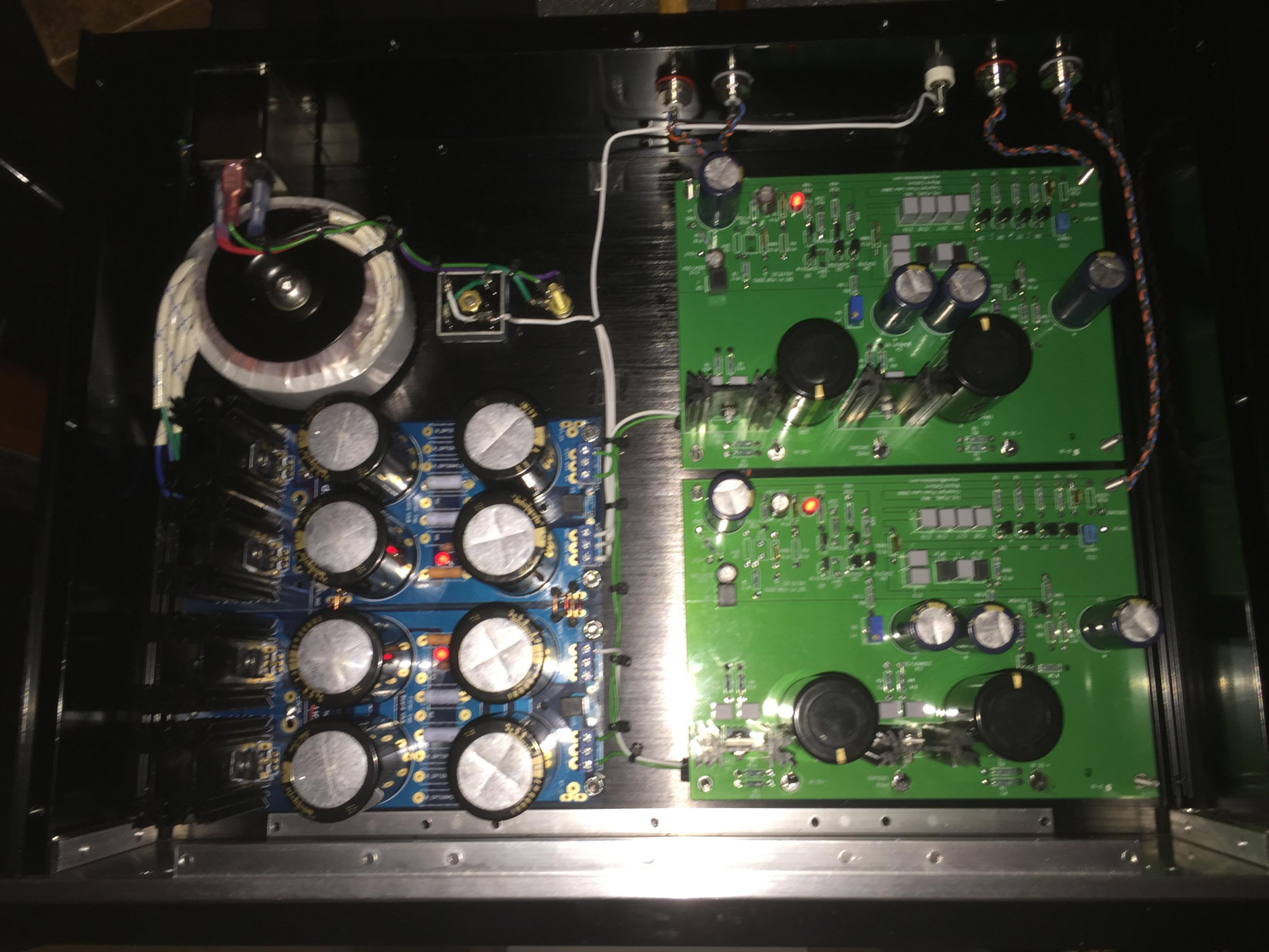

It's alive... I finished building my Pearl II tonight
I brought it up slowly with the variac and all the voltages looked pretty good.
It was hard adjusting P1 to zero but I got it down to +/- 4 to 7 mV.
Anything below that and the pot is just too twitchy.
The smallest adjustment I can make moves the voltage 5 mV or more.
All the supply voltages look good but there are a couple of other voltages that are slightly off.
When tuned for ~ 0V the voltage across R6 is 1.548 on the right channel and 1.658 on the left channel.
The voltage at the R8, R10, Q3 node was L = 7.427 and R = 7.488
At the R9, Q3 node was L=6.788 and R = 6.852
Thoughts, comments, and suggestions welcome.
After checking voltages and seeing no oscillations on the outputs (with inputs shorted) I hooked it up in the system and listened to some music.
I think I have more than enough (perhaps too much ?) gain for the Ortofon 2M Black.
It is way louder (about 6 dB) when I switch inputs back a forth between the same song on the Oppo versus the Pearl II
I don't think I hear any obvious distortion but have only listened to a few albums.
I'll give some more observations once I have let it run for a while and get some better impressions but so far it is sounds pretty darned good.

One lousy interior picture from the phone for now but I'll get my camera out in the morning and a couple better ones when I have more light.
From the outside it looks pretty good in the rack (top left) and matches the rest of the Pass gear pretty well - which was one of my goals.

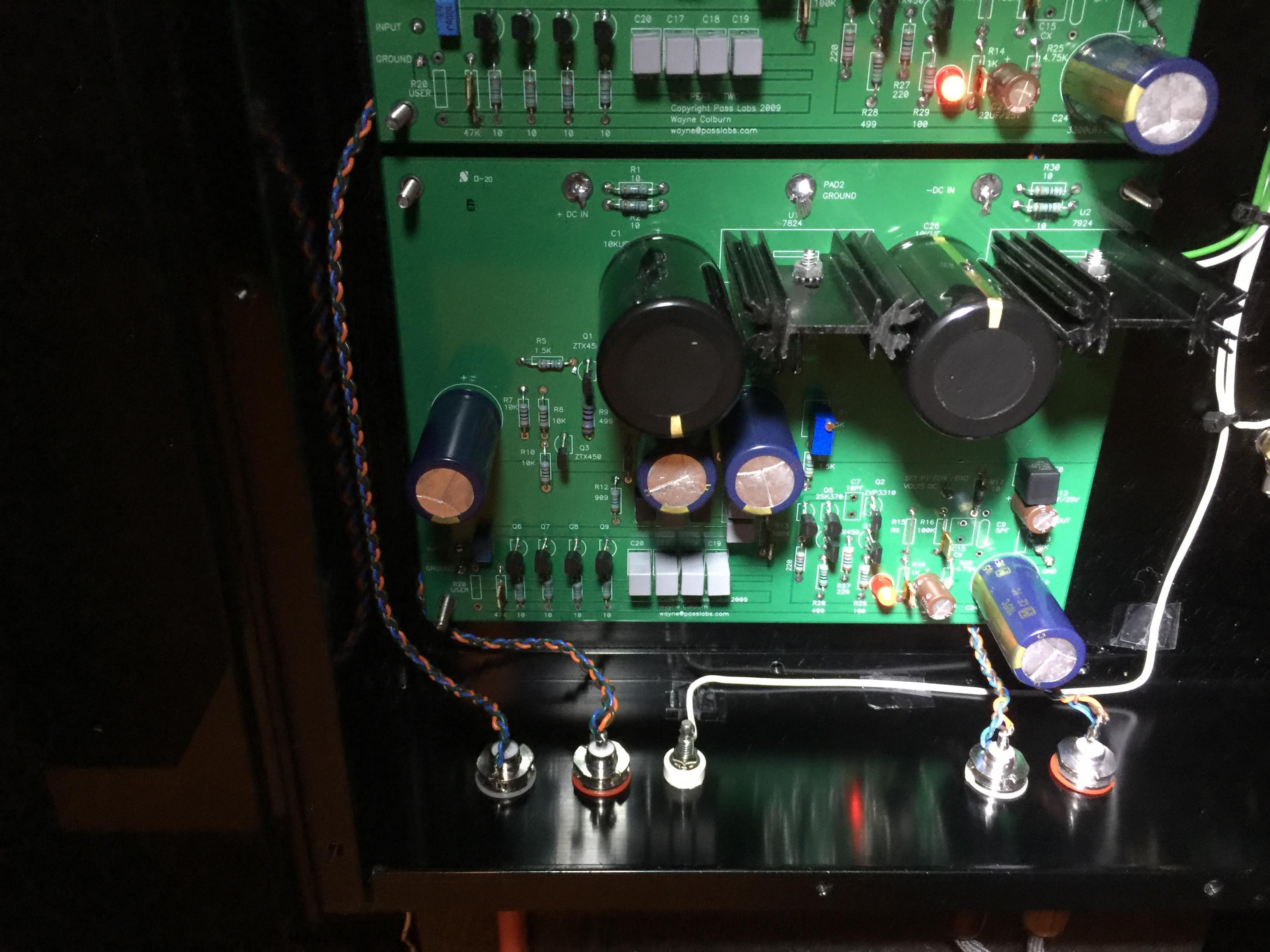

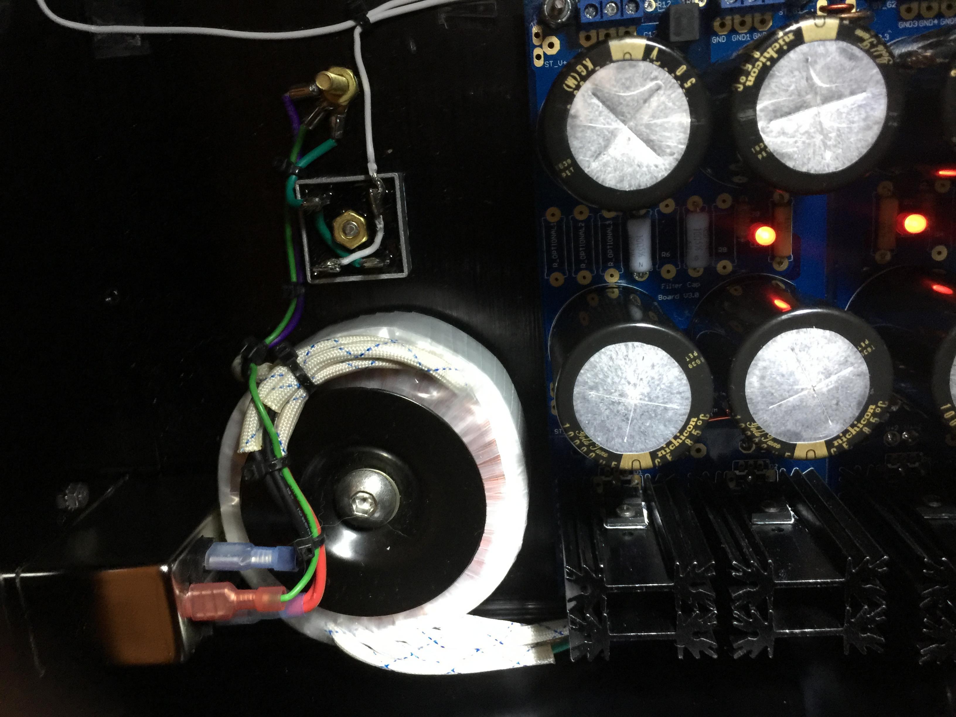

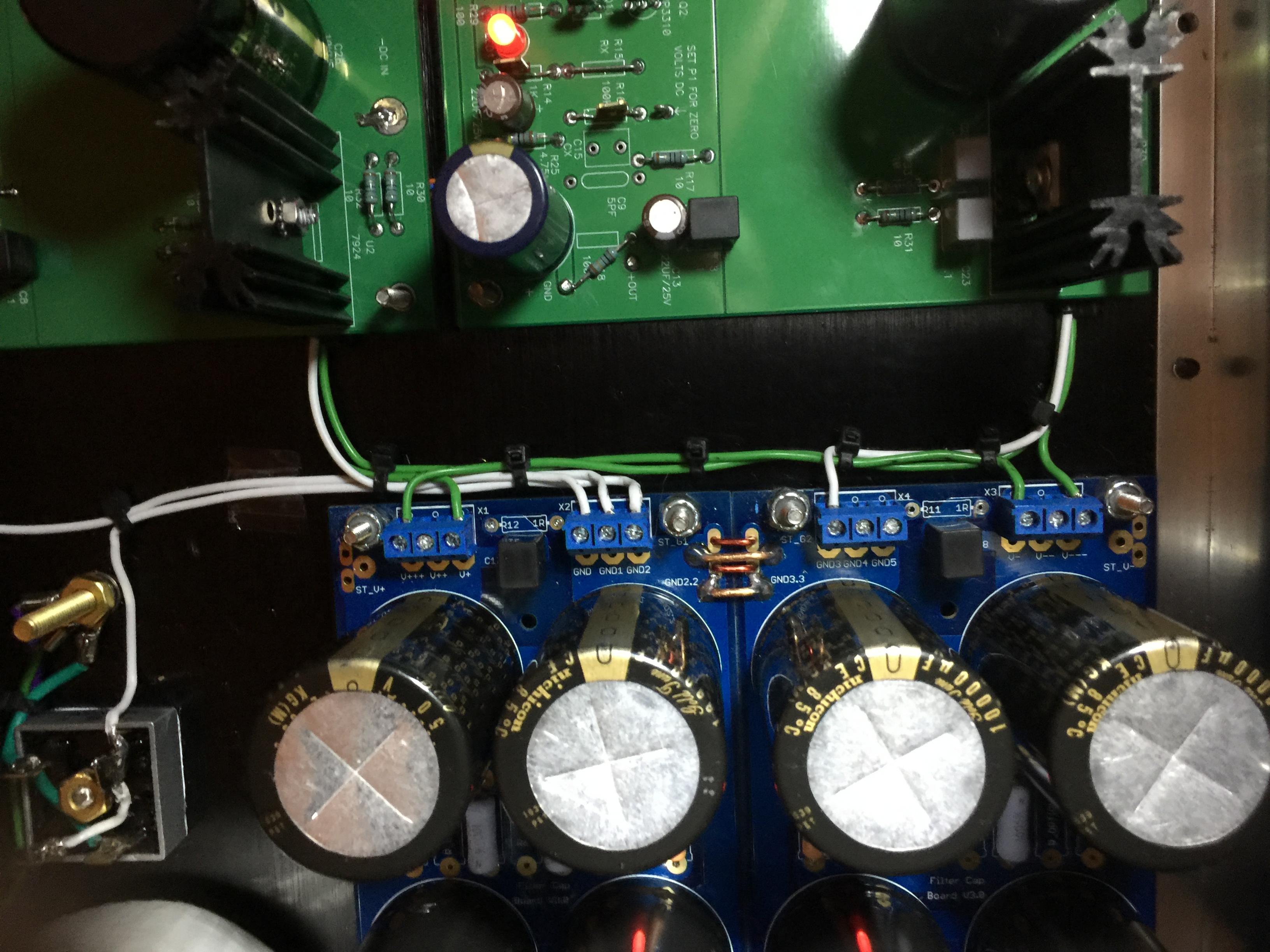

Reducing Hum
RussellC:
There are a couple of techniques and perhaps a couple "tricks" I used to reduce hum.
The techniques are:
- Use an IEC style AC input jack with integral noise filter. Inside the Pearl enclosure it has a grounded metal housing not plastic. Looking at pictures online this is what Pass does on all their preamps.
- Use a shielded toridal transformer (I used an Antek 5022) and keep it far away from the Pearl inputs
- Keep all AC wiring absolutely as short as possible.
- Route all AC wiring as far away as possible from the Pearl inputs. I also tried to keep DC wiring away from inputs too (always route it away from the inputs on the way to the caps)
- Keep Pearl input wires as short as possible.
- Route all wiring (AC, DC and signal) as close as possible to chassis panels. I even taped the wires down in a couple places.
- Keep wires very close together along their entire length (I used a bunch of small zip ties)
- Where wires need to cross, do it at 90 degree angles and avoid it wherever possible.
- Wire the tonearm ground terminal to the "common" on the Universal PSU board (the common between the positive and negative cap banks (white wires).
-- I followed 6L6 suggestion to use jumpers in all the terminals between the common terminals on pos and neg UPSU boards
- The UPSU boards might also help because all cap wiring is on PCB and very close to chassis case (as opposed to point-to-point wired with the caps pointing up)
- Use a single star ground point for chassis, AC mains ground (Protective Earth), and the "ground-to-common" diode bridge.
One "trick" was to use "quad wire" from the input and output jacks to the Pearl PCB.
A buddy turned me on to it and he used it inside large power inverters, e.g. 500 kW stuff, which is a very electrically noisy environment.
(Imagine a 500 kW Class D amplifier switching 1200V IGBTs at a few kHz.)
The quad wire is designed specifically for noise immunity and the construction helps cancel both electric and magnetic fields.
It has four conductors which are tightly woven together with one pair woven left and right (blue/green) and the other pair woven through the first pair at a 90 degree angle (Orange/Brown).
This stuff I used was factory made but it would be easy to DIY with a little patience.
A more difficult trick is that I have a dedicated 50 Amp circuit with a separate isolated ground that runs directly from my main service panel to a sub-panel right behind the equipment rack.
The sub-panel also has an isolated ground bus in addition to the normal ground wire used to ground the sub-panel enclosure.
I use dedicated circuit breakers and very short runs, i.e. < 1 meter, to each of four duplex outlets.
I used the Hubble isolated ground outlets (the orange ones) and the ground terminal on each outlet is wired back to the isolated ground bus in the sub-panel and from there back to the main service panel on a separate dedicated ground conductor.
While it may seem like a lot of work, it was cheaper than most audio projects and only took a couple of weekends to install.
I'm not sure this last part contributes the the lack of hum in the Pearl but it sure couldn't hurt
RussellC:
The techniques are:
