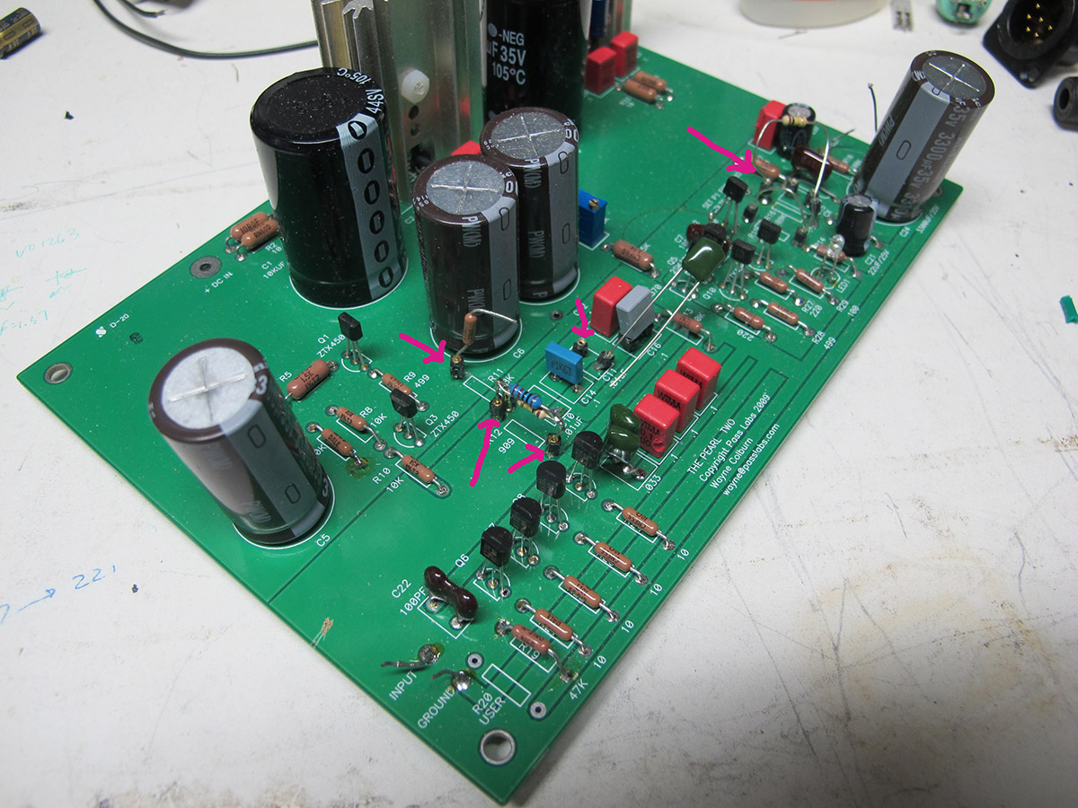

Thanks Eric!
Yes, I used a few TX2575's in a couple places.
Most of the resistors are Takman metal films with one stray Shinkoh at R9.
R9 was only really because the closest Takman I could get was 510R
JackinNJ made some posts about sources of noise and 6L6 also mentioned that R7, 8 and 10 might be a good place for better resistors as well.
I'm also thinking about the Cap in series with R14.
One thing to note regarding hum is that I have a high output MM (Ortofon 2M black) and I do start hearing some hum at about 6 dB higher level than I would ever listen. Switching to a low output MC might make the hum an audible issue. I plan to add MuMetal shielding of the transformer and AC cabling at some point and report the differences I hear / can measure.
For now I'm going to enjoy the Pearl as is for a while and then perhaps make some "adjustments". I have a couple of other projects in process which I promised my wife I would finish. Next up is finishing the soapstone plinth for the TD-124 and then there is a SP-10 MkII sitting there in need of some TLC and then ...

Hum update
I tried a couple of things this morning to try to figure out the source of the small amount of hum I do hear. While the hum is not an issue for me at all, I thought the following qualitative results might be informative to others here.
1) Is it the transformer and diode bridge ? Test: turn off the power switch and see if there is any observable change while running from caps only, i.e. transformer and diode bridge is not on so cant be source of hum. Note: Before doing this turn the volume down and make sure you don't have any loud switching transients (I did not). Result: No observable change in level of hum when opening AC switch (with Preamp at level 65)
2) Is it the motor on the turntable ? The table is is about 10" to the right of the Pearl inputs. Test: Turn off the turntable and see if there is any change. Result: no observable change in level of hum
3) Is it the power supply of the XP-20 preamp ? The power supply is about 12" below the Pearl and below the XP-20 main unit. Test: Lift Pearl up by about 12" (limit of the cables I had) Result: no observable change in level of hum.
4) Is it the Phono cables / tonearm ? Test: Listen to hum with preamp at level 65 then mute preamp, unplug phono cables, un-mute preamp (level 65) and listen to hum. WARNING: THIS WILL PRODUCE A VERY LOUD POP if you do not mute the preamp or leave the volume up when you unplug phono cables.
Result: The hum disappeared completely. I then increased preamp volume to level 83 (max) and the only observable noise was a very slight white noise hiss.😀

If you are using a high gain (5mV) MM cartridge like I did, you'll need to use 20R resistors on Q6 through Q9 to prevent distortion in the first gain stage.
The distortion of the first gain stage is about 1/10th the total distortion of the Pearl, so most of the THD% would appear to occur in the second gain stage.
Input Signal THD% First Stage (Measured)
1mV 0.011%
5mV 0.026%
10mV 0.052%
20mV 0.11%
According to the PASSDIY article, THD% of the Pearl is ~0.26% with 5mV input. When you do your RMS-ing, the THD% of the first stage is almost irrelevant.

Adjusting the Pearl gain for a 2M Black
A quick update on the gain game:
I reduced the second stage gain by going to 50k at R15.
I had a second pair of 100k TX2575's so I soldered them into the location for C15 which is not used in my build.
This puts which puts a second 100k resistor in in parallel with the 100k at R15 for 50k.
I just replayed Joni Michell's "Court and Spark" - a track which created some audible distortion in one passage this morning (at 100k) and tonight at 50k there was no issue at all.
Ok, while admittedly the following may just me wanting to hear a difference, overall I think it sounds more relaxed and natural with 50k at R15 than with 100k. I was not attached to the outcome either way (it's a resistor and 5 minutes to solder it in after all) so I think this is real.
For folks with high output (5 mV) MM cartridges like the the 2M black, IMHO, you might want to try building / trying 50k or perhaps even a bit lower at R15.
In my system there is still PLENTY of gain to listen at ridiculously loud levels so it seems to be a reasonable trade off to reduce the second stage gain and along with it a little bit of the distortion.

The difference in noise (simulated) between 10R and 20R seems trivial, less than 0.1nV/RtHz.
In simulation, the higher Rs reduces first stage distortion by 0.013%

Jack: I think we may be talking past one another here. The issue with my Pearl is that the output level into my pre was too high, causing the "Peak" indicator to remain constantly illuminated and resulting in terrible sound quality. I don't have capability to measure THD. Whatever distortion level is or isn't present was clearly being overwhelmed by an output level that was just too high. Changing the feedback in the second gain stage to lower gain didn't solve the problem. Reducing the bias of the first gain stage did solve the problem. Now everything sounds great.
Hi Eric,
If I'm reading things correctly, I think Jack is saying his sim shows increasing
the source resistance (as you've done to avoid the front end overload) only
increases the noise minimally but at the same time lowers distortion a bit
(increase in source degeneration).
So it seems increasing the source resistance is a reasonable thing to try, if
overload from the first stage is a concern.

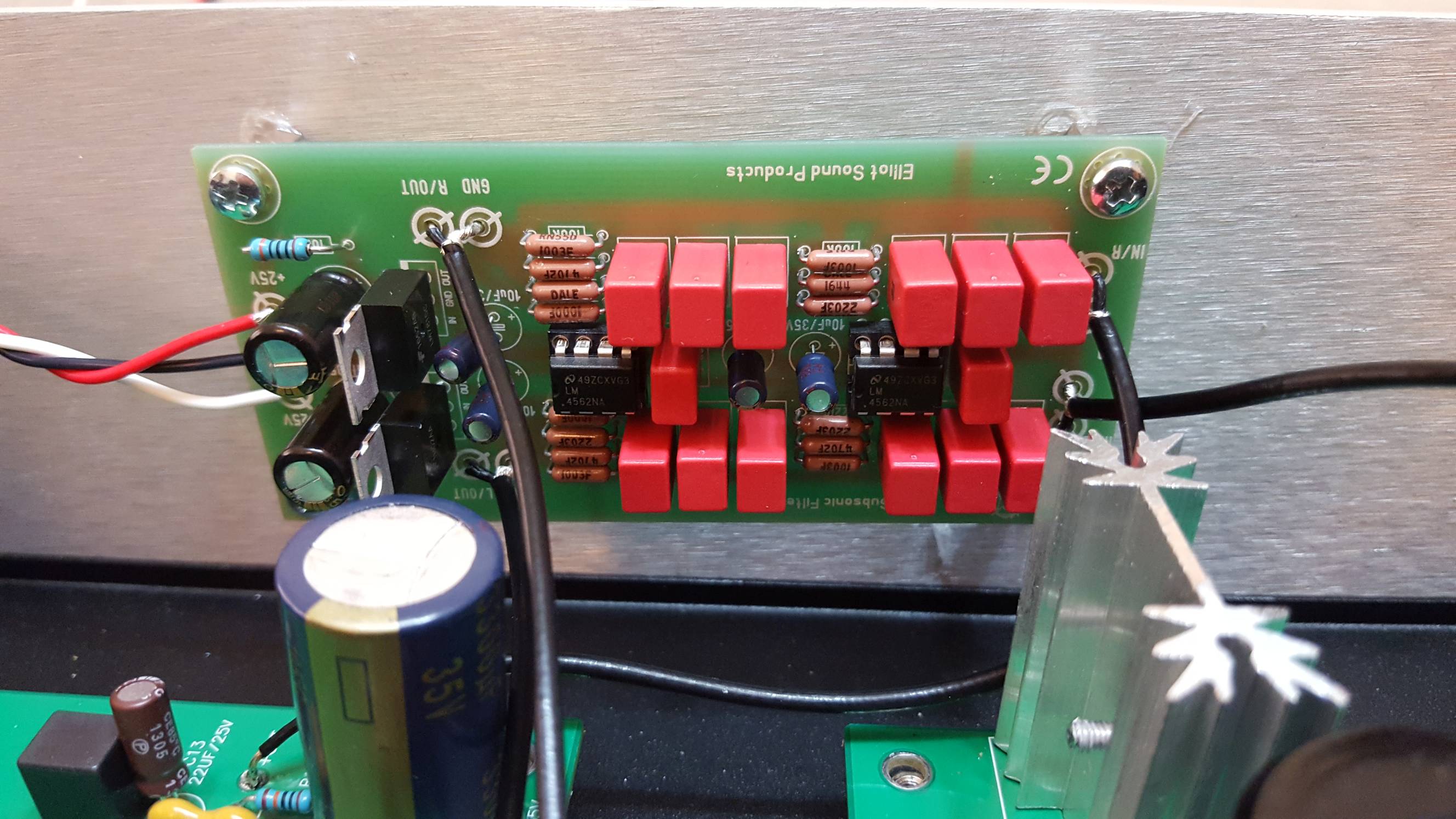

Having some issues with subsonic frequencies on my system, I decided to insert Rod Elliot subsonic filter on the output of Pearl II. When I cranked the volume on my pre-amp I've notice large cone excursion from my mid-bass. After implementation of subsonic filter, the cone excursion is gone (no more pumping).
First Stage Gain Update
As I mentioned in an earlier post I have been hearing issues due to the high gain of the Pearl II when coupled with my Orotofon 2M Black (5 mV output)
I already reduced the second stage gain by reducing R16 from 100K to 50K by adding a second 50K in parallel.
This improved things significantly but I was still hearing signs of overload.
Last night I replaced the 10R resistors in the first stage (R21-R24) with 20R.
This change made another clearly audible improvement.
Some of the things I heard:
Reduction in distortion - Heard mainly in male and female voices.
Improvement in dynamics - Heard mainly in drums, bass and some piano chords
More cohesiveness in complex passages, i.e. Instruments stay localized instead of becoming homogenized.
Wider and deeper imaging across the board.
Rhythmic drive was also better which increased the toe waggling factor.
This was a very significant improvement, to the point that my wife commented on it after hearing it from the other room.
She later came in and listened to a couple of tracks and said it sounded much better.
While she does not have an "audiophile approved" vocabulary, she does have good ears.
Clearer and more lifelike are general purpose high praise terms from her but more importantly she started singing along and danced her way out of the room.
Previous descriptions during loud passages were "hurts my ears", "gritty", "electronicy" and "jumbly"
So, with all the YMMV disclaimers...
I think the Pearl II is a great phono stage but, as in all other things, it needs to be tailored to match the other components in order to to sound it's best.
A per-plan-build seems ideal for low to medium output cartridges but for high output MM's some alterations may be in order.
If you have a high output MM cartridge I would consider 20R in the first stage and 50k (or perhaps even lower) in the second stage.
