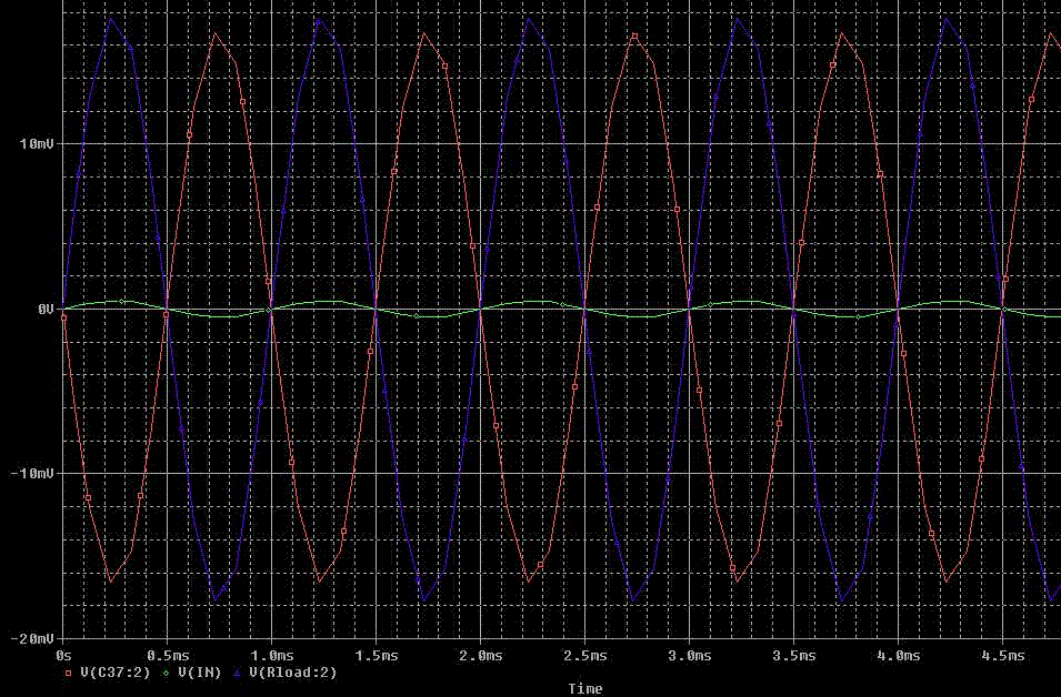

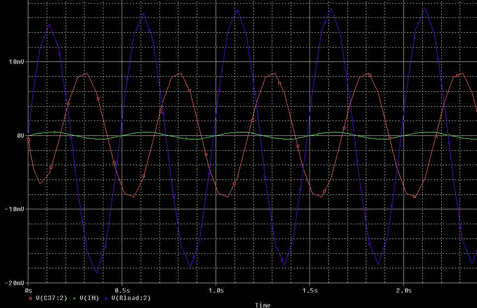

I did some simulations of the described circuit.
I used 10 uF for c37 and c19. I did two simulations, one for an input signal of 0,5 mV and 1KHz and the second 2 Hz.

Hi Hermanv,
After reviewing the results of these simulations I came to the conclusion that I was not specially brilliant that day !
When I did these simulations I made two big mistakes:
The first one I was only concentrating in the fact that the signal was down when using 10 uF and not when using bigger caps, instead of thinking whether this reduction of around 6 dB could be acceptable or not at 2Hz.
The second (and far more important) is that I wasn't looking to the right signal. The non inverted output (the blue one, not the red one) is in fact almost the same for both 1Khz and 2Hz.
Xavier
Xavier
Hi Xavier;
We all have those days, more often as we get to be my age.
It is desireable to have a roll-off above the record warp frequency with (two warps) this would be about 1 Hz and above the tonearm resonance frequency which varies from anywhere in the 1 to 10 Hz range.
The blue traces are all but invisible on the posts (at least on my monitor).
It seems that the circuit is working more or less as was intended, now comes the hard part, building and most importantly listening.

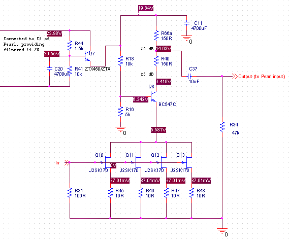

Getting rid of C37 might be possible by biasing the source of Q15 with a resistor up to the emitter of Q24 (the parallel value of the new R with R50 should still equal 56 Ohms). We also need to verify Q24 can carry the extra load.
Two things will happen, one is headroom on the drain of Q15 will be compromised I do not know by how much (I haven't simulated the design) and you will give up a roll-off corner.
It's a judgement call if this ends up better or worse for the final design.
Hi Promitheus,
I tested the circuit, but without the output buffer, and I did some tunning. The final result was very good.
After building the original circuit, my initial impression was that the circuit was too noisy.
I changed the cascode to a BC547c which, according to the datasheet had better figures. Although there was some improvement, the noise was still too high. The next thing I tried was to reduce the voltage at the drains of the jfets by using 5k instead of 10k for R16. The results were quite promising, but then the cascode was running too hot. In order to reduce Vce of the cascode, I changed the point where I was getting the supply from the Pearl. I took the lines from C8 (24.2v) instead of C15 (28.8v) from the Pearl, having then an additional filtering.
I also changed the source resistors from 22R to 10R to have a little bit more gain and less noise. I put a dip with 2 gain positions: 21dB and 27dB.
I've been testing this circuit for a while and the result is really good, and very quiet.
I attached the final MC stage that I am currently using.
Xavier
Xavier

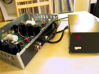

I finished my Pearl about a week ago and it sounds great. Thanks to Promitheus for boards/parts and advice. This is my first attempt on Pass diy, very good design indeed (well I guess y'all know that). With my Rega P3 (even no ground cable), it really sings.
outto
outto
That looks great!
I didnt have any problem with the Rega either.
Its very quiet and really clear sound.
