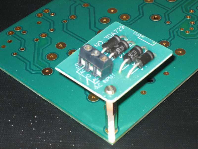

That sounds absolutely nice, Promitheus - I'll take three sets in pre order - no matter the look ! I use small standoffs with 3mm internal threading, so I am playing with the idea of using those to stack on top of each other, so I can mount the MC input board directly on top of the MM input stage.

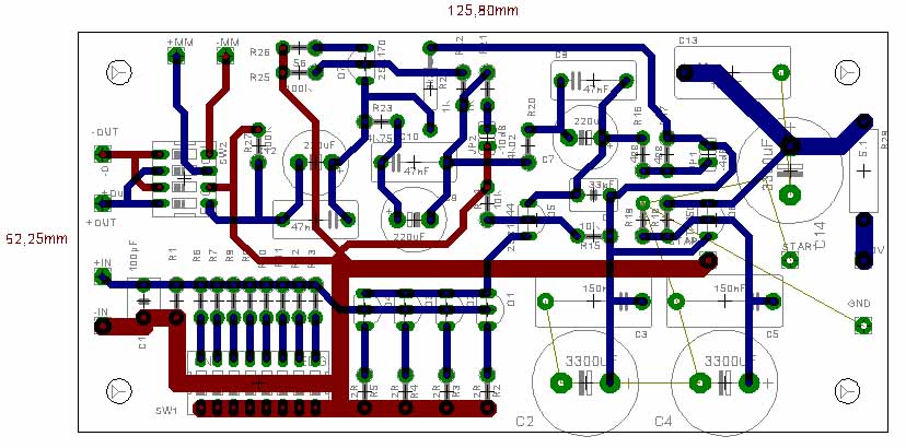

I am working on the board and almost have the Layout done.
I am still trying to find a solution on how to mount the MC Stage ontop of the Pearl.
What did you have in mind?
It wil also be alsmot as tall as the Pearl itself because it has 3 same 3300uF capacitors like on the Pearl.
I used the circuit from the Aleph Ono with Gain selection and buffer at the output.
See attachment below.

Hello Ilias - I think it looks good, although I dont have very much experience in judging PCB layout - nice with groundplane covering everything... Also nice with the "mouse piano" for adjusting input impedance....
About the stand off problem, I have assembled a small mock up showing the idea I had using PCB standoffs stacked on top of each other. You will need about 34mm to get clear of the 3300uF caps, that seems to be the tallest part around the input stage - each standoff I use on the picture is 12mm high, thus three should do th trick - this is only to show my idea.
Cheers !
Hans
Cheers !
Hans

Well I know the MC Boards are big but I cant find another way to make them fit better.
I made the board as compact as possible.

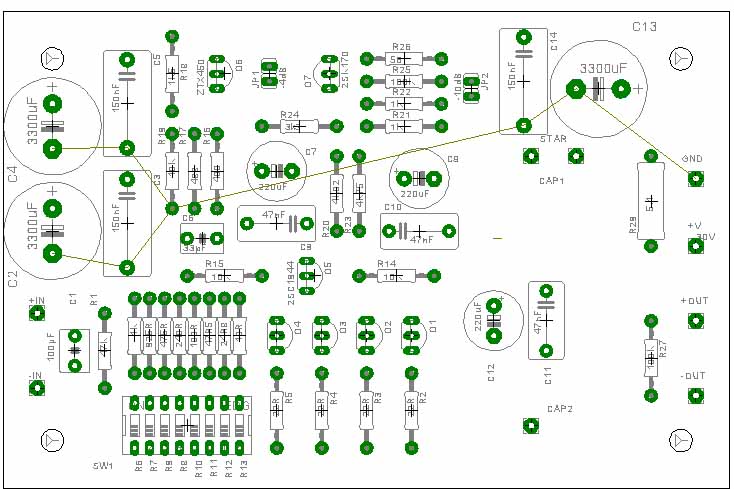

If it can be got down to about 100mm x 60 mm, it would fit above the input area of the MM board, and would be much more convenient.
Here's an edit of your component layout to show what I mean. Put all the power components at the right end of the board. Put both the input and output at the bottom left, near the input pads of the Pearl MM board.
I currently can't attempt to lay this out, so of course it may be impossible. But it's worth a try.
Also, is all that extra regulation needed? Isn't the regulated supply from the MM board enough, perhaps with just a small RC filter on the MC board? If so, you could eliminate c4, c5, r19, r18, q6, and c13.
What do you think?
What do you think?
Well theoreticaly it could be done but practicely its almost impossible.
One more reason that the board is so big is because I made space on the board for a 10uF MKP at the output instead of the 220uF in parallel with the 47nF ( thats C11 and C12). This 10uF cap is soldered to Pads Cap1 and Cap2.
If this isnt needed then the board can become smaller.
The regulation must stay because its needed for low noise levels of the MC preamp.
What do you guys think?
Well my first thought was to take 29V from R8 on the right side of the board.
If I take the caps out you have to take 28,8V from R13 and Ground from the star ground near C15.
I hope thats what you asked.
Yes just like the Aleph ONO.

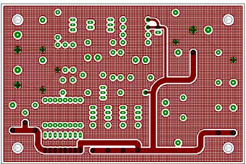

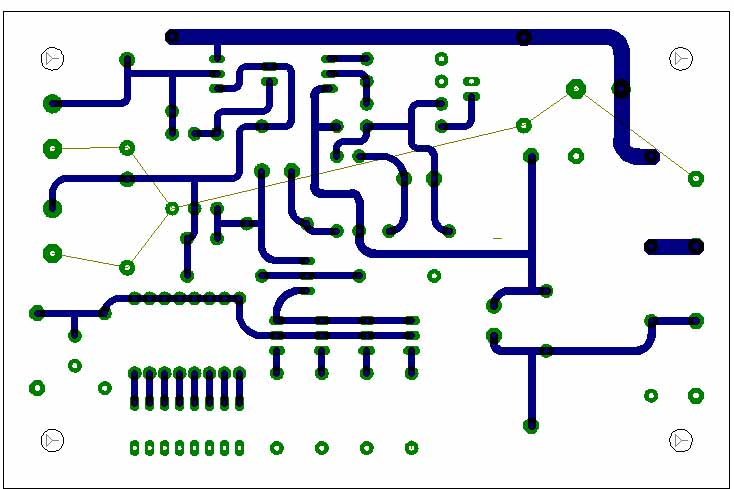

So I made a new version of the board.
It can be mounted on top of the Pearl board.
You can use the same screw in the below right corner of the Pearl board.
Then you need a hole on the Pearl board between C5 and C9.
In the other corners you cant make holes but you can use Pcbs mounts which are glued.
