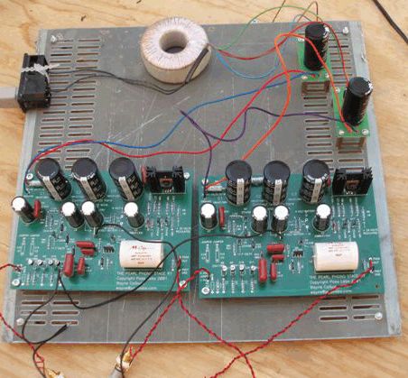

I did not exactly finish mine but I am using it without enclosure.
I am overwhelmed by the sound quality.
Thanks to Promitheus, Wayne Colburn and Pass Labs for making this possible for me.

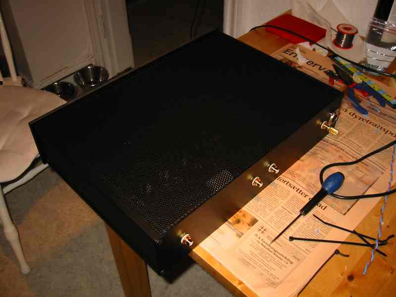

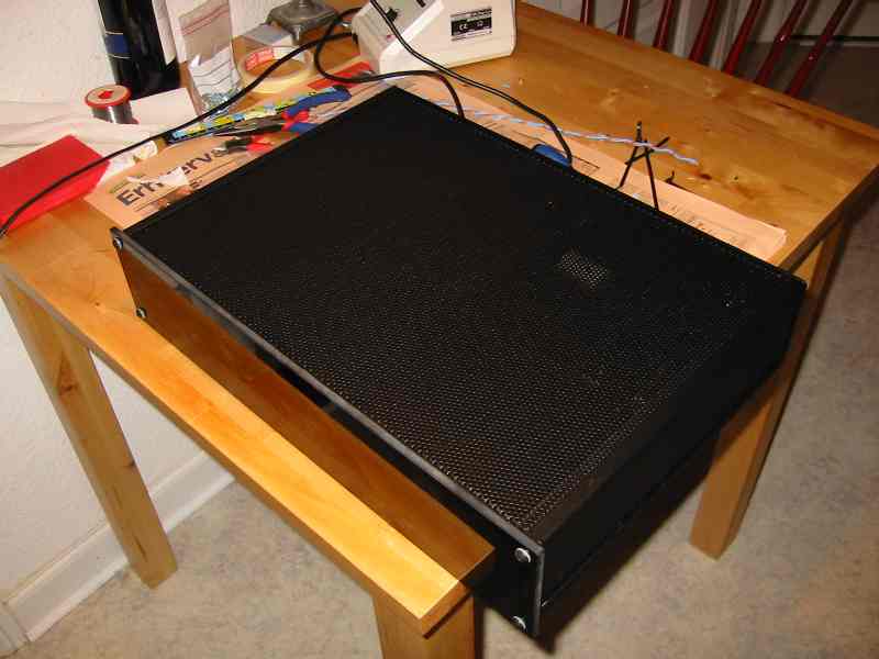

Ok, so Ill add some pics of a Pearl I have build for a good friend - the case is from Monacor, and the front plate is custom made out of dark glass. EI-core trafo and 80.000 uF in C-R-C combination is hidden in a external old housing for a B&O motor-steering device for sattelite dish.....
and finnaly the most exiting part - the inside - although it looks a lot like the rest of the pearls that promitheus have facilitated - and thanks a lot for the job Ilias !!! I would never have been able to build such a great sounding RIAA without your effort - not to mention Wayne - Thnx !!

Dark side of the glass...
Thnx Ilias !
It is real glass, but you have to have it cut by a proffessional, as it is very difficult to make holes in glass - although I have heard that it can be done with a drill for rocks, and then you make a small "pond" of moddeling clay around the hole, where you add some water, to act as a cooling, so you are drilling under water....
This glass i rather expensive, so I shaked the moneymaker a little bit, to have it done... but it looks real cool - better IRL than on the pictures ;-)

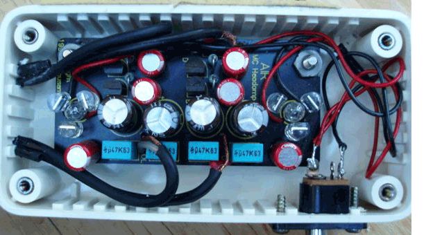

I am working on an MC front End for the Pearl.
It will be ready maybe this weekend.
It will be the same as the MC Preamp of the Aleph Ono with gain selection and inout impedance selection.
Power will be taken from the Pearl board.
Any ideas or special wishes?

It will fit to the Pearl but mounting it on the Pearl I dont know.
I will be able to fit next to it and you can take voltage from the Pearl.
I will post more info when I have the a prototype board ready.
