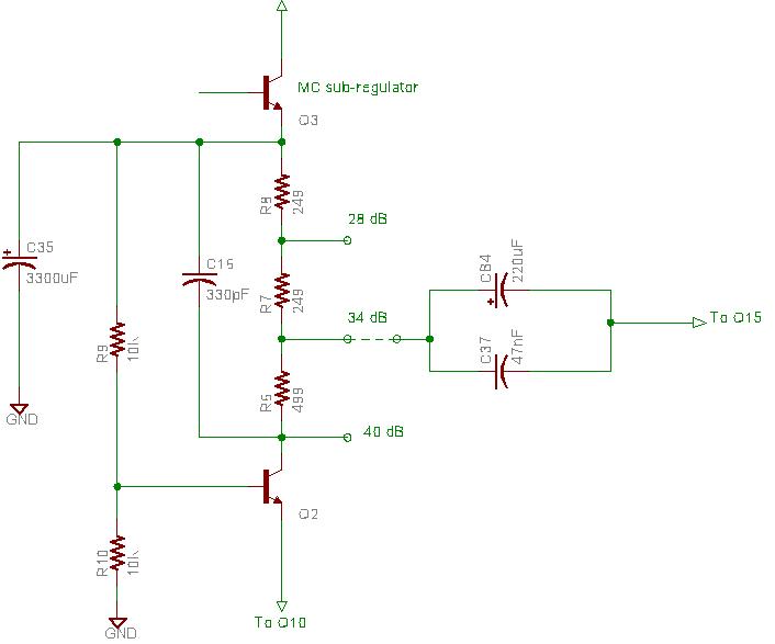

Hi Promitheus;
RE: input Z: I meant to keep the existing 100K input Z not increase it to 1 Meg or 10 Meg (a bad idea). My post was meant to point out that Zin of the second stage dropped to 1K when the gain reduction jumper was installed.
As to who designed it, its kind of irrelevant, I imagine even Wayne Colburn occasionally updates or improves his own designs. I just noticed that the way it was done was strange. If the circuit sounds as good as you think, some characteristic(s) will undergo a significant change as the gain jumpers are added and removed.
I also stand by my statement that a controlled corner frequency that doesn't change with gain setting is the better choice.

I've attached a partial schematic of the solution I had in mind. This has not been built or simulated but illustrates the idea. It is straightforward and should work OK.
With this technique several gain choices are easy to implemet and doesn't change the load on C37.
Sorry, I just noticed I didn't do a good job on lining up the reference designators got some right and others not.
Q2 equals Q14
Q3 equals Q24
R5 equals R40
R7 equals R66
and R8 is new.
I think you'll get the idea.

I think that's it's both safe and a good idea.
To remove turntable warp signals and tone arm resonance most people use a 4 to 6 Hz corner frequency. Opinions may differ, (I've seen 2 to 11 Hz for example).
So if the input Z to the next stage is about 11K (R51 + R80 + R41 plus a Q15 collector source Z of guessing 1.65K) then a 2.78 uF would have a 3 dB corner of 5 Hz. So either a 2.7 or 3.3 uF should be about right.
Since the original design used 220uF it probably makes sense to err on the large side maybe even a 4.7uF. The Z of the gain setting stack is so low that it has little effect of the capacitor size choice.
Still a good quality 4.7 uF film capacitor is physically large and will set you back anywhere from $1 to $100 each! (Is this a great hobby or what?)
C19 should probably stay much larger than C37. Since it provides negative feedback, too small a C will increase the gain below the corner frequency so probably 5 to 10 times C37 is a good idea. It can be a lower quality but I can't really say if an electrolytic is good enough. If the original desgn was known for good sound then an electrolytic is probably OK in this spot.

If I'm not wrong, the gain of the first stage (Q10, Q11, Q12, Q13 fets and the cascode Q14) is the following:
4 * (R66+R40)/(Rs + 1/gm)
where 4 is the number of fets, Rs is the resistance at the source (22R) and gm the transconductance of the fet (22 ms). The gain is then
4* (499+499)/(22+45,45)=59,58 which is about 35dB
Then we have negative gain with R41,R80 and R49, and then Q15 increases again the gain.
I don't think nobody will require more than 30dB. This is the reason I don't see the need of Q15 and additional caps unless there is something I'm missing.

well the resistors there attenuate no more than -0.5 dB.
So I think that Q15 is only a buffer.
How can calculate the gain of Q15 with the feedback there.
You are right promitheus, the resistors only attenuate about -0,4dB and Q15 is only a buffer. The only purpose I see for this buffer is to invert the phase (that was already inverted at the previous stage).
Correct me if I'm wrong, but I believe the gain of Q15 should be (R41+R80)/R61 = 0,81 this means -1,81 dB
So the overal gain of the MC Ono stage is about 33dB
