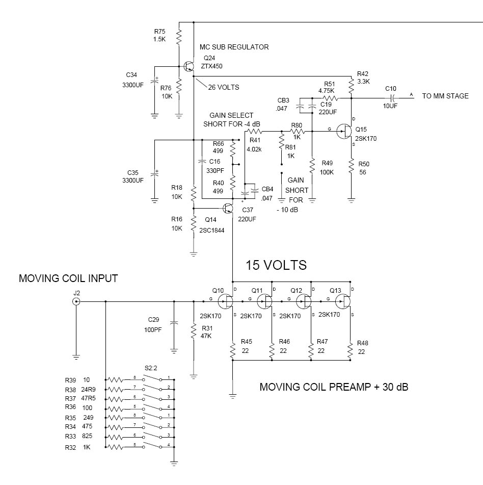

Just to get things started I made a photo of the MC Preamp part.
here it is.
It contains the MC Sub Regulator and it will be powered from the Pearls +29 Volts.
Do you think it will work OK?
The capacitors I refered to in the previous post are C37, CB4, C19 and CB3. The signal goes through these so they should be of very good quality.
What do you think is the best solution here?
here it is.

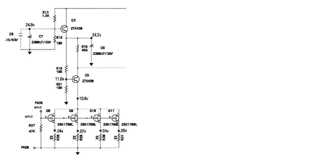

When comparing the Ono MC part with the input stage of the Pearl (attached file), the main difference is Q15.
I know this might seem a stupid question, but if I'm not wrong both stages have similar voltage gain, so what is the purpose of Q15 in the Ono?
Another diference I noticed is the .15 uF (C6 in pearl) bypassing C7 3300uF (C35 in Ono). Do you think it would be a good idea to leave space for this cap?
Regarding C19 and C37, how about BG NX's 220uF? Is 6.3V enough?

Promitheus:
I was just browsing the site and noticed your moving coil adapter. I have a couple of comments that relate to the capacitors.
The 10 dB gain reduction technique you use changes the corner frequency of C37 by about a 100 to 1 and the corner frequency of C17 by about 4 to 1 both could be dangerous for stability. (Don't you want controlled turn over somewhere around 4-6 Hz?)
If you add one more resistor in the collector of Q14 as a stack, you could have several gains without that big change in turn over frequency. You just select a gain tap thats right, perhaps 3 taps in all (5 or 6 dB steps?)
By keeping the input Z of the Q15 buffer high and constant you could lower the total capacitance by almost a hundred to 1 allowing the use of known good metal and film capacitors (i.e. tin and polypropolyne) while keeping capacitor costs merely sky high instead of insane. This scheme also keeps the corner frequencies independent of gain selection.
I just don't like electrolytics in series with audio signals, films are better IMHO.

xavier1000
I have noticed that and it would be simpler to use the same circuit as the Pearl.
First I like it better.
Second you dont have to use that 220uF Cap in series with the signal.
Thats what I dont like about the XONO.
I think the input circuit of the Pearl would work with a 10uF Cap coupling MC and MM parts. 10uF of the same quality as the one in the Pearl.
The problem is how do we make the Gain changes.
If you check the ONO Circuit you can see that the -4dB change is made with Q14 which is a 2sc1844.
The PEarl has a ZTX450.
Which one is better for the MC? Is the 2sc1844 a low noise type or something?
Why does the ONO MC Circuit have +30dB with 499+499= 998 Ohm Load and the Pearl +29dB with only 499 Ohms.
If you short the one resistor in the Ono and have only 499 Ohm Load you go down to +26dB.
The input is no problem. I just use dip switches there to set the input impendance.
Is the 100pF cap there universal enough?
I know that MC Pickups only need Resistive imp. Match, but do some also need another capacitance there?

hermanv
the circuit is not mine.
It is from Wayne Colburn from Pass Labs.
Its a reference product in the High End branch so I dont really think its unstable or has any problems what so ever.
It is one of the top 3 Phono stages in the world.
The number one tested Phono stage costs 10 time more.
Thats a very good idea. I really like it.
but do we need this buffer at all?
And what happens to the noise level when we make the input Z of the buffer from 100K to 10M.
If Wayne Colburn could help here it would be cool.
